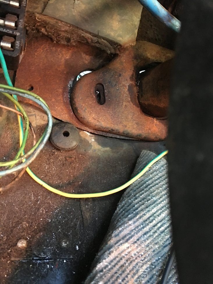

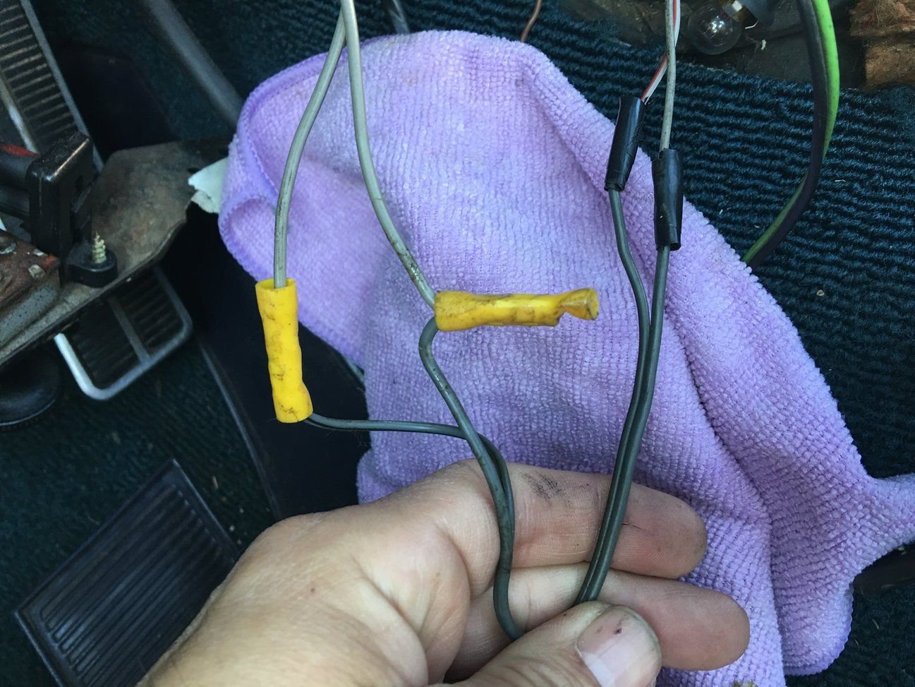

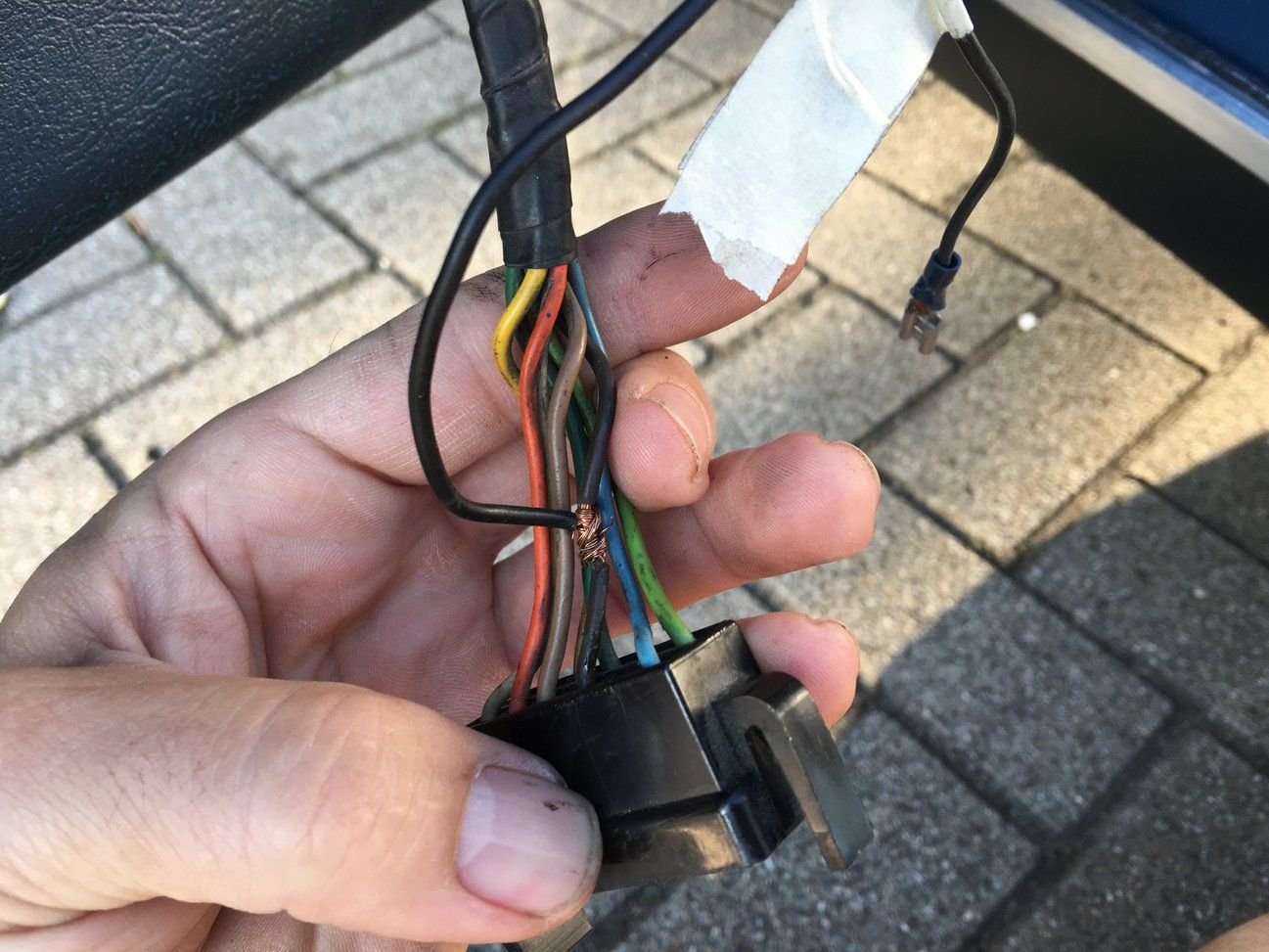

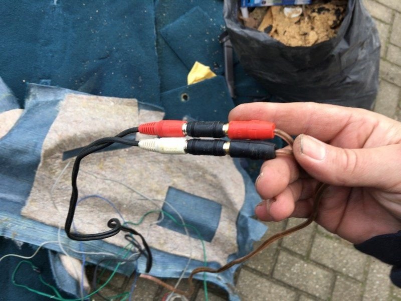

Some Bubba I had to clean up
Bubba spliced this wire...

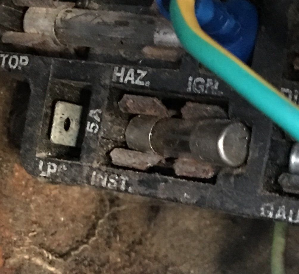

Because he could figure out why he wasn't getting power from the fuse box to the instrument lights... with the wrong fuse, that wouldn't fully seat
No words for this here... radio wiring
Sooo... he lost (!!!) the bracket and didn't bother bolting down the steering column ?

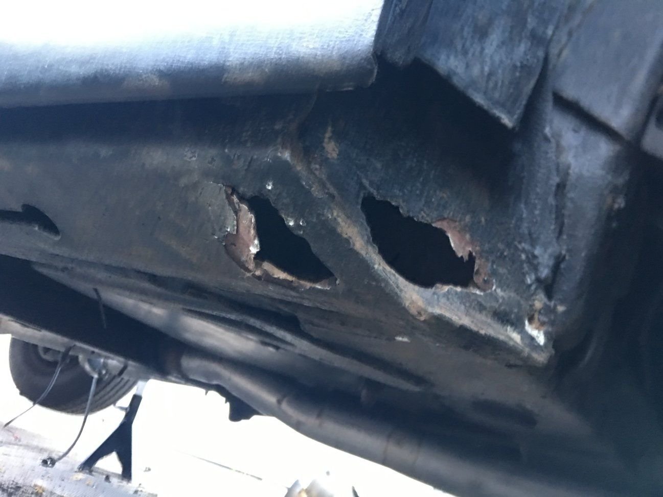

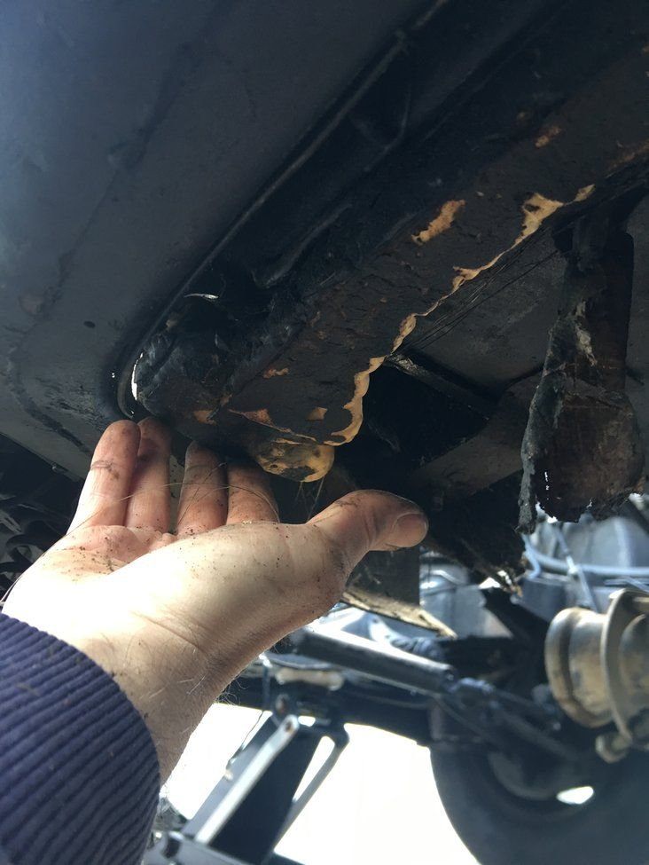

Painted expanding foam. I was worried at first that it might be covering up rust. No, it just is...
Here Bubba got sneaky and covered some rust holes with body filler.

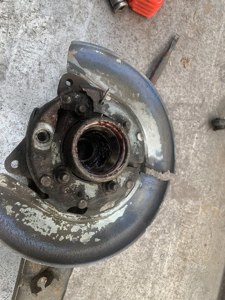

Oops, forgot the dust shield ? Hold my beer !
