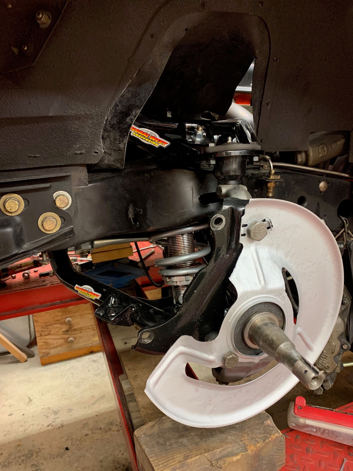

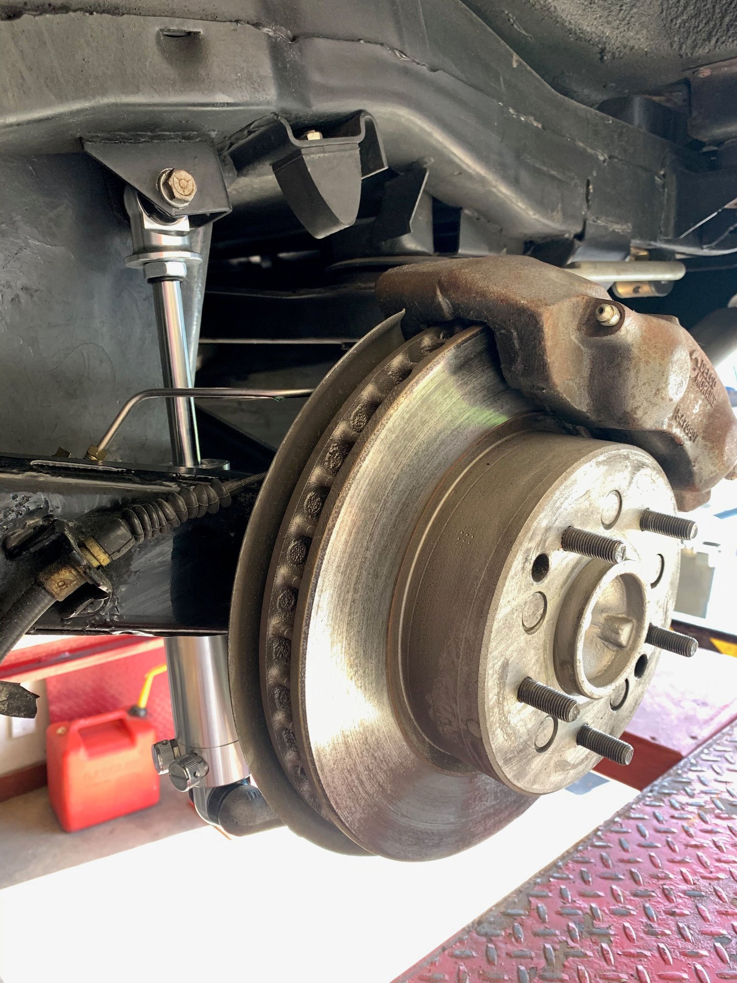

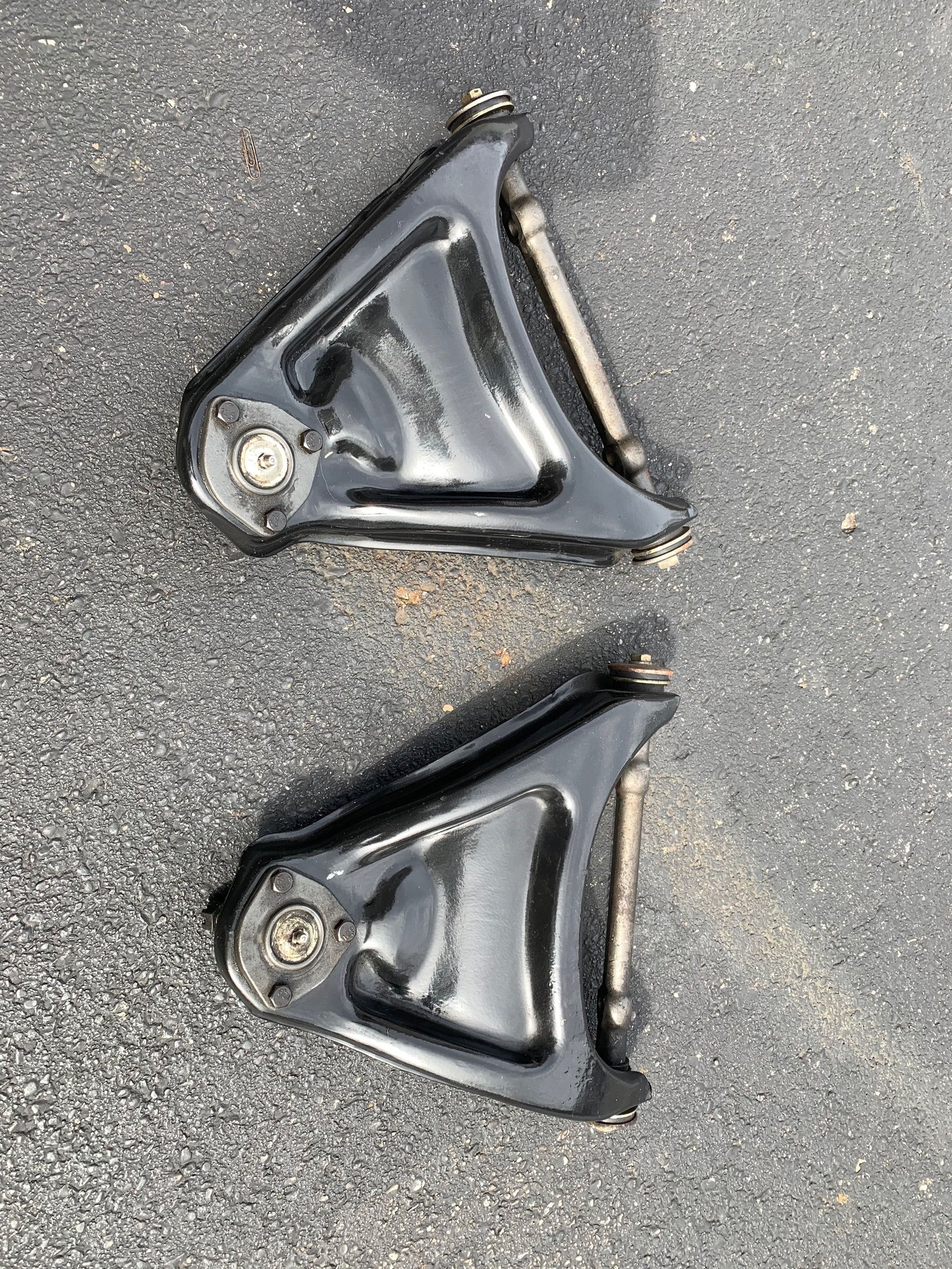

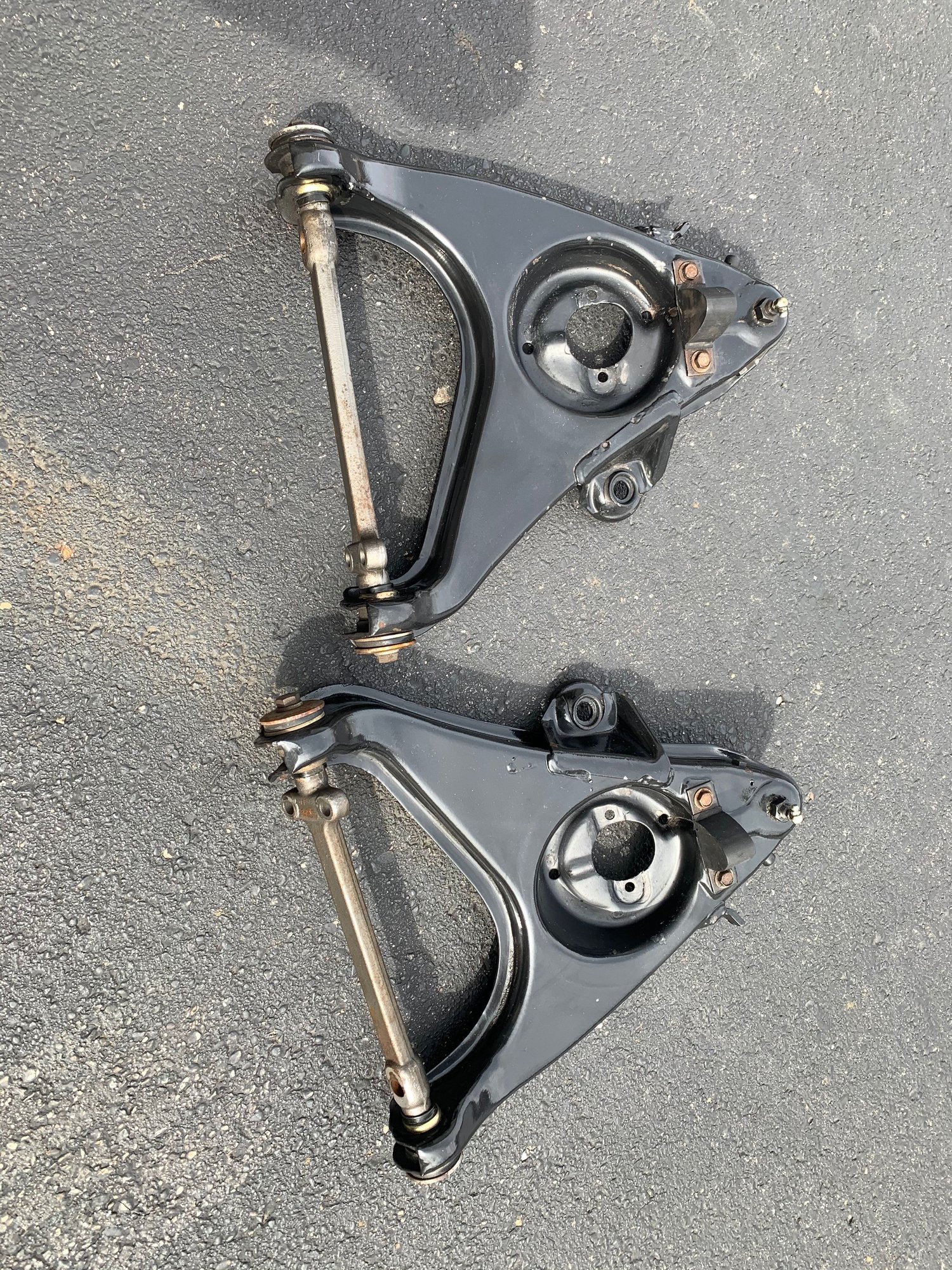

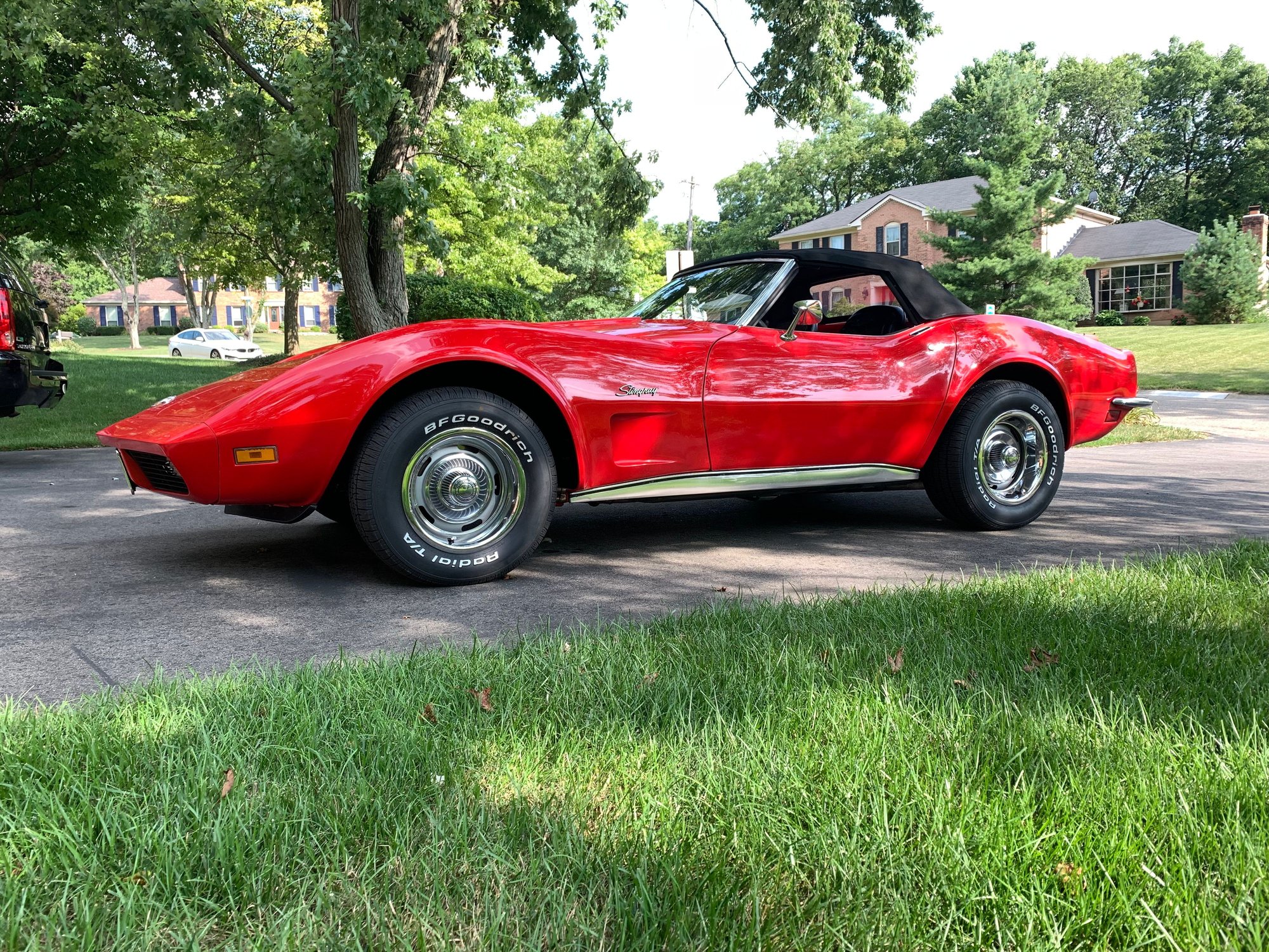

I just went though re-doing my front end after about 18 years since I did a complete frame off restoration of my 73. I did it because the car always sat high and I finally decided to get it where I wanted it. I started out thinking I would use my stock A Arms and just add Viking Coil Overs with dual adjustable shocks. In reading instructions they recommend you have at least 3/16" thick metal in the shock mount area. Stock arms were about .130" at best including paint, so I decided to go the tubular A Arm route. After a lot of reading and searching, I bought Global West Tubual A Arms, both upper and lower. While there are other choices, it seemed they were the ones that required the least amount of modifications and changing other items. The only modification needed was to a clearance hole in my stock fan shroud on the passenger side. If you keep your stock upper A Arm you don't need to make that change. In hindsight I think keeping the stock upper arm is something to consider if your on a budget. The advantage of the Upper Tubular A Arm is you get more Caster. I got way more Caster with the Tubular than needed. I got around 5 degrees which is more than needed, but to get less I didn't have enough Camber adjustment to reduce it. I also tried a composite rear spring which I ended up not using as it was a TRW design and made the car sit higher than my 9 leaf. I ended up having Eaton Detroit rework my old spring. I also added the Viking adjustable shocks to the rear and now the car sits and handles like I always wanted. I think you need to define what function you want first, then decide on how to do it. There are a lot of posts on this site about trying to get the right ride height. Good luck... Unk
Before
After
Before
After
Bad ***...this photo should be required for every new C3 owner........the difference is dramatic.

I reused my spindles, rotors, calipers and trailing arms. When I did the frame off many years ago, I replaced calipers with SS sleeved units, new discs, bearings, seals and had the trailing arms rebuilt by Yogi. I had also replaced all the U Joints during the frame off as well as replacing one yoke and all the seals in the pumpkin plus added adjustable strut rods (Recommended change). Since I only had about 10,000 miles on them no need to replace them. I didn't have the front and rear sway bars hooked up yet in these photos. Unk

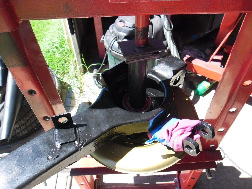

A good spindle/ bearing fit is a press on type , here I am pressing the inner bearing down the spindle to seat it up against the spacer/shims(thickness) that were calculated using a special tool . Don't know how you could do this without a proper press.That piece of pipe is machined on the end to just clear the axle so it presses on the inner race of the bearing only .

Setting up the bearings takes special tools and skill. Yogi's and others have been doing this for a long time and know what to do. They put in new bearings, seals, parking brake parts and also re-rivet the brake disc to the hub and turn it as an assembly to get the rotors true. They also powder coat the trailing arm and install new bushings. I can do a lot, but to me this was well worth the money plus you get a warranty. As for the stock A Arms, when I first did the car I bead blasted them and them painted with PPG DP-90 and clear coat. They looked like powder coating and held up very well and still look good after 18+ years. I also used DP-90 on the frame, looks like stock paint but durable and easy to repair if needed. I used poly graphite bushings on my 73 and stock rubber on the 76. Really couldn't tell much difference. I feel your pain, getting the old bushings out without damaging the A Arm is a chore. Here are pictures of the stock A Arms I took off when I put on the Tubular Arms..
