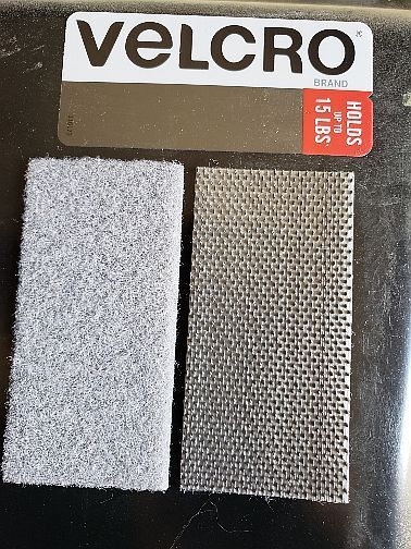

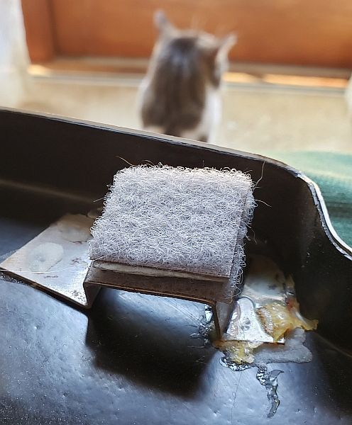

Sorry for the delay, needed to down load the pictures. The fasteners that come with the AL Koch head liners will not mate up with the factory installed fasteners. Even after having AL Knoch sending extra fasteners that came with his head liners they would not stay fastened! This I think is because the mounting stand offs do not mate level to each other and also inconstant height of the stand offs. I figure to resolve this issue using the high strength Velcro and doubling them so to make up for the needed thickness. The Velcro worked perfectly with the AL Knoch fasteners and the soft cloth side helped even out any inconsistencies on the stand offs to the head liner. I hope this helps, AL.
