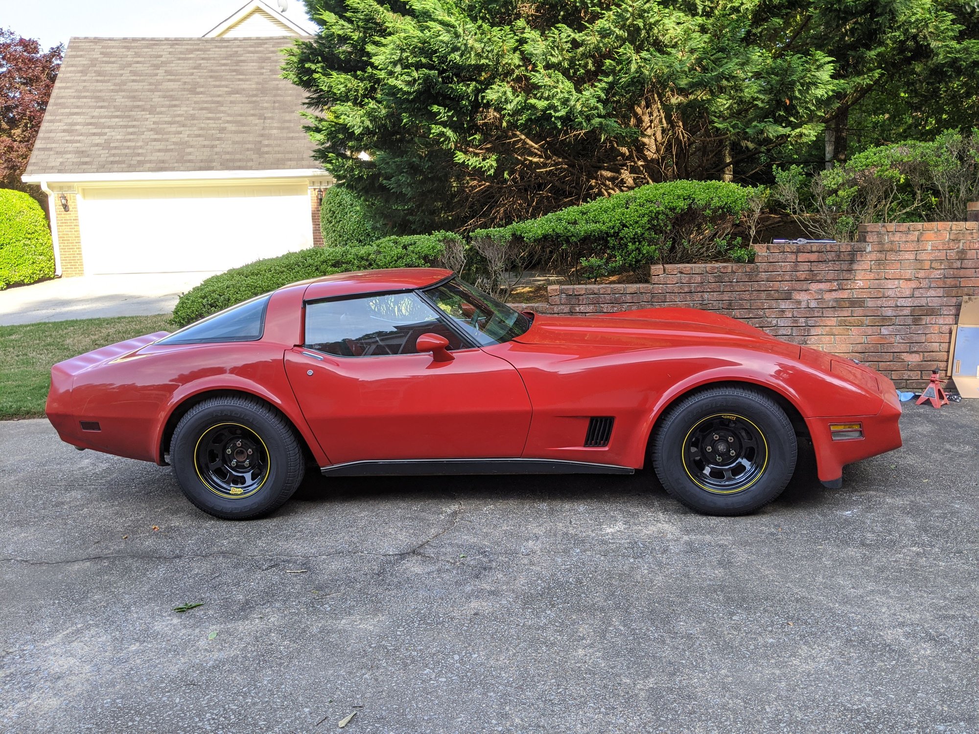

Here are pictures of the car before, and after the suspension change.
Before suspension work...
After suspension work...

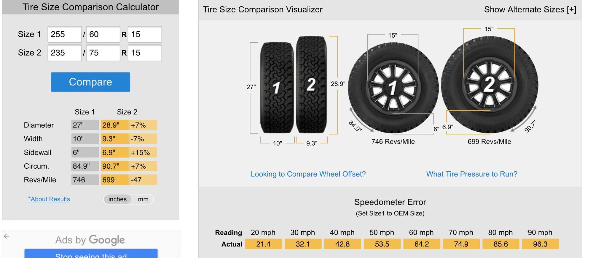

The tires on the stock rims are massive 235/75/15 wheels with a height of 28.9 inches. They rub on the inner fender on turns. I am getting a new set of wheels with correct 255/60/15 tires this afternoon, and expect the new tires to push me to drop the front end even more due to the extra fender clearance that I will have.

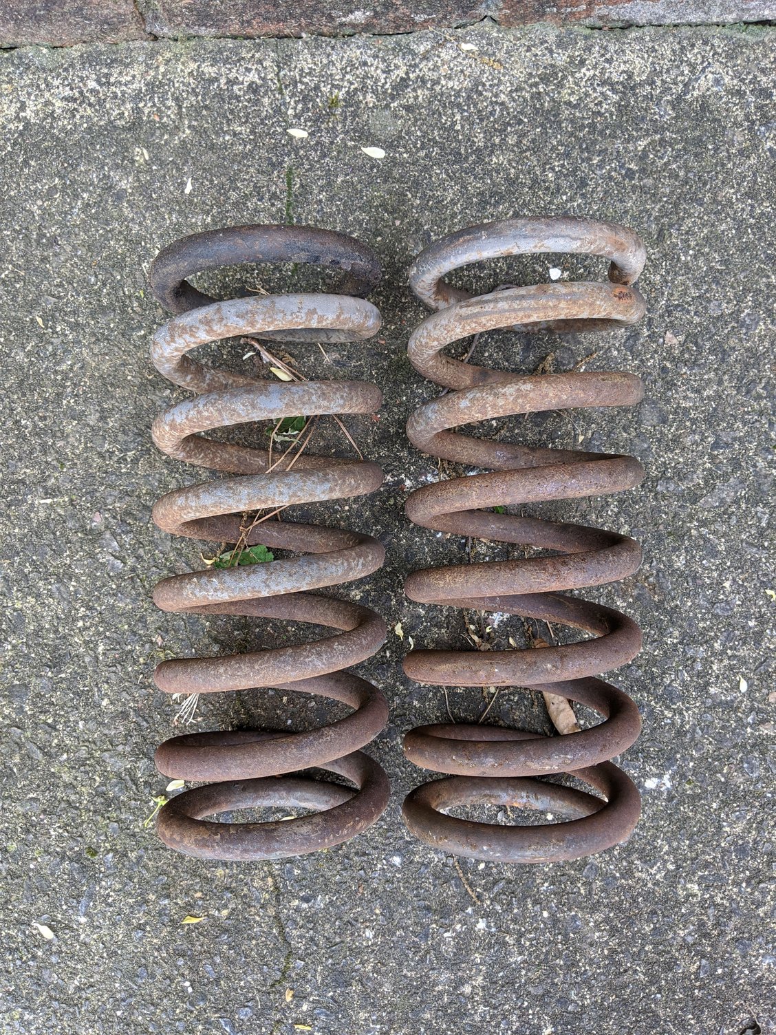

I measured the springs I removed, and they were 13 1/8" tall uninstalled, and have 8 total coils. Does this sound more like the gymkhana springs compared to stock suspension springs?

Update...
I removed the sway bar end link and shock. I then put a jack under the lower control arm and used a Harbor Freight ball joint separator (worked like a charm) to pop the lower ball joint with the castle nut still thread on to catch it when it broke loose. I was then able to pivot the spindle/rotor assembly out of the way without removing anything else. I decided to take it easy and cut a full coil off (about .75"). It is a good thing I didn't cut any more because It ended up dropping my fender lip from 28.5" to just over 27", leaving me only 2.5" clearance from the air dam to the ground. Heh, one of the reasons I got rid of my C5 was because I wanted more ground clearance...
Anyways... pictures!
Before...
...after.
