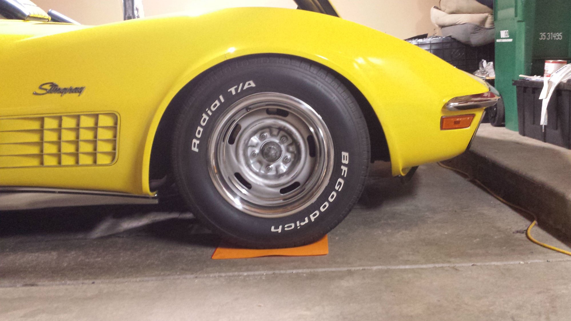

I had posted earlier about adding a spacer to my front coils to raise the height and decided that was not the way to go. I had two different sets of spring in the front, first set raised it too high, next pair too low. It was suggested to clip the high ones but unfortunately I no longer have them and I did not save the specs/info on the"too low" springs in there now. I would like the front raised approximately 1 to 1.5 inches from where it now sits. Without any info of current and past spring specs is there a way to determine what I should buy to obtain the height I want. (other than coilovers) Car is a 1979 stock small block 4 spd with A/C. Tires are 225/70-15 Current height at the top of the front wheel opening is 27.5" ±.25.

These are Corvette Central 460lb. Grand Touring springs after I just installed them. I have aluminum heads and intake.
After I cut 1 1/2 coils off the springs. I drove it this way and there was ABSOLUTELY NO rubbing at all on the fenders.
The 1 1/2 cut coils was too much and I had negative camber issues (too much). I currently have Moog 5758 (474lb.) with 1/2 a coil cut and my w/o height is 27 1/4.
