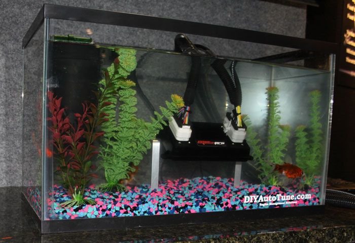

I'm running a Megasquirt MS3Pro- this is their claim to fame- I'm still putting it inside my car...
