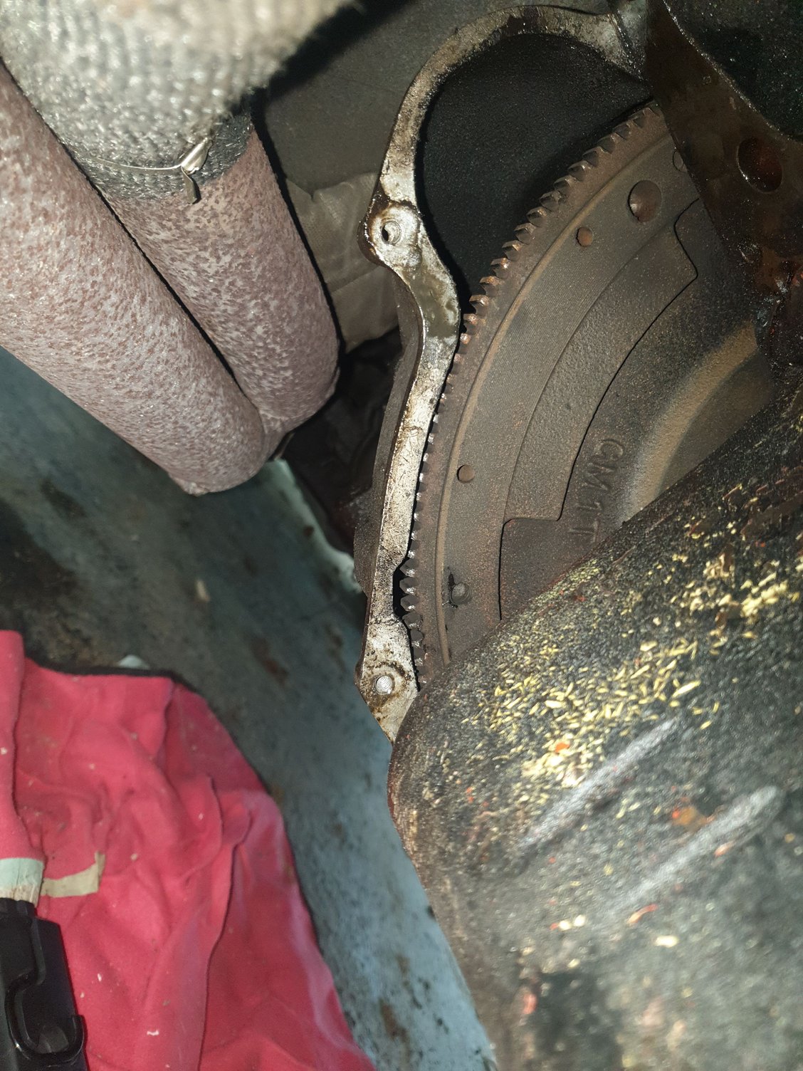

Looking at the flywheel- you can see marks where the gears have been clashing..
Any ideas? Bearing in mind that this car was starting before- I'm guessing its not clearance?

Check the Bendix gear on the starter and the ring gear on the engine. One or both may be bad as a result of an extended clash. Jerry

The flywheel is showing Mark's- but doesn't appear to have broken any teeth or anything..
