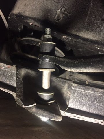

Hey guys,
I’m changing out my end link bushings on my 69 and noticed that neither side would seat properly. Is it possible that the bar itself is bent? The PO mentioned it was hit in the front end. The reason I was changing the bushings is because they were severely worn, so something isn’t correct.

Is the bar upside down, the ends of the bar look wrong to me

I thought about maybe it was upside down. The end where it attaches curves slightly downward, does that sound incorrect?

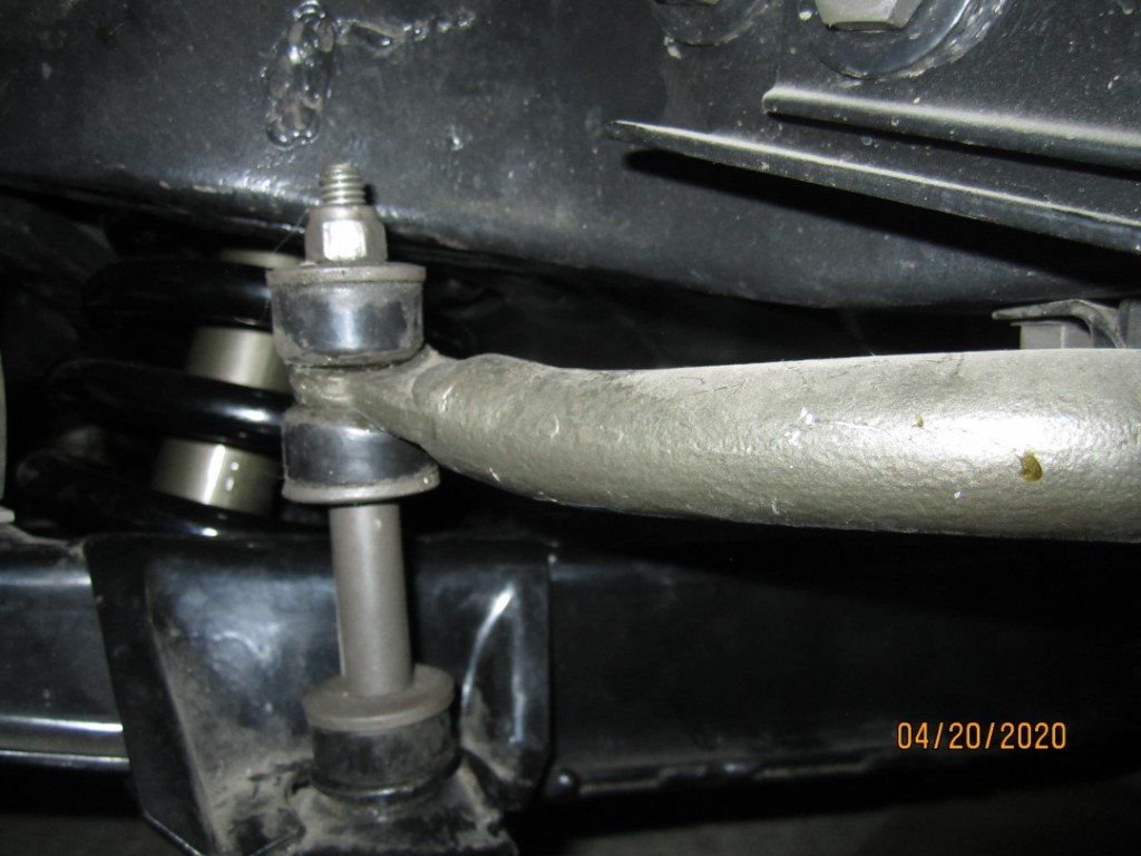

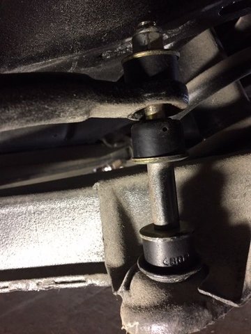

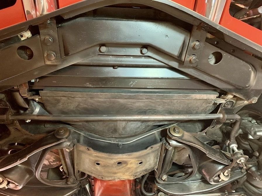

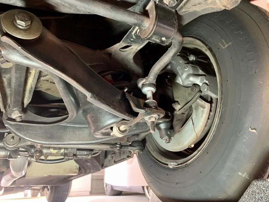

Is the bar by chance installed upside down? I know I was able to install my rear bar (VB&P model) upside down without any difficulty. I only realized it when I installed my tire tub and the bar became an issue.
Here are a couple of pictures of the front sway bar on a 1969, L46 Coupe...
Good luck... GUSTO

It’s hard to tell from the pic if the attach point of the bar is curved downward. Maybe I will just swap it around and see if it fits any better.

Mine tip upwards
