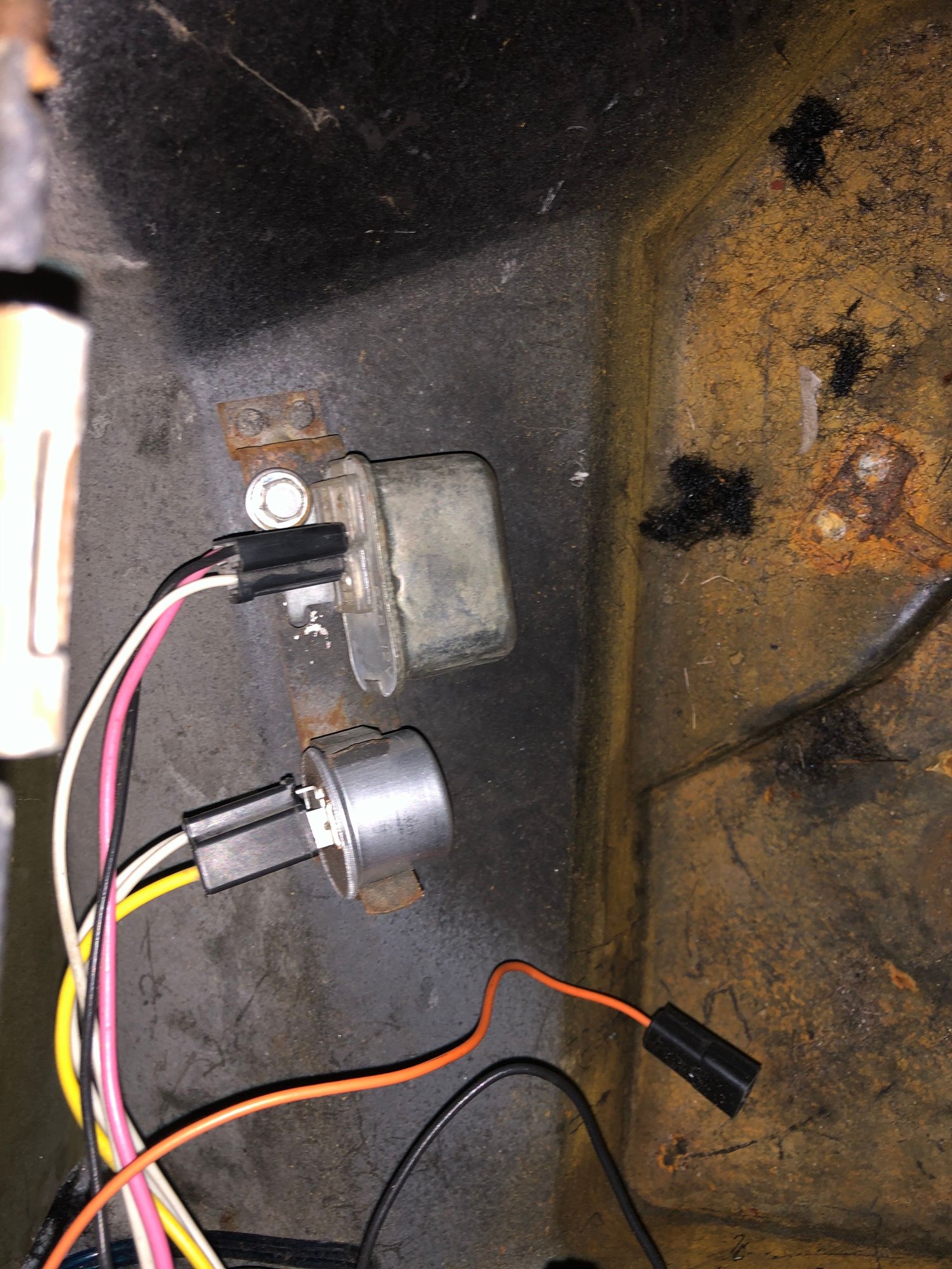

Hello everyone, my brother just picked up a 1972 Corvette and there is a strange buzz coming from the back passenger rear. With a little more investigation it is coming from the box behind the passenger seat, when I open the dwelling there is a silver box and wires, I'm not sure what this is, can someone help?
Thank you.

That is your factory alarm system. It is actuated by the key on the rear panel. If it is buzzing, it is malfunctioning. Try rotating the key position to see if the buzzing stops. If it does not, simply unplug the relay until you can have the system repaired.
