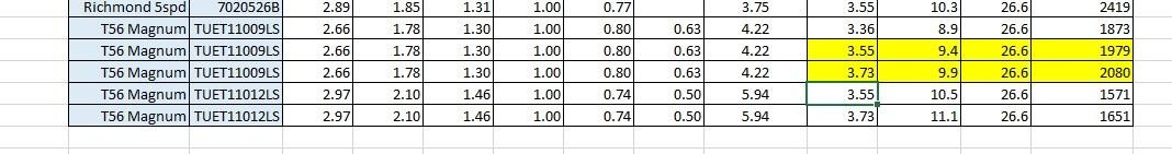

Ok really nice 1st gear overall and still 2000 rpm 70mph cruise. Hope you are looking at the close-ratio.
So if you are not going to race it, and want to cruise at 2000 rpm, I suggest a 5300-5600 rpm peak, fast ramp, tight lobe center to build low rpm TQ. Could be 30-50lbs stronger than other cams at 3500, and if done right is almost flat down to 2500. I run a 230/240 dur @ .050 and WA2fast runs a 240/250. We both have 110LC and they rev to 5800 very well.We both run really small Solid rollers for the fast ramps which builds low end. You could do the same with a FT modern cam, but they get pretty touchy on break-in, and you need Zinc oil/additives For longevity with a FT I would go slightly bigger on adv. dur. Mine is only 260/270 for a difference or hydraulic intensity of only 40. Some of the Vodoo FT go down to 33 and I would not recommend them for longevity. Stay with near 40-50 or so for some more longevity. Like an older school grind. Still faster than the OEM grinds at 50-60.
For .050 dur 220-230 will give you the rpm target, I wouldn't go over 235. The 390 HP motor only had 214/218. 110LC will make it idle with a rumble, make good power, and good low end TQ. Win-Win..Any cam in that range probably won't make 10 HP difference from one to another, myths aside. Old 350-350 L46 had 224 dur and was a terrific all-around cam. BB can take just a little more, so 230-232.
Your .565 lift target limits you to older FT as well. Final HP won't mean that much unless you are racing but should be 470 to 540 depending on intake, heads, hood, carb, headers.
TQ should be over 500 almost off-idle. Great fun! May cruise at 1600-1800 ish. Mine made 555 tq on the dyno.

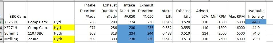

Cams that fit:
Here's 4 that fit.
Either of the Comp Cams or anything similar from another mfgr would fit the bill.
The Summit & Melling are very very old school with very slow ramps, and live well, but they trade off low end TQ for that large adv dur & hydr intensity.
Here's a Howards 54 hydr intensity
And here's a Lunati. I like it's 50 hydr intensity vs it's sisters around it
Have fun!
Cams that fit:
Here's 4 that fit.
Have fun!
