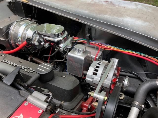

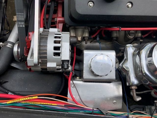

On the C4 they have it mounted down near the radiator. I put mine up near the master cylinder.

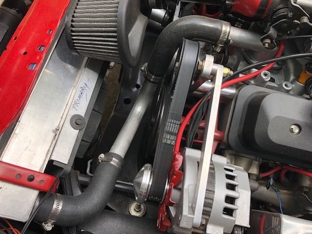

I do. The rad hose is a little different since I have the L98 engine and TPI on it, but it will give you an idea. I also will get a pic of the PS resevoir. Give me a day or so to get out and get to the car. Had back surgery 4 or 5 weeks ago and my wife gets really....let's just say she doesn't want me stopping near the car for a few minutes. Social distancing and all that. I will get some pics tomorrow. I also had to make up a line from the PS pump to the small steel line on the PS control valve. Will try and get a pic of that too.

Got to the car today. Here are the pics of the remote resevoir that I used and the upper rad hose. Again, just an FYI this is a 1986 TPI engine so the rad hose might be different than what you need. I had a clearance issue with the MAF coming off the front of the throttle body and my cold air intake. I preferred to use hard pipes and only rubber ( silicone) where I needed to make connections. Good luck.
Had to cleare Maf and air pump delete pulley
Top of resevoir. Had to fabricate something to make inner fender straight.
