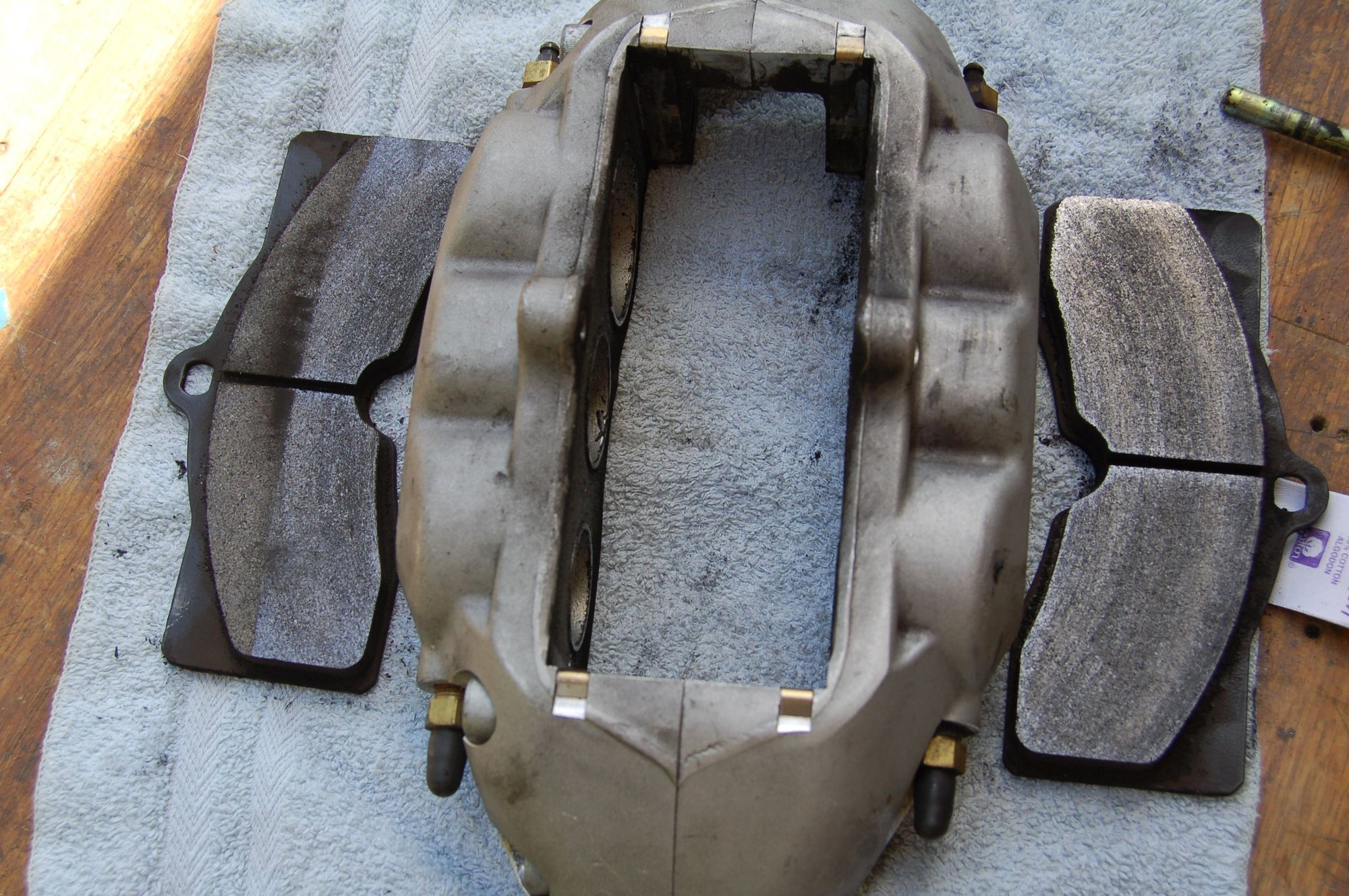

Had a problem with a stuck piston which Wilwood fixed gratis, hence this picture. You can just see the different piston areas here. As I remember the bigger guy goes to the trailing edge which makes sense. There is an orientation notation on the flip side of the caliper in any event.
