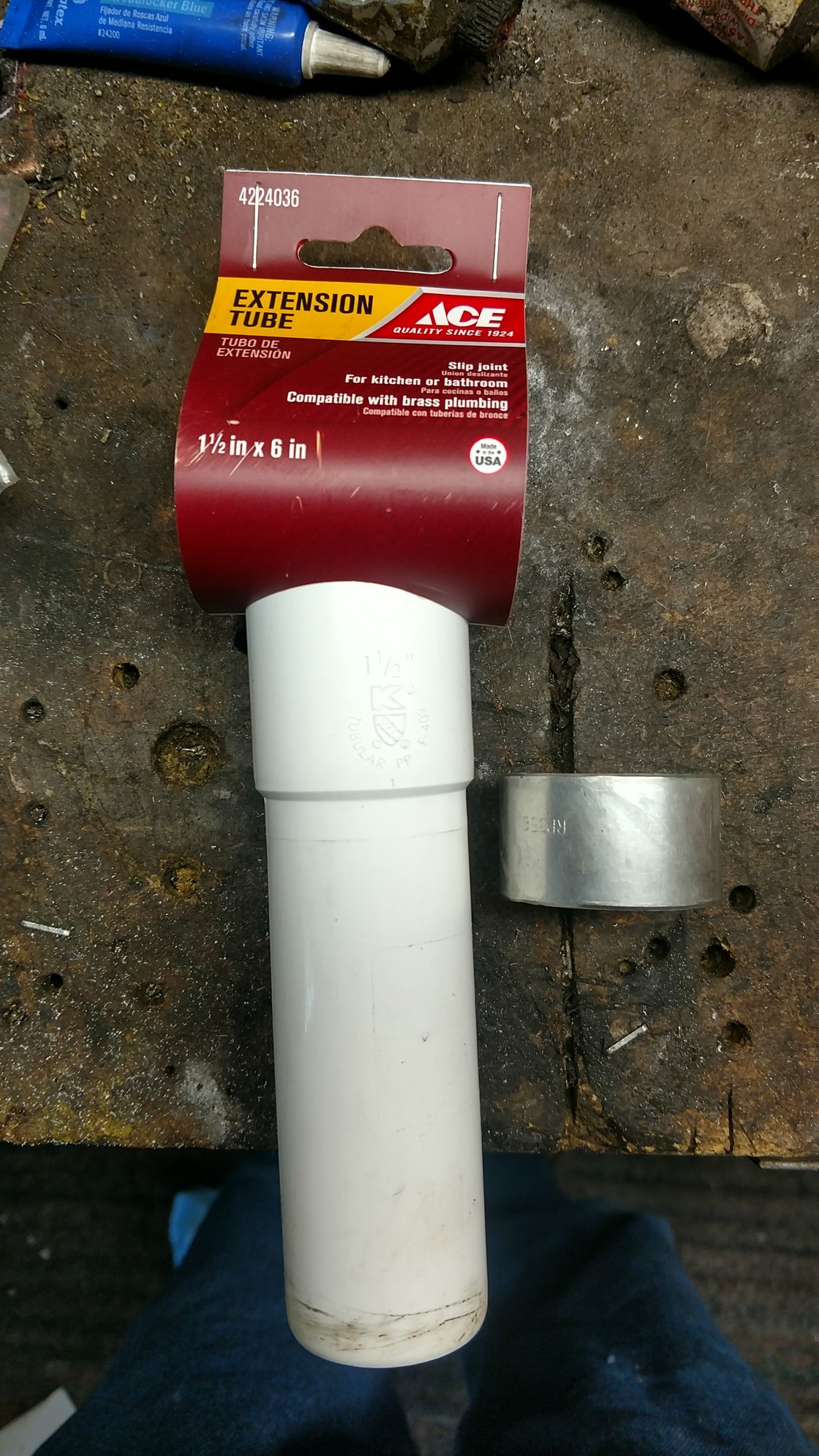

I found a Snap-On S-8672D bushing puller for $60 that should be here in a week or so. Made a Bubba install tool for $4,,, I hope it works.

i didn't know federal mogul made sink pipes... good looking rig.

I'm not sure how well that's going to work hammering the bushing in with a plastic pipe. Drain pipe isn't even full PVC thickness. Maybe if it were rigid plastic IDK. I'm going to say it'll be a no-go. Takes a little hammering force to get a bushing seated. I would get a piece of steel pipe that's the same dia as yer bushing, like a section of exhaust tubing from the auto parts store.

I changed the rear bushing on my 200-4. I know yours is a standard. I cut a slot I the old bushing with a small air saw. It collapsed and came out pretty easy with some prying. I heated the tail shaft with my electric heat gun. Put the new bushing in the freezer about a hour. Then drove it right in with a short piece of pvc pipe. Just some ideas.

I was thinking the same thing so I made another one.... I figure dry ice and some grease will also help. I had to cut off my steering column to fit the Borgenson, this is the left over 1.5 inch end. Thank you your for input.

That looks better.
