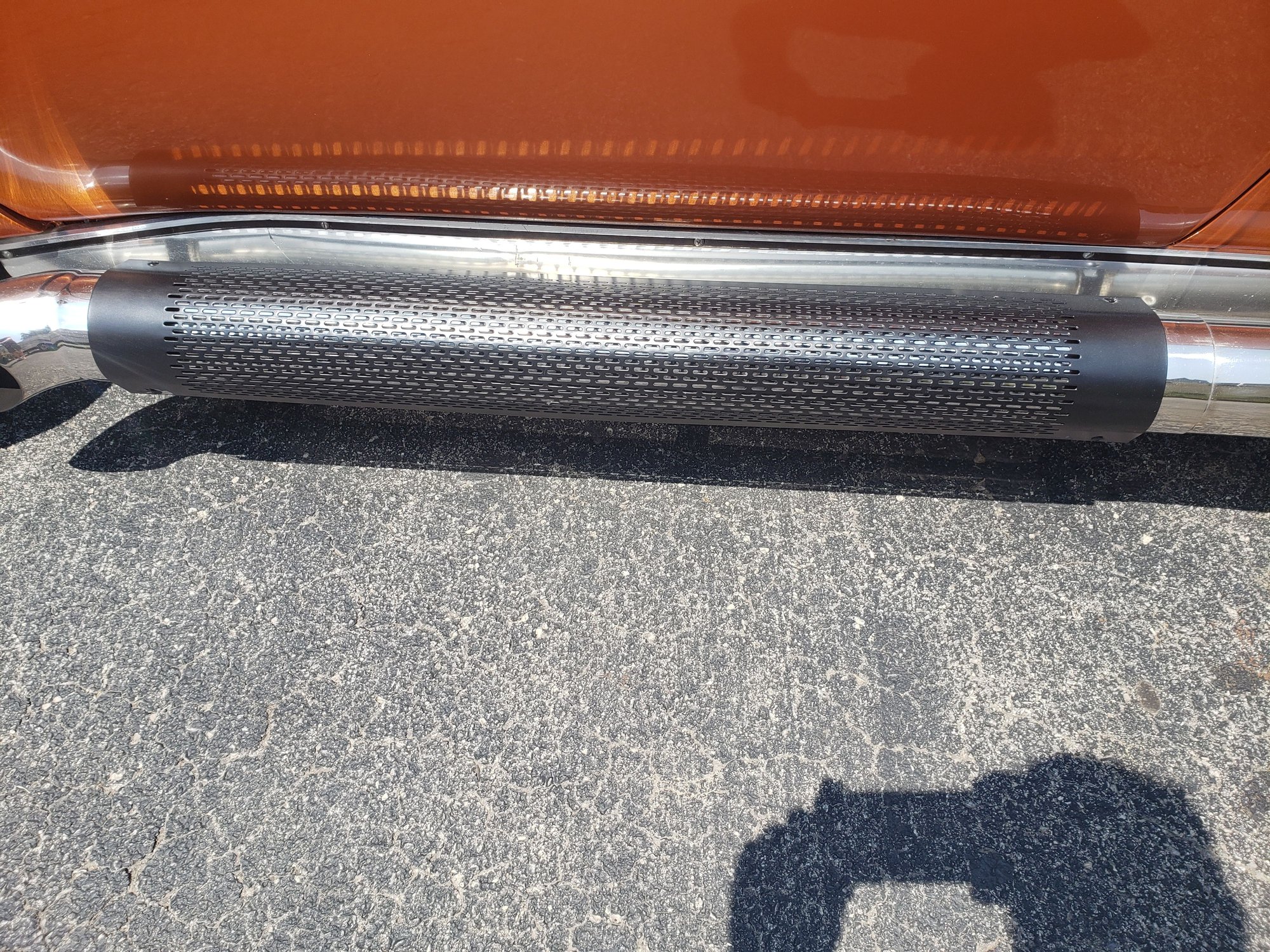

This is news to me... and Ive had them since 2013. honestly due to where they are positioned on the vehicle its never been a concern for me. I did end up changing out my inserts for a pair that were not quite as loud and didnt have the drone (I have vettepacks now). I second the het shields too... made a pair myself with some shields meant for the fake patriot sidepipes.
they arent for everyone but they were only about $75 to make and paint the pair... they are spaced off the pipes with header wrap wrapped around the pipes under some 4" spainless clamps which are riveted to the heat shields. I did not care for the look of the chrome over the stainless pipes so I painted them.

Those Patriot shields work. I'm glad you can paint them, that was my plan, too. This will look a lot better in all-black, with the side bezels put back on.
