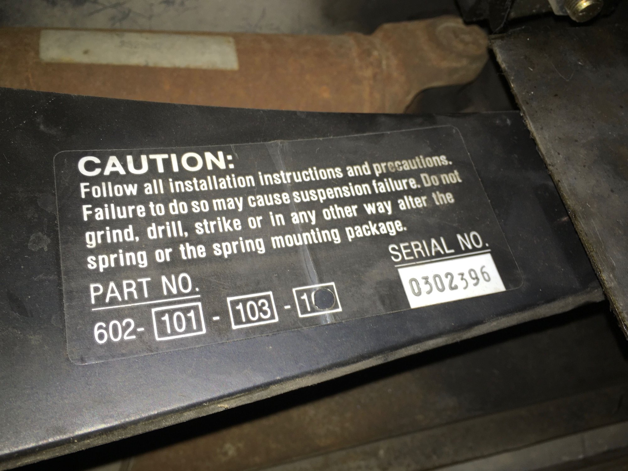

Interpon - when you said I should take a picture, I thought yep that’s a good idea. Then I found this.... I will be replacing the rear spring now.... I guess 20 years is the life expectancy of a fiberglass spring.... I hadn’t looked underneath it in several months.

Any chance someone jacked the car up by the spring?
My TRW spring is 32 years old and shows no sign of fatigue.
I also notice no thread is showing at the end of the spring bolt. Make sure when you install new spring the nut has to be at least a little higher.

We’ve always been careful not to lift by the rear spring. Just as we have always opened the doors and loosened the t-tops when it has gone on a lift. Those are nylon nuts at the end of the spring bolts and they were flush with the spring bolts. But I agree with showing a thread or two.

Started to unbolt the leaf and saw the serial number. After some digging it appears to be a TRW 355lb spring. So I do need stiffer shocks as well.
