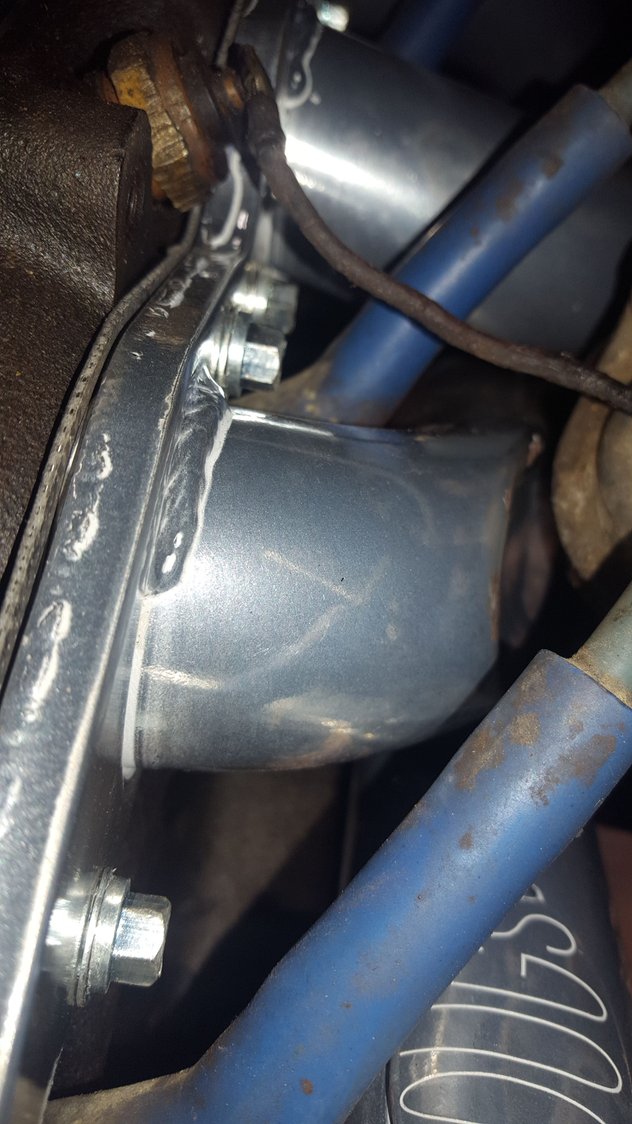

We finally got the headers to line up. It was hitting the steering box and nothing could be done about that other than putting a dimple in the pipe that was hitting. After that it went right up flush. Right now it's getting some touch up paint (I went with the black headers and pipes) and then tomorrow it will get bolted on.

That is strange. My drivers side header already had a dimple there and I assumed your would have had one also.
This is how mine looks.
