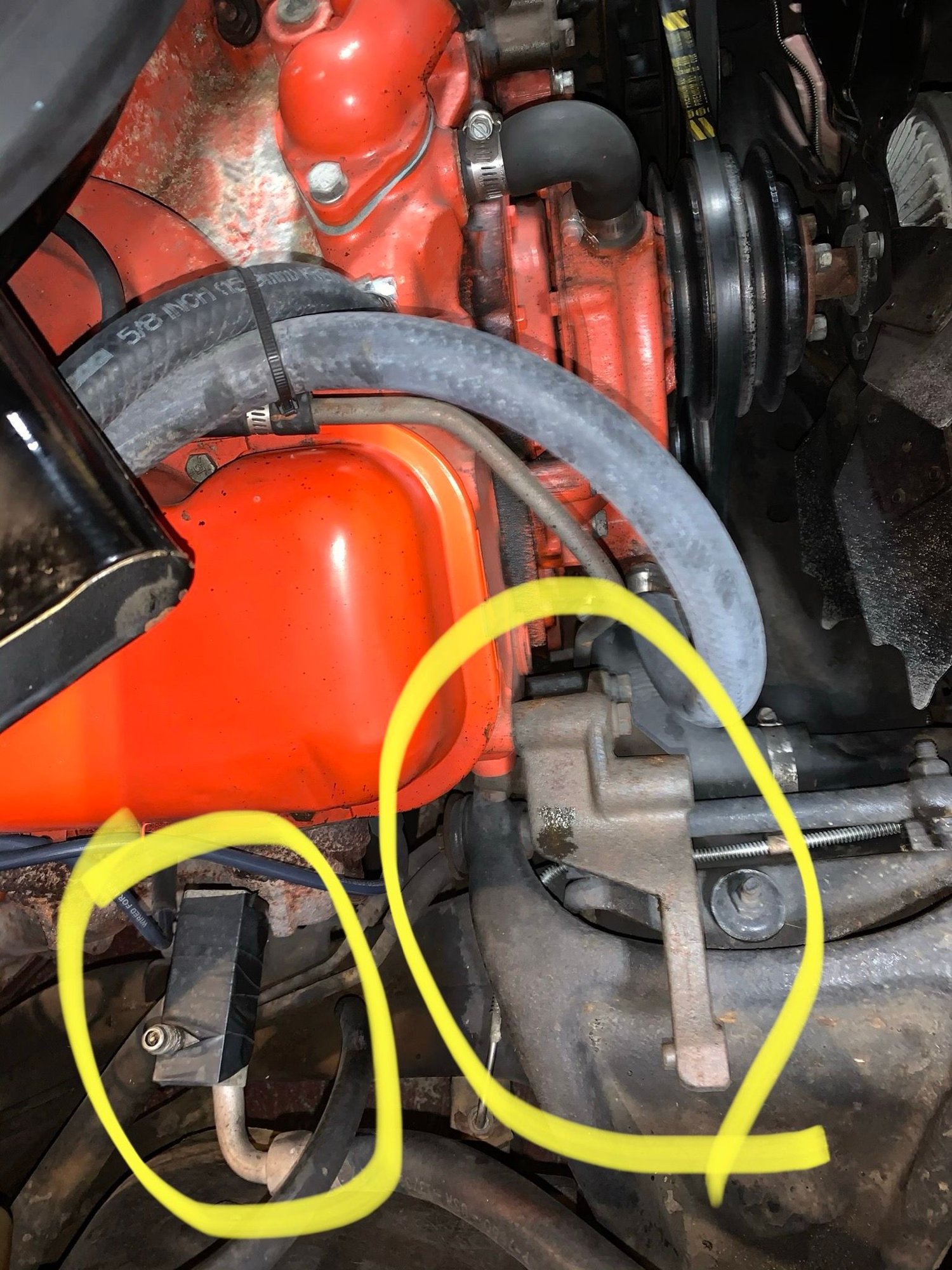

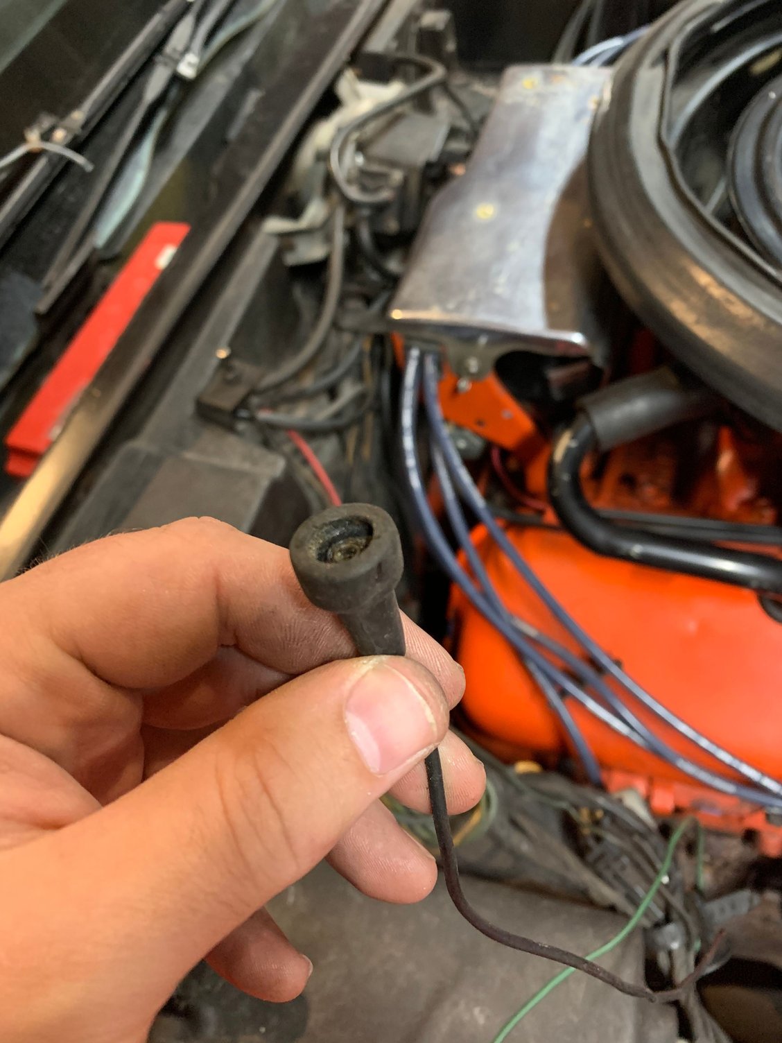

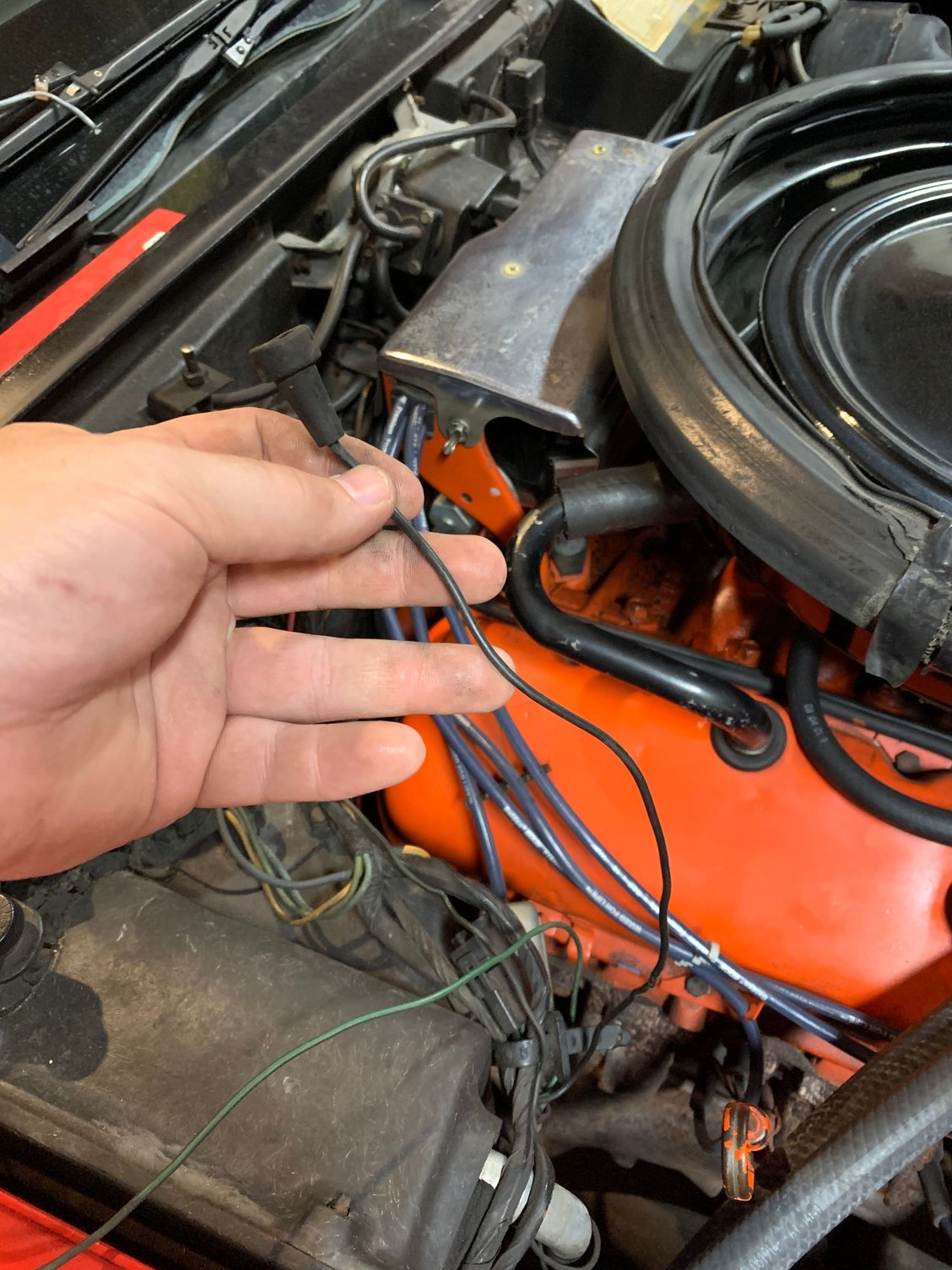

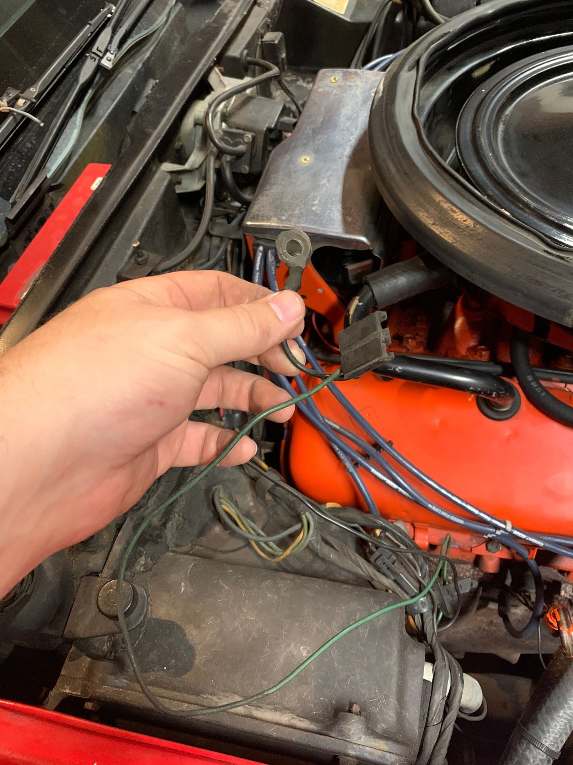

Fooling around in my engine bay and I found these wires looking disconnected and missing a fuse. Anyone know what these are?

Picture 1 bolts on to the compressor with the bracket bolt, it's a ground; picture 2 plugs into the head of the A/C compressor; picture 3 I believe plugs into the back of the compressor, goes to a switch that "saves" the compressor from damage in case something causes it to "superheat", like being out of freon or bearings going out.

gotcha, so it’s all AC related then. I was told the car didn’t have AC bit I guess they just removed it... looks like there’s a bracket for what I assume is the compressor and this line for refrigerant is all taped up... i’m not worried about putting AC beck in but if all I need is the compressor and maybe a few other parts and some refrigerant, maybe it’s not a terrible idea....

That one piece on the end of the rubber hose is called a muffler and it does hook on to the back of the compressor. Suppose to have two valves on it though, one high side and one low side pressure for charging the freon. Many components to that system, exposure to air is not good but like you said, one of these days you might just try to resurrect it
