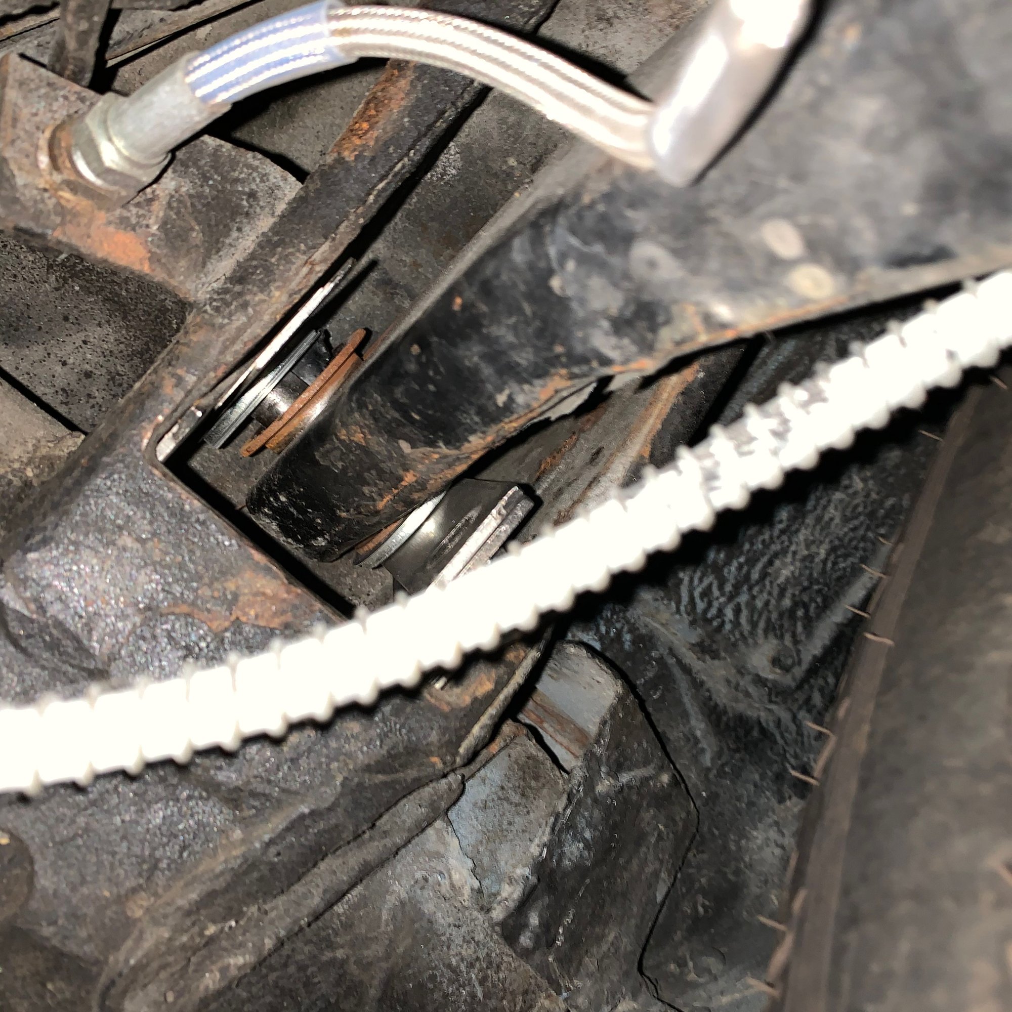

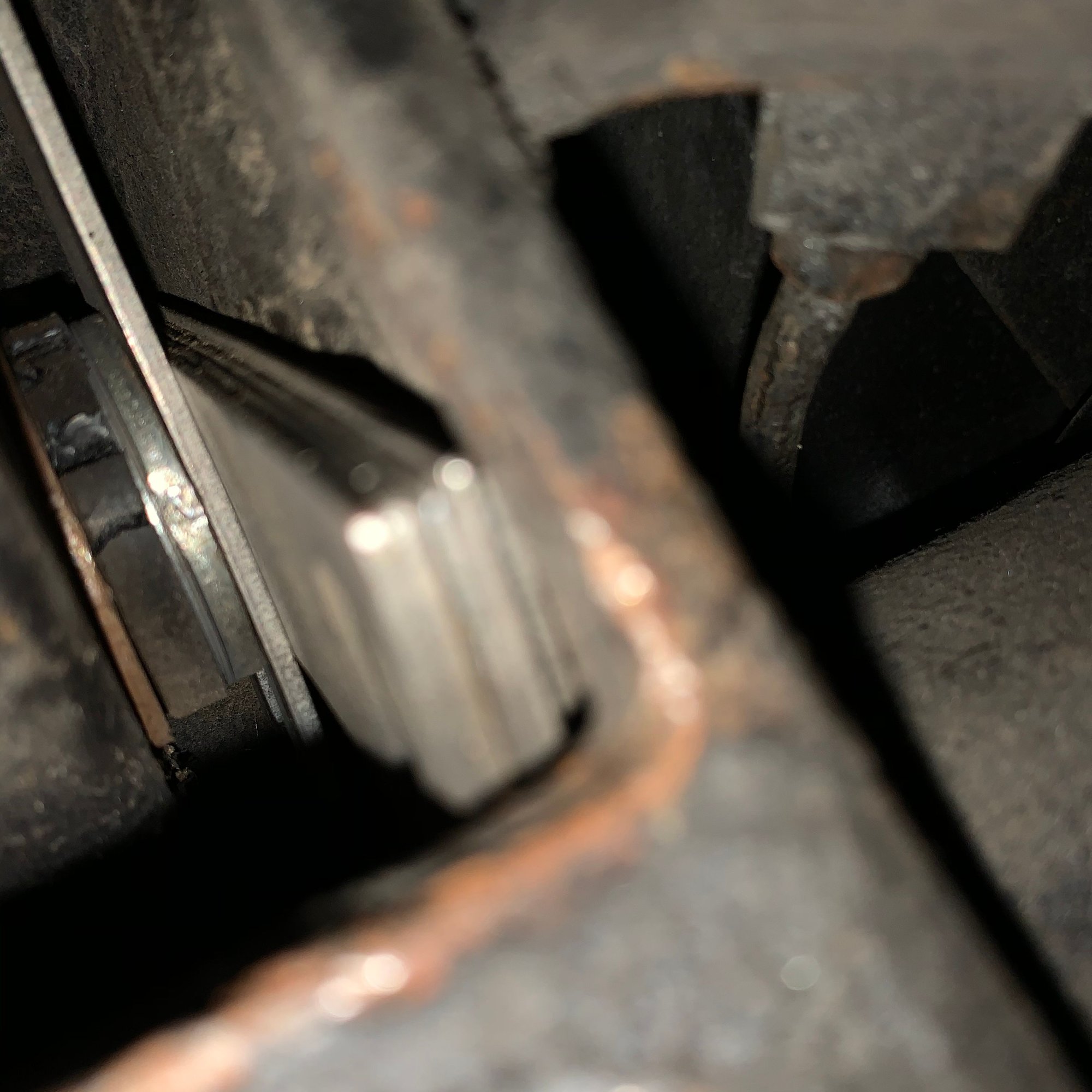

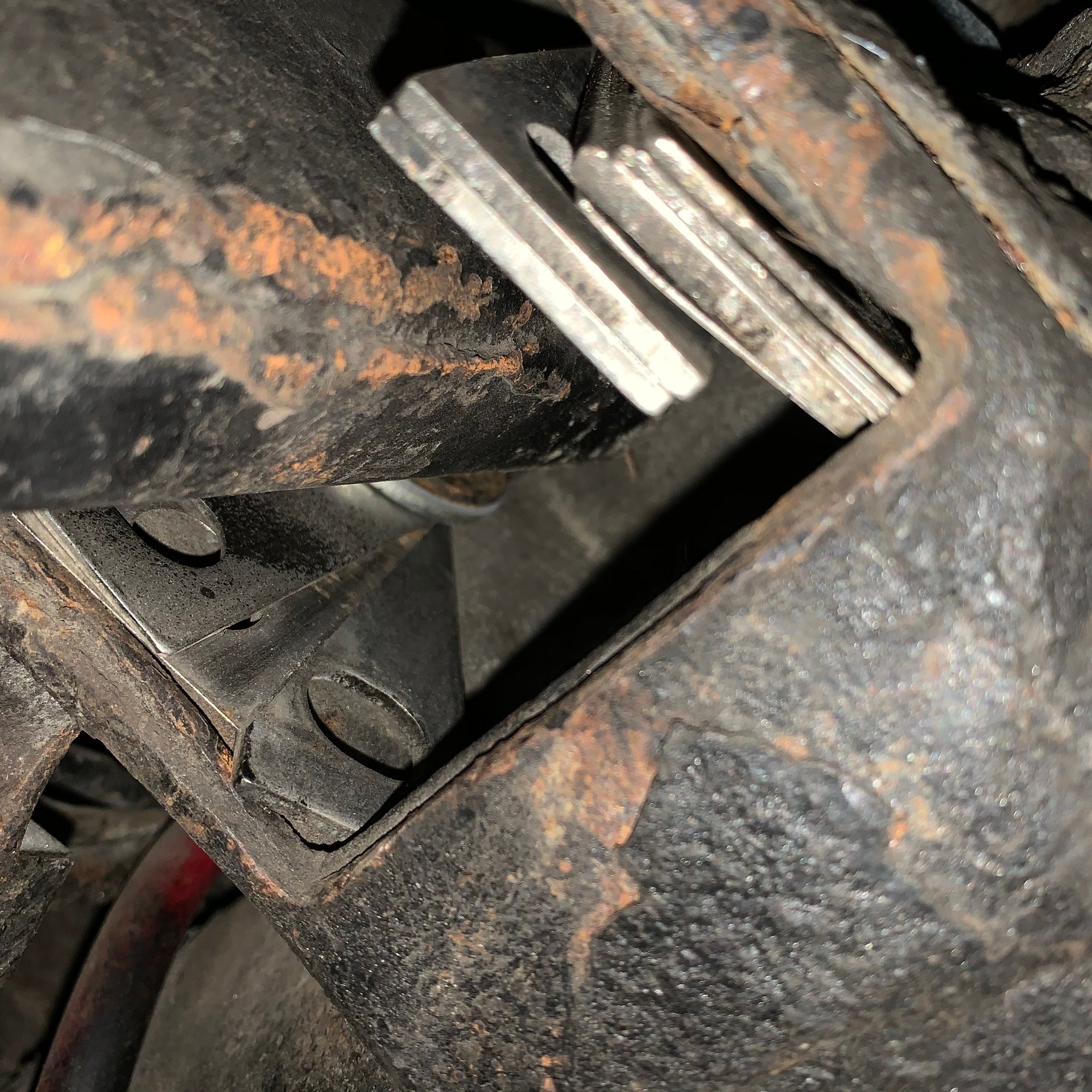

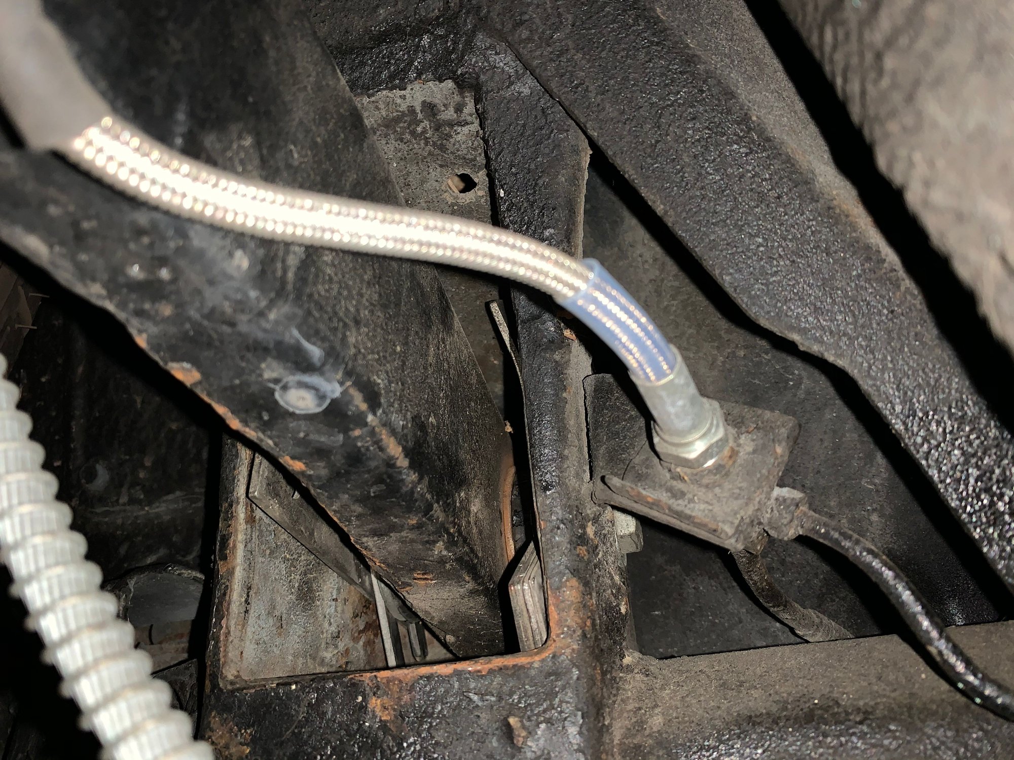

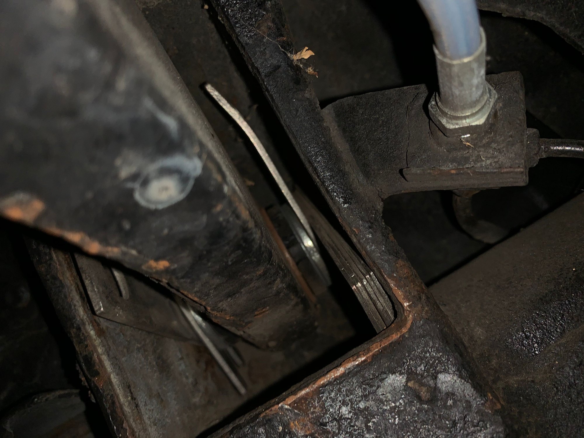

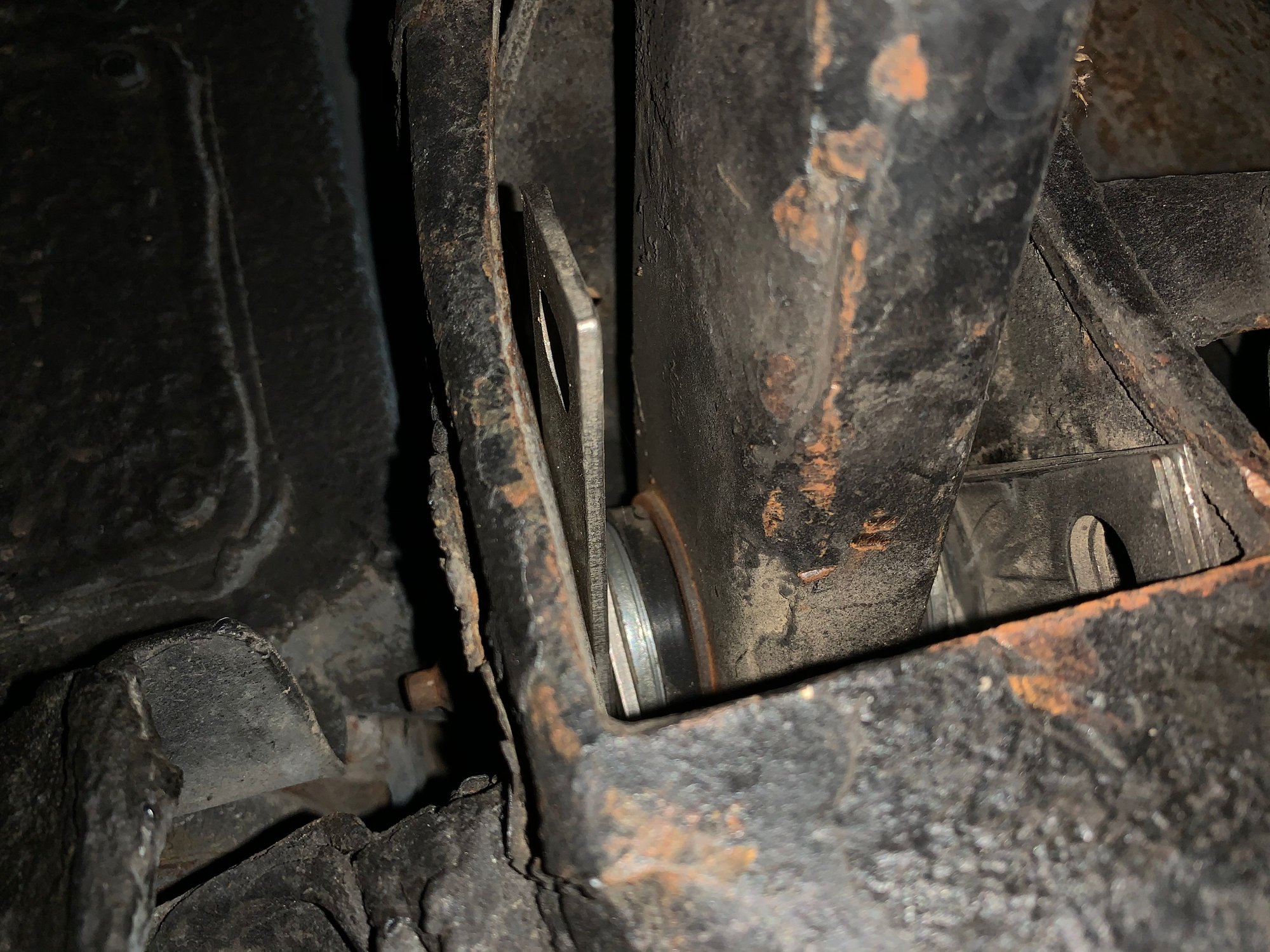

Here are some pics
Per original post problem didn’t occur until a few weeks after having Strut rod and leaf spring bushings replaced and car aligned. Rear only kicks out when shifting, Differential bushing looks good, TA bushings are still there but going, suspect problem is shim that came loose. Are the TA arms themselves good for life or do they need to be replaced? They seem solid but do have some wear and surface rust

Looks like the poly bushings are gone on one side and broken on the other, the arm will move with the shims in place but they look shifted too. You need to pull the arms replace the bushings and get it aligned all over again. I don't know if you rebuilt the arms but you should check the bearing play as well. If it were mine I would be breaking them both down and rebuilding them.
yea I just noticed the one was shot when seeing the picture on my PC instead of the phone
Just took it back to the shop and took the tech for a ride and it really didn't do it with two of us in the car, strange, but it sure did when I was driving it there so I told him to take it out for a ride alone
Didnt do the anything to the TA's yet, but looks like I will be having them done

anybody else notice that the cotter pins missing g to keep the shims from falling out?
Old Jun 1, 2020 | 04:30 PM
GTR1999's Avatar
GTR1999
Joined: Aug 1999
Posts: 15,175
Likes: 3,990
From: Connecticut, USA
69's didn't use the cotter pin, may be late in production but many don't have the hole in the frame as they use 2 hole shims not slotted.
Don't drive the car in that condition, yes you should check the bearings, & condition of the arms.
Rebuilding any old car is expensive. Corvettes even more so with the IRS and the fact everyone now wants to put in engines with 500-900hp and otherwise expect the drivetrain to hold up even though it was designed for 400hp give or take.
its actually a late 1968 production 69
the car is at the shop Now and I can’t check bearings myself, previous owner Did brakes calipers, rotors and lines and hopefully did the bearings, if not I will do them when the arms come out,
owner before him did the VBP suspension and there are hardly any miles on it since the guy I bought it off of couldn’t drive it the last few years
I can’t believe how those VBP poly bushings fell apart
I noticed that immediately. Whether correct for this car or not, those look like slotted shims. I'd add the cotter pin, since it looks like you already lost a few shims. You may have to drill the holes yourself.

Thanks for all the suggestions I planned on doing rubber for the TA based on previous forum user input
but looking at the TAs they look kind or ratty and was thinking about just getting powder coated ones with the bushing installed
how does the cotter pin go in do you drill a hole in the TA and put it through the shim opening into the hole?
