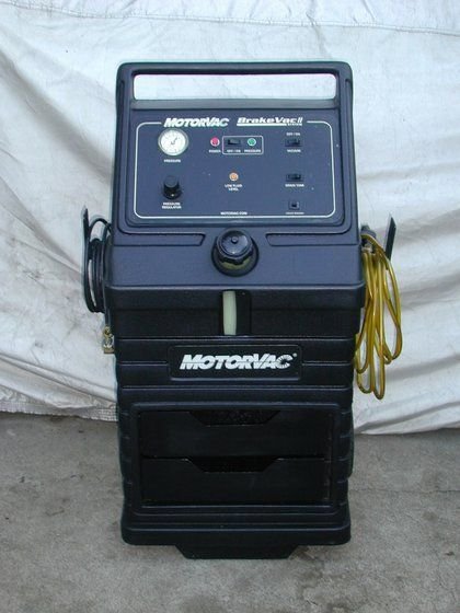

I've got access to a BrakeVac II pressure bleeding machine (but I'll be bench-bleed/gravity bleeding this 81 corvette).
