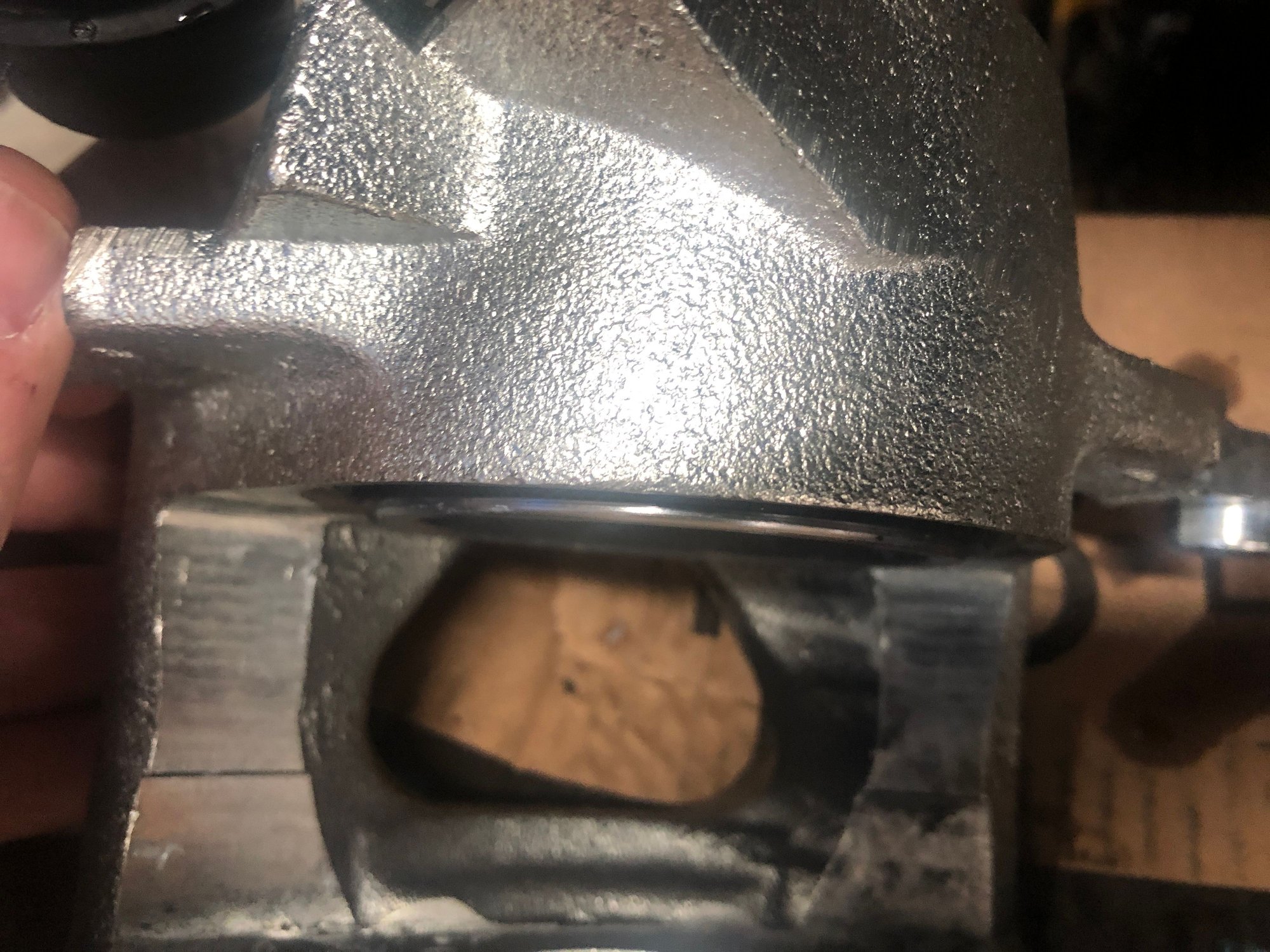

Cracked the bleeder and used a caliper tool to compress the piston back into the bore.
when compressed, should the piston be flush with the caliper, or still slightly protruding?
Using a feeler gauge, it measures to still protrude about .090
photo below is fully compressed, with bleeder valve cracked
Old Jun 6, 2020 | 04:35 PM
  #37
keithl1967's Avatar
keithl1967
Joined: Feb 2012
Posts: 421
Likes: 27
From: Harrisburg PA
narrowing it down...
1. R&I'd the calipers, and was was able to get the calipers adjusted so the rotors could spin fairly freely...
2. Pumped the brakes, and it locked the rotors...after some time, they released "somewhat" to where I could actually turn them with a lot of effort by hand but could not get them to "spin" or get even one revolution without continued pressure applied--still way too much drag.
3. Removed the master and measured clearance against the plunger using the special tool...(if anything) there is just a touch too much space ( a tad more that .060) between the plunger on the master and the pushrod on the booster, so it is not the booster or the master that is retaining pressure.
4. Removed the proportioning valve (I have not yet installed the replacement); however, there is still the same amount of drag on the rotors, even with the prop valve completely off the car, and the lines not attached to anything.
Given all of the above, it has to be either two bad hoses (as the issue is the same on each side, or two bad calipers, correct?
What are the odds that I'd get two bad hoses, or two bad calipers?
Tried checking both advance and pep boys, to see if there was a thinner pad available, and all measure (with a caliper tool) slightly THICKER than the current pads I have, so I doubt it's pad thickness...and like I said, I was able to get the calipers to allow the rotors to spin comfortably after and R&I and backing the caliper manually as far into its bore as it would go...
To Not corvette, but brake tech question
Old Jun 6, 2020 | 08:15 PM
  #38
HeadsU.P.'s Avatar
HeadsU.P.
Joined: Aug 2017
Posts: 8,336
Likes: 2,810
From: Cool Northern Michigan
Wow. Number four has me scratching my head.
Sure sounds like rubber hoses. But if its not . . . . . . . . . . ?

Old Jun 6, 2020 | 11:00 PM
  #40
lionelhutz's Avatar
lionelhutz
Joined: Apr 2007
Posts: 11,152
Likes: 890
From: South Western Ontario
The calipers is supposed to have a shape to the recess for the seal that twists the seal a bit and then when the pressure is released the twist in the seal relaxing is supposed to pull the piston back ever so slightly. Those disk brakes will always drag a little, but the wheels or rotors shouldn't be overly difficult to rotate. There may be a build problem from the manufacture of the calipers if the pistons are not retracting the slight amount like they should. possibly the shape of the seal groove is wrong on the pistons are dragging in the bore enough they won't retract.
