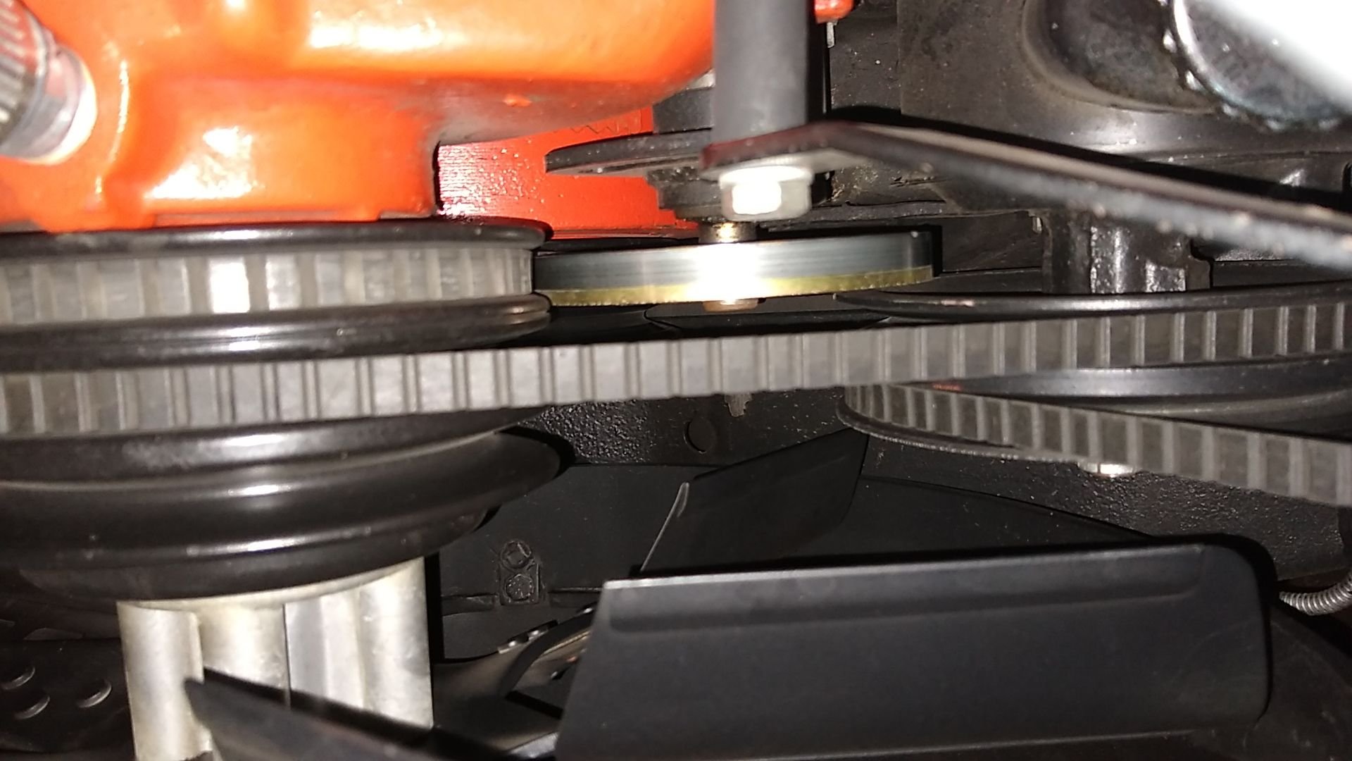

The car seems to be more responsive after changing the advance line routing and changing the timing. I moved the initial timing to 14. Prior to moving it it was a long ways from the top of the timing pointer. I am going to look at getting a dial type timing gun as well as have someone else assist to work the throttle so I can time it at 3500 rpm or so, I am going to keep an eye on fuel mileage. Hopefully with some changes that will improve. Does anyone know what the pulley in the attached picture is doing? It is the one with the goldish colored finish. It seems to spin off another pulley. I cant see any wires going to it so I am not sure what it is doing.

That gold-ish colored wheel is the idler pulley that came on big block A/C cars.
https://www.corvetteforum.com/...3793362-big-block-idler-pulley-pictures-wanted.html#post1591763453
"The A/C equipped big blocks MUST use the idler belt because their A/C compressor is driven off the water pump pulley ONLY as it doesn't go around the crankshaft. Without the idler belt the entire load of the alternator, fan, water pump, and A/C compressor would only be on the fan/alternator belt and it'll burn up from being overloaded."

With the big block idler blocking my view of the timing pointer it is very tough to find a good spot for a reading. Since the car does not have AC and I don't plan on adding is there any harm in removing it ? I also noticed that the timing pointer has points but it doesn't have a big notch in it to Mark the 0 location unfortunately since it is painted Orange I can't make out the numbers so I will have to go based on what you have mentioned as far as the 4 8 12 16 spacing. Not that I like assuming but I can't even get my fingers in there to rough the paint off the pointer. I am hoping that the springs and or weights in the distributor make a noticeable difference in the performance of the car.

Take the idler off. Get the timing pointer cleaned up. Read it, paint it sand it clear it whatever. make it so you can see what's going on down there. Get it timed. Then put the idler back.

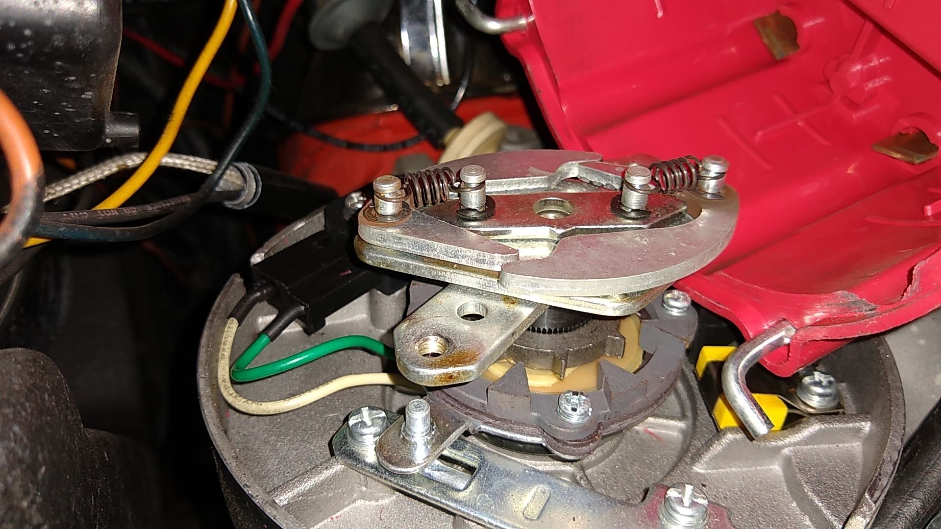

Yes your pics look like the stock stiff springs.
What I have heard on the curve kit is start with one light and one medium spring. Not sure of the colors. The important thing is it's all-in at 3000 ish.
And throw the Mr G weights away & use the stock ones.
