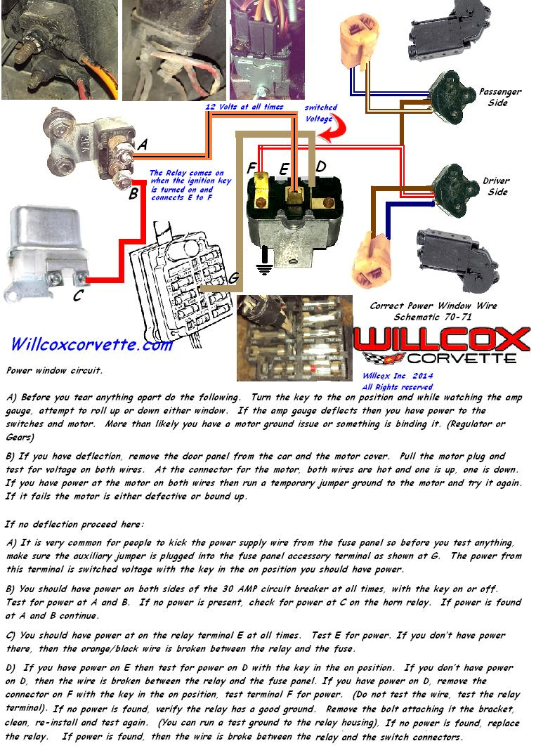

Did you happen to mess with anything under the shifter console recently or at the fuse panel where the TAN acc tap goes in?
That wilcox schematic is real nice.
