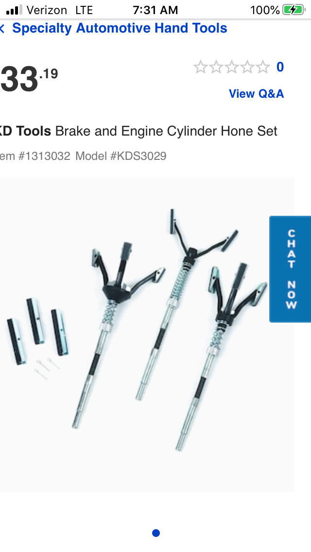

OK guys I got looking again at the bores in my calipers. Just for grins I hit the worst bore with some 220 grit and WD-40. A few minutes of working on the ridges, holy crap they're coming out pretty well. A few more minutes, then onto some 400/600 and 1000gt and the bores look perfect. Very good. So I did the other 3 on the worst of the front calipers. Looks like I CAN rebuild these now ...with a little more elbow work (plus sandblasting and high-temp paint). I will remove the rears and inspect them before I make a final determination. I'm glad you guys gave me the 'kick' I needed. Of course by the time I get these all done I'll have 1.5x in time/money as a rebuilt set of calipers, but if they don't leak it's worth it.

These worked great on my caliper bores with some slight pitting. Smoothed then out pretty quick. No leaks.
