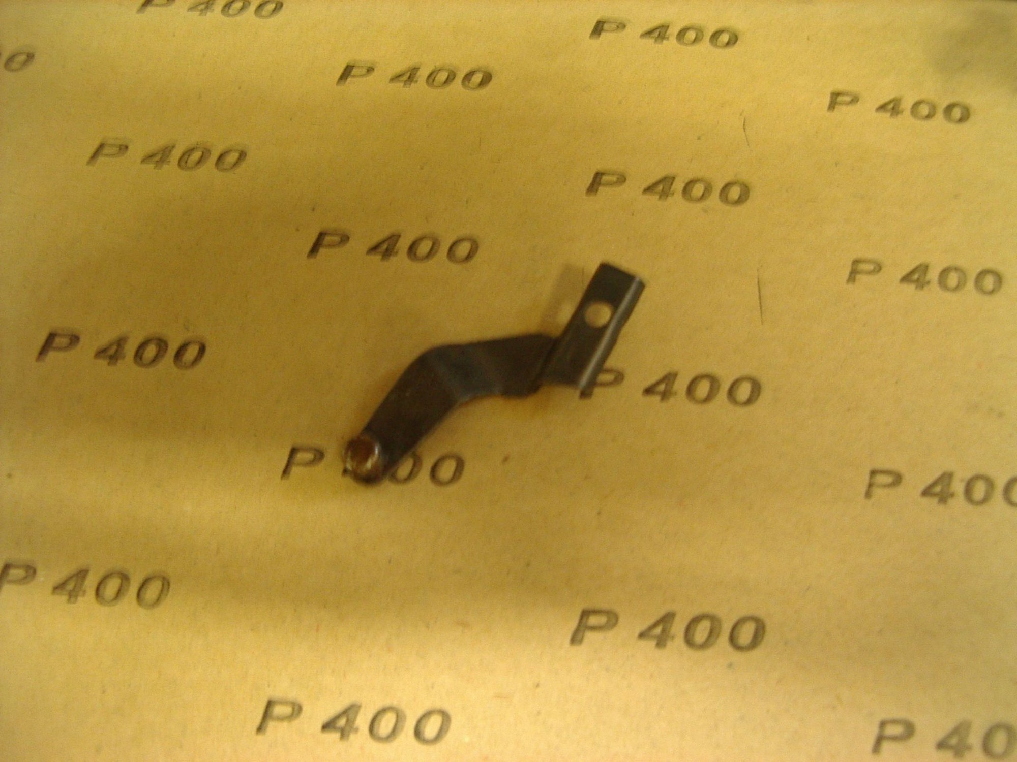

Finally got around to re-assembling my steering column, which I stripped down about 2 years ago. I can't work out where this bit goes, can anyone help?

That's for the turn signal..

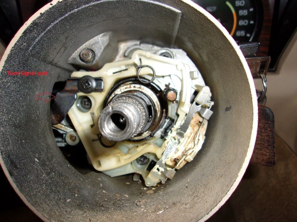

This may help, this is from my "79"

That's it, thanks!
