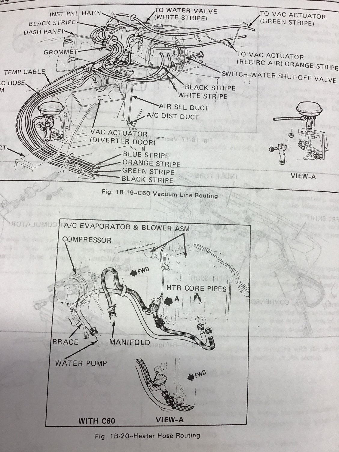

Old Jun 7, 2020 | 09:36 PM
interpon's Avatar
interpon
Joined: Jun 2019
Posts: 7,649
Likes: 2,466
From: Indiana
Routing and vacuum if anyone can use..note a 79
