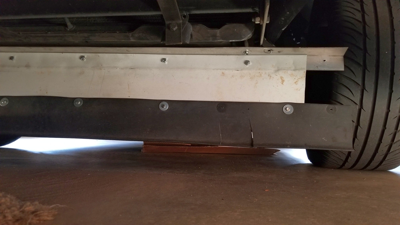

I just took a picture of my chin spoiler extension. I was under the car trying to figure out the QA-1 spring length. Anyway I have my collars cranked up 2 inches on the shocks to raise the front end for street driving and parking at curbs.
Top is angle aluminum, sheet metal, and then rubber. The gaps at the ends were for my 4 inch brake ducting. I busted up the front end for the last time at the track and removed everything.
