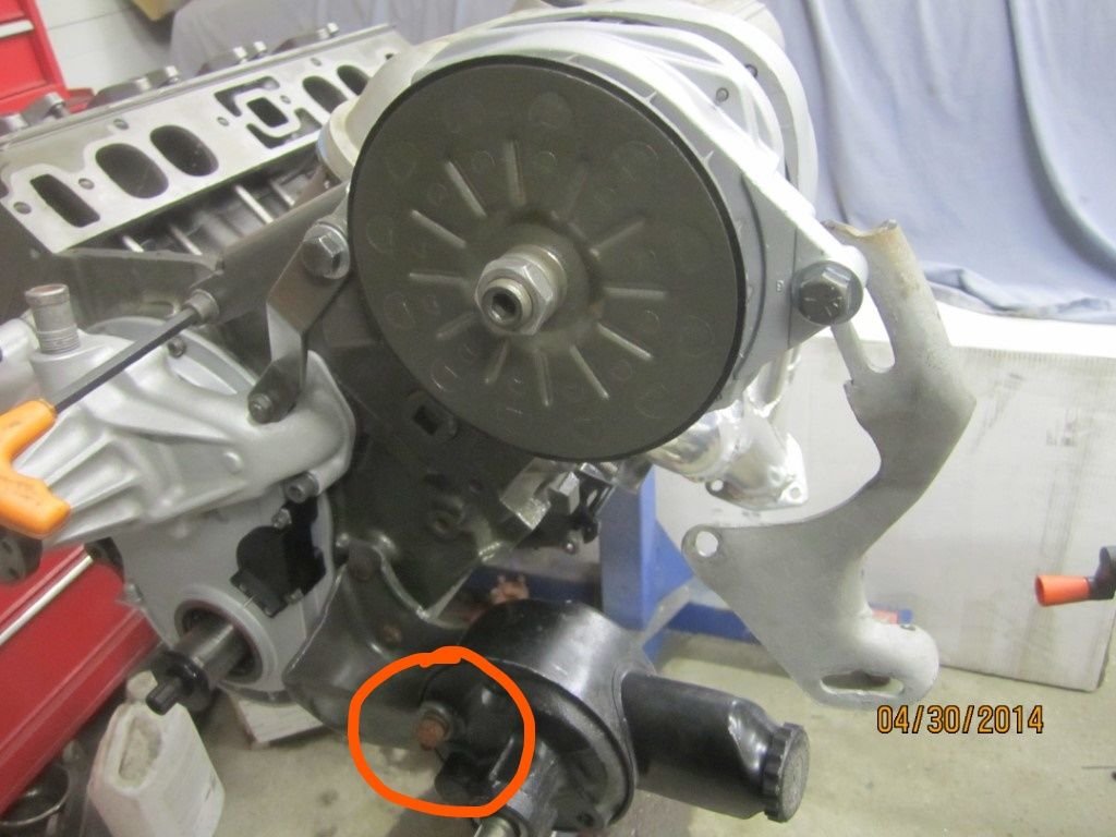

I'm replacing the belts, (or trying, anyway), and I have loosened off every bolt or nut I can find on the pump, (4 in total), and it still won't pivot to allow me to get the belt off and back on. I've loosened the adjuster bolt, the two that mount the bracket to the block, and one on the rear bottom, and nope, not budging.
Is there a 5th and 6th, or even a 7th?

Sounds like you missed the front pivot bolt, the two into the block don't need to be loosened but there's another one that's inline with the nut you loosened in the bottom-back
M
It's behind the pulley so you may not see it easily

Thanks everybody, especially Mooser..
I'm sure I missed the one that Mooser has in his picture.
The belt's the right length, and I'm changing it because it has to come off to replace the fan belt which was the wrong width. Definitely a Bubba job, put on whatever you have that will sorta fit.

Thanks a lot Mooser, I'm sure I missed that one.
