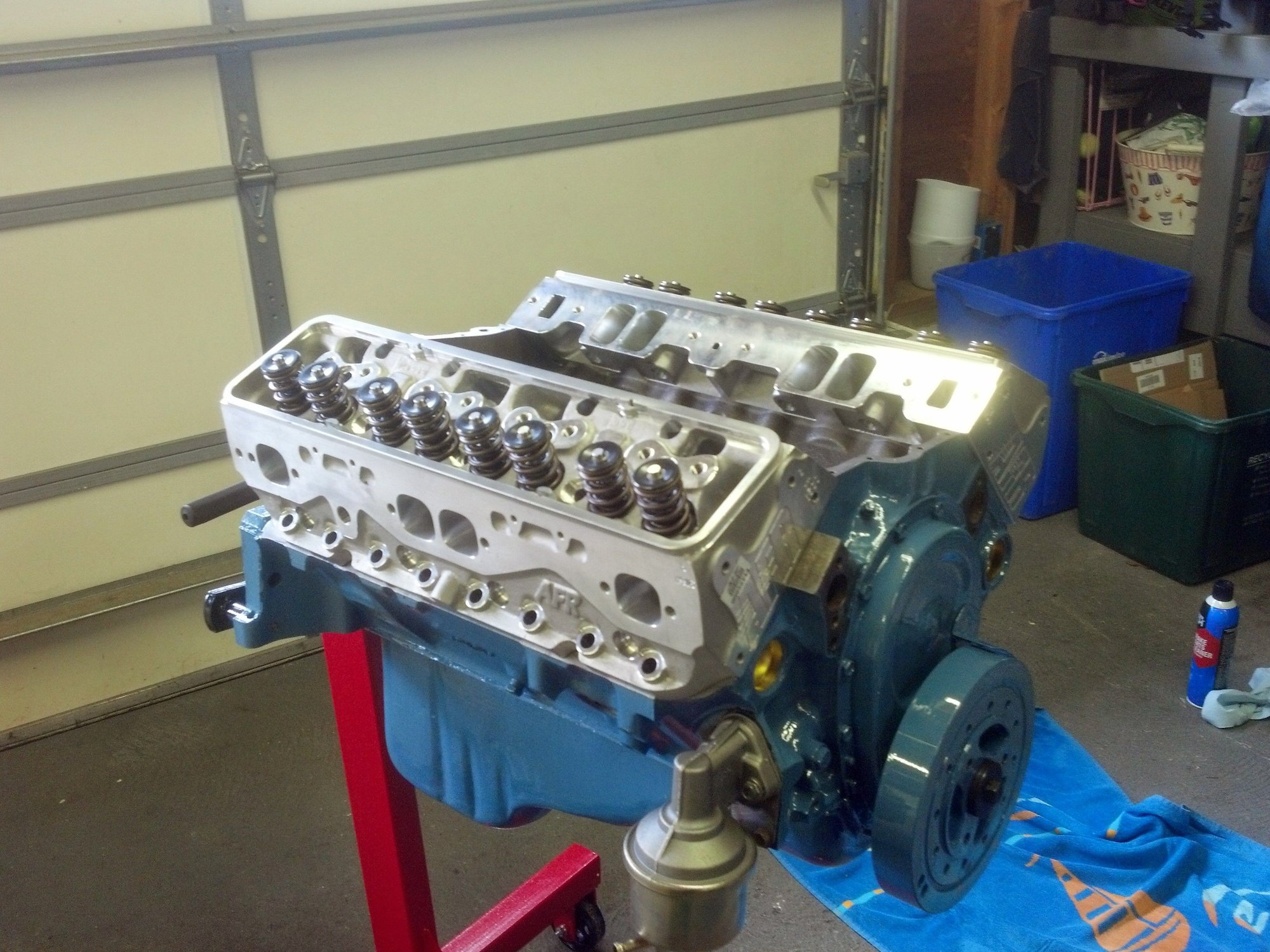

Originally Posted by REELAV8R
which timing cover does this? Link? Like I said, mine does not. It’s so close that a metal ruler won’t even fit in the space so the adjustable nut cover is out, but it’s enough to allow the cover to flex and cam to walk.
Picture of the water pump sitting DIRECTLY SNUGGLY against stock timing cover with stewart Stage 2 aluminum water pump before rebuild and same cover after on new 355 L-82 sans water pump installation (same one in the picture). You can just see the dimple on the upper left of the timing case cover for the cam button if you zoom on the second picture of the engine. Not rocket science to install the cam button (its freaking so easy) since its sole purpose to allow very little forward movement if a weak timing chain is used or stretches....
And the timing case is going to flex how?
For those roller cams installed on non C3 water pump engines, reinforcement is necessary......where the pump is not directly against the timing case cover.
