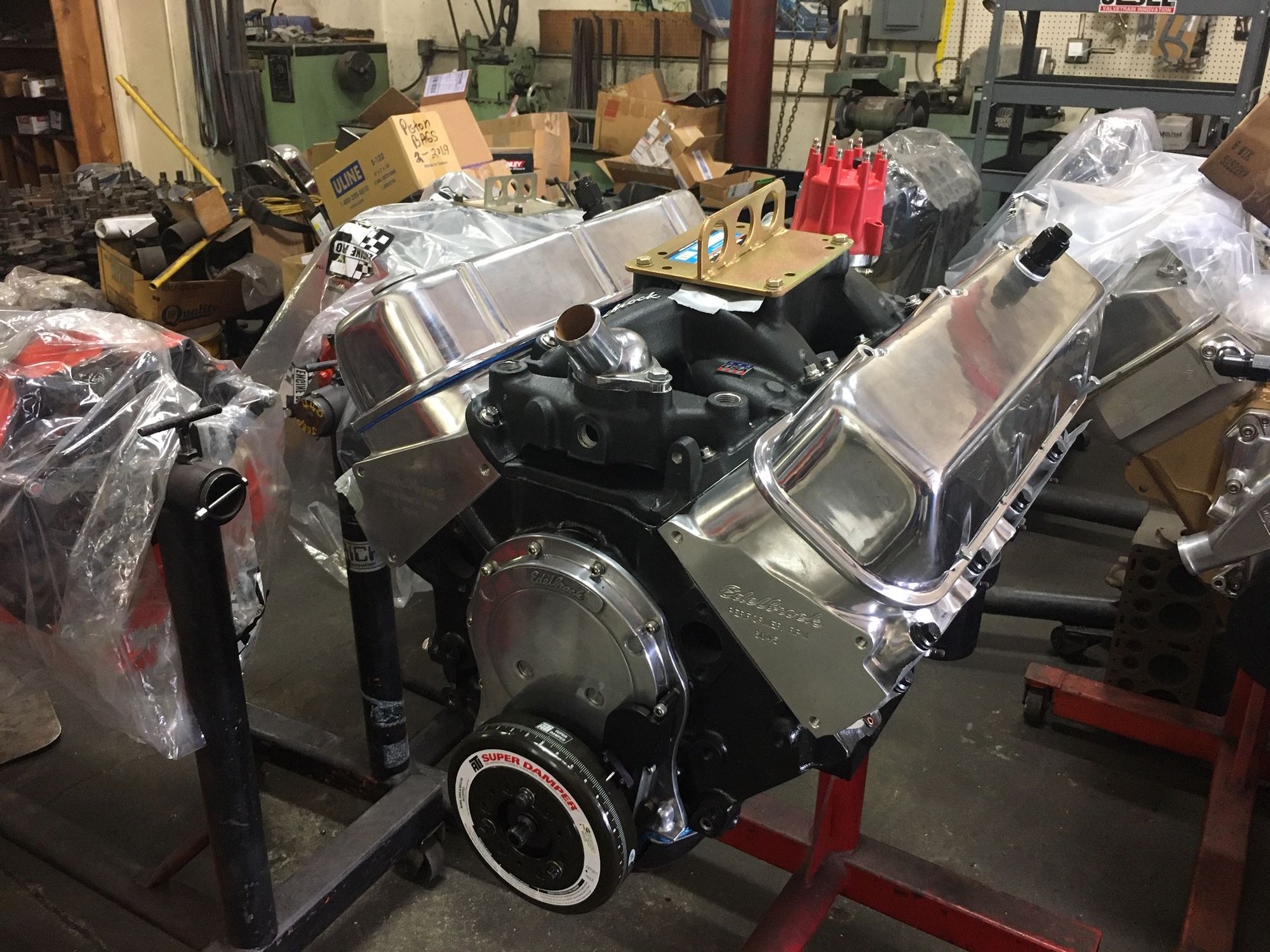

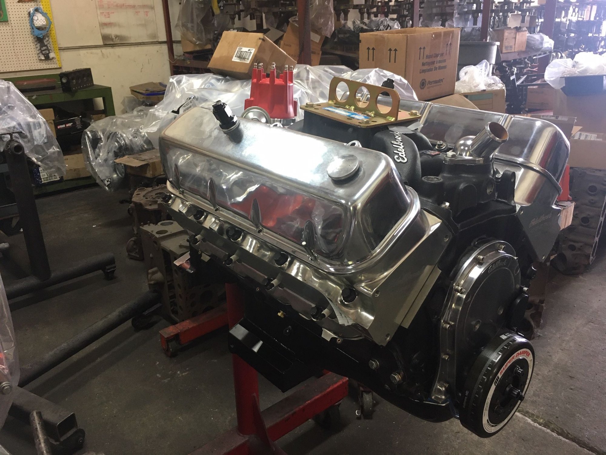

Here is a couple of pictures of my engine when I picked it up from LJ's Speed.
I hope others will post what they have and the costs involved.

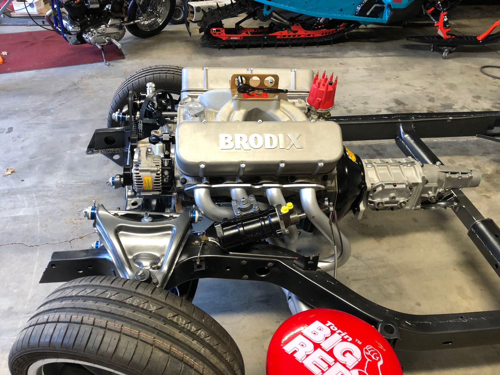

I brought Mike Lewis at Lewis Racing Engines a 4 bolt bare 454 block and that's it. And about a year later I was in no hurry, And 15,000 dollars. I got my 496 726HP on pump gas road-street engine

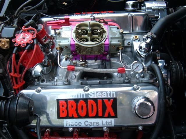

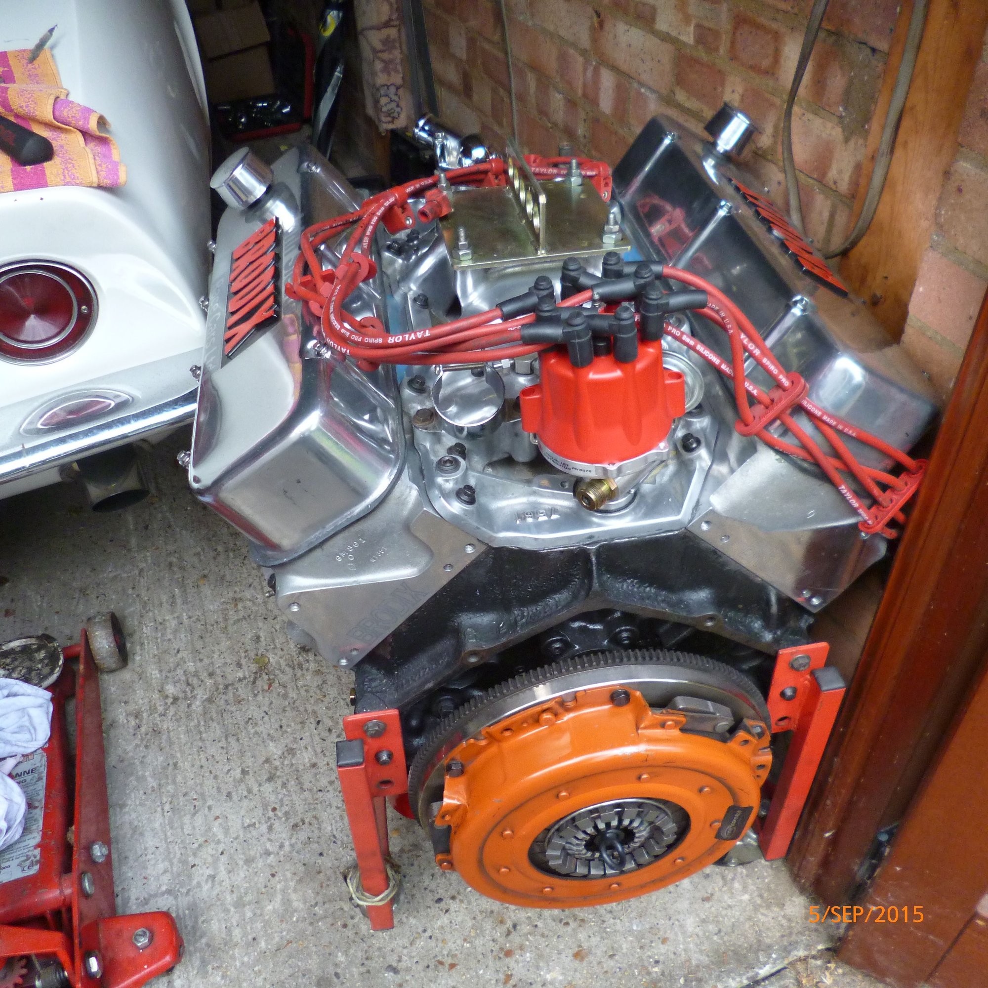

Much as your costs and spec' OldCarBum 489 rotating assy, Race Rite oval port heads, hyd flat tappet cam. I had sourced a number of the parts over a number years and didn't really keep a tally of total expenditure (no need for 'er indoors to know everything) your post has made me realise how much I most probably did spend in total - and even though some items were purchased when exchange rates were better than now (in £'s sterling) I'm guessing £15K+
