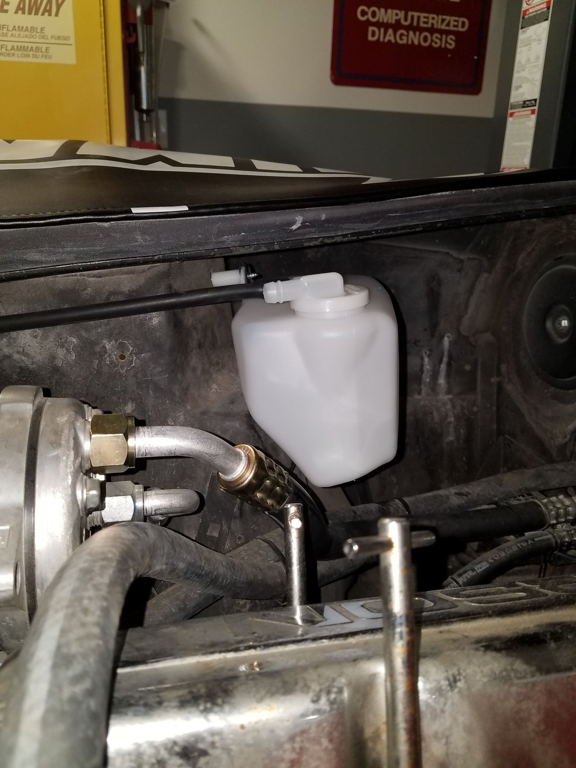

Its just 3/8" id rubber overflow hose. My rad guy gave me a piece. Any radiator guy will have it.
From rad to tank I used Gates 3/8" heater hose.

Any auto parts store should have rubber tubing you can buy by the foot.

if i wanted a new one (mine is old looking) where can these be bought?

73 is one year only, and unavailable.
You can use a 74, but you need a 1" spacer to make it work.

so after I get the new cap and install a hose, I should fill up the radiator to the top and have coolant in the bottle up to the cold fill line?
Yes
