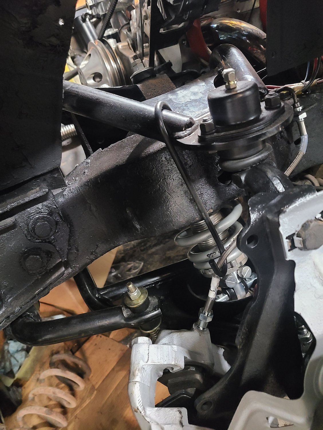

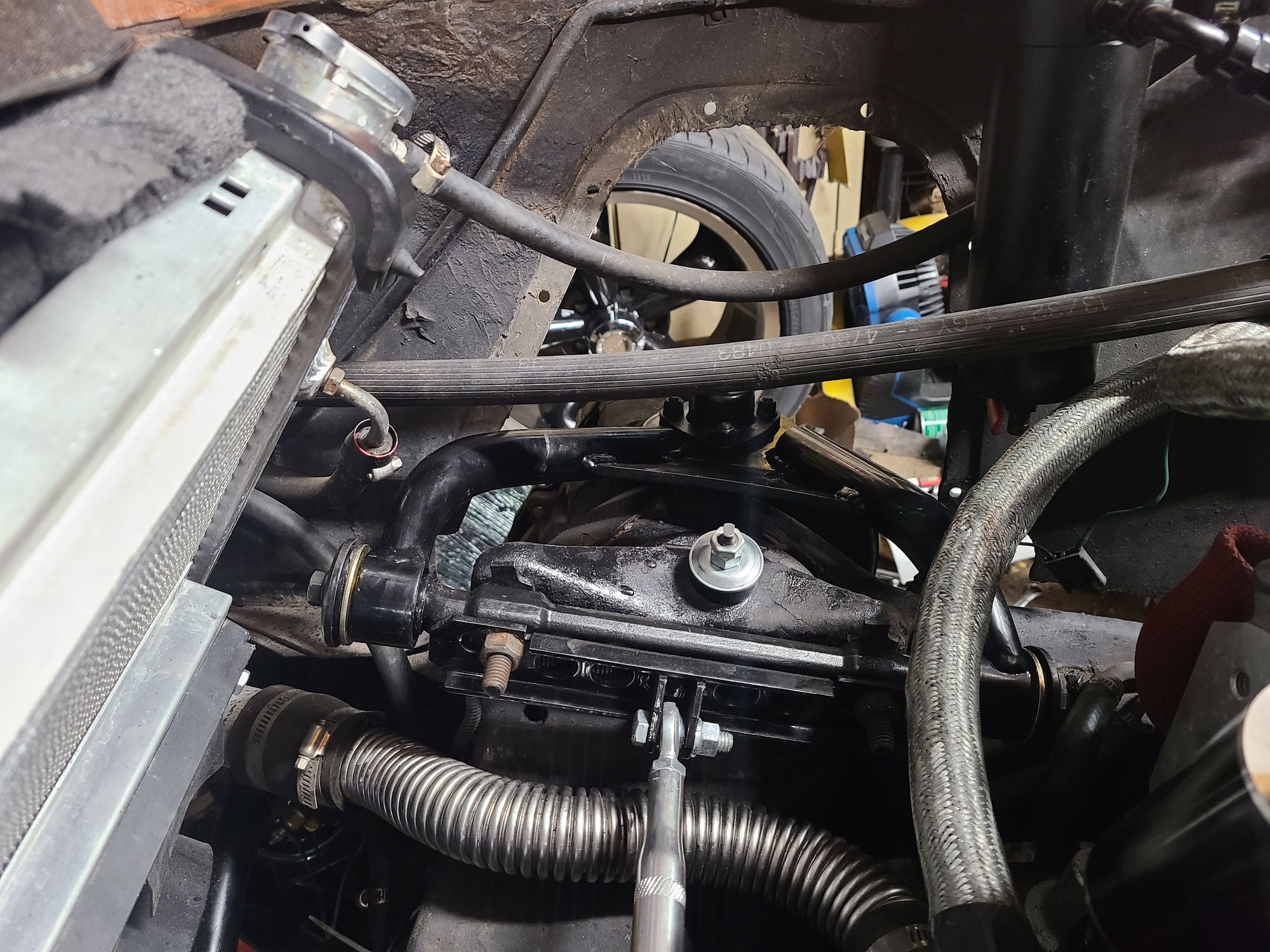

Not the best pics as I'm still working on it. Waiting for new rotors and I have to install the borgeson steering while I'm in it. No surprises so far. I decided to go with semi coilovers after purchasing the arms so I modified the lower perch on the Arms by removing the welded on nuts the base is plenty strong enough about 3/16 of an inch thick. Now that I think of it there was one surprise the tapered 500 lb Springs I bought do not fit the frame seat so I used the 350# spring I bought with the coilovers originally. I may replace them with something stiffer if I find the ride handling lacking

sorry for the late response. I am happy with these yes. these arms with the borgeson steering makes the car handle more like my old c4.
