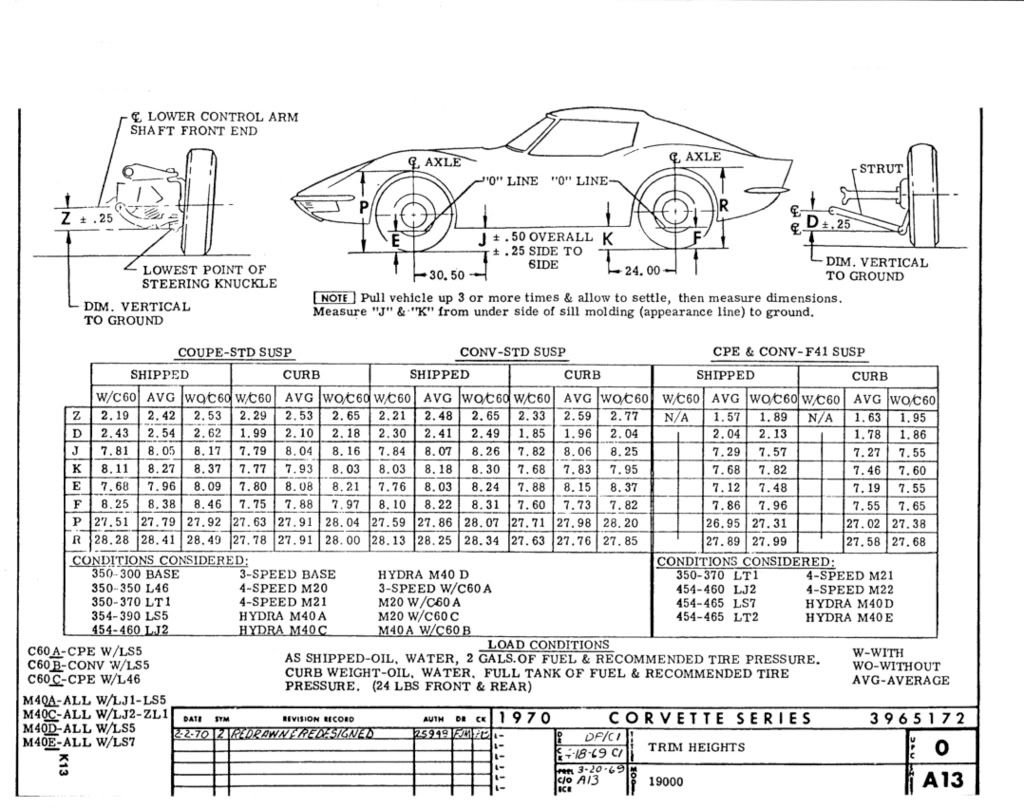

Measurments P and R is where you notice the stance. (C60 code is air conditioning.)

Good stuff. Thanks! I'll probably aim at the F41 heights as a starting point. If anyone has pics of specific ride heights to share, that'd be a valuable resource I think.

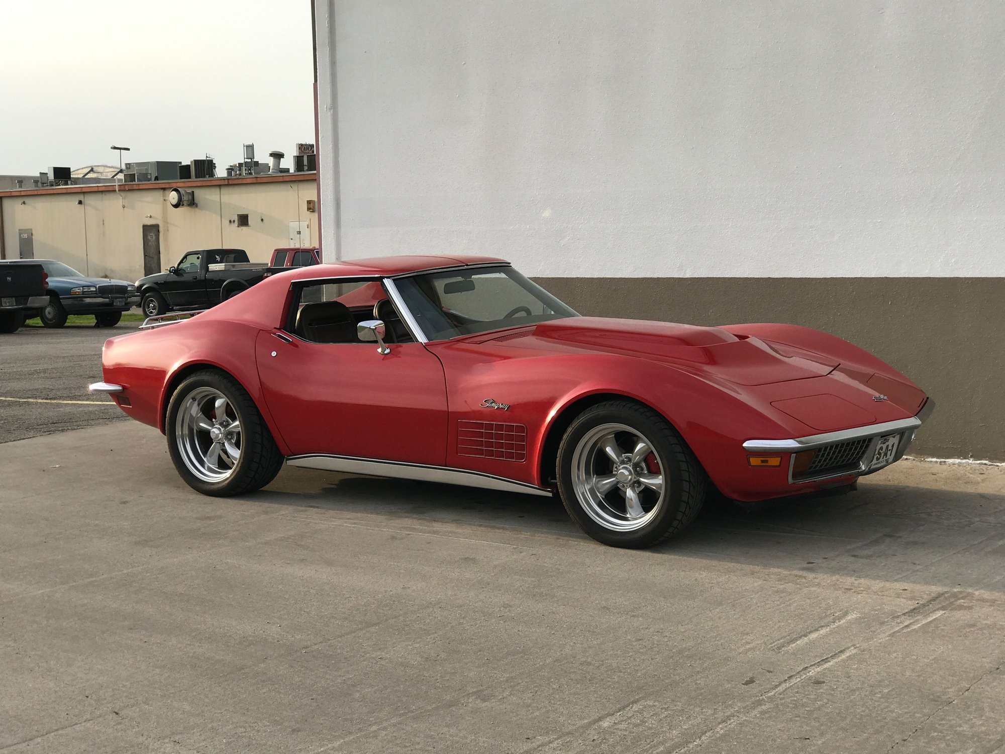

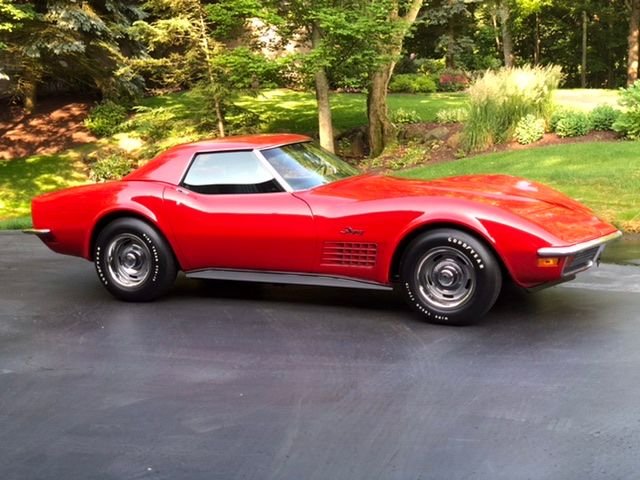

Hi Dave and WELCOME! To me, proper stance on these cars - any car for that matter - means everything. Here’s a somewhat recent photo of my ‘72 base convertible without AC. I worked hard, tweaking springs, etc to get all four corners within the AIM specifications shown in this thread. My tweaking has brought the car to between nominal and high in what I would say are a GENEROUS tolerance range as specified by GM engineering. What was “good enough” then would get someone fired today.
Hope this helps.
Don

Here's an easier to read set of measurements - and year specific:
https://tech.corvettecentral.com/201...-height-guide/
Note that these are measuring the clearance to the frame between the wheels.

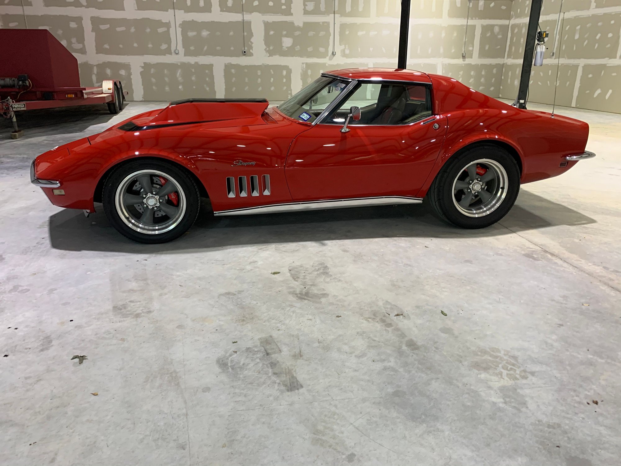

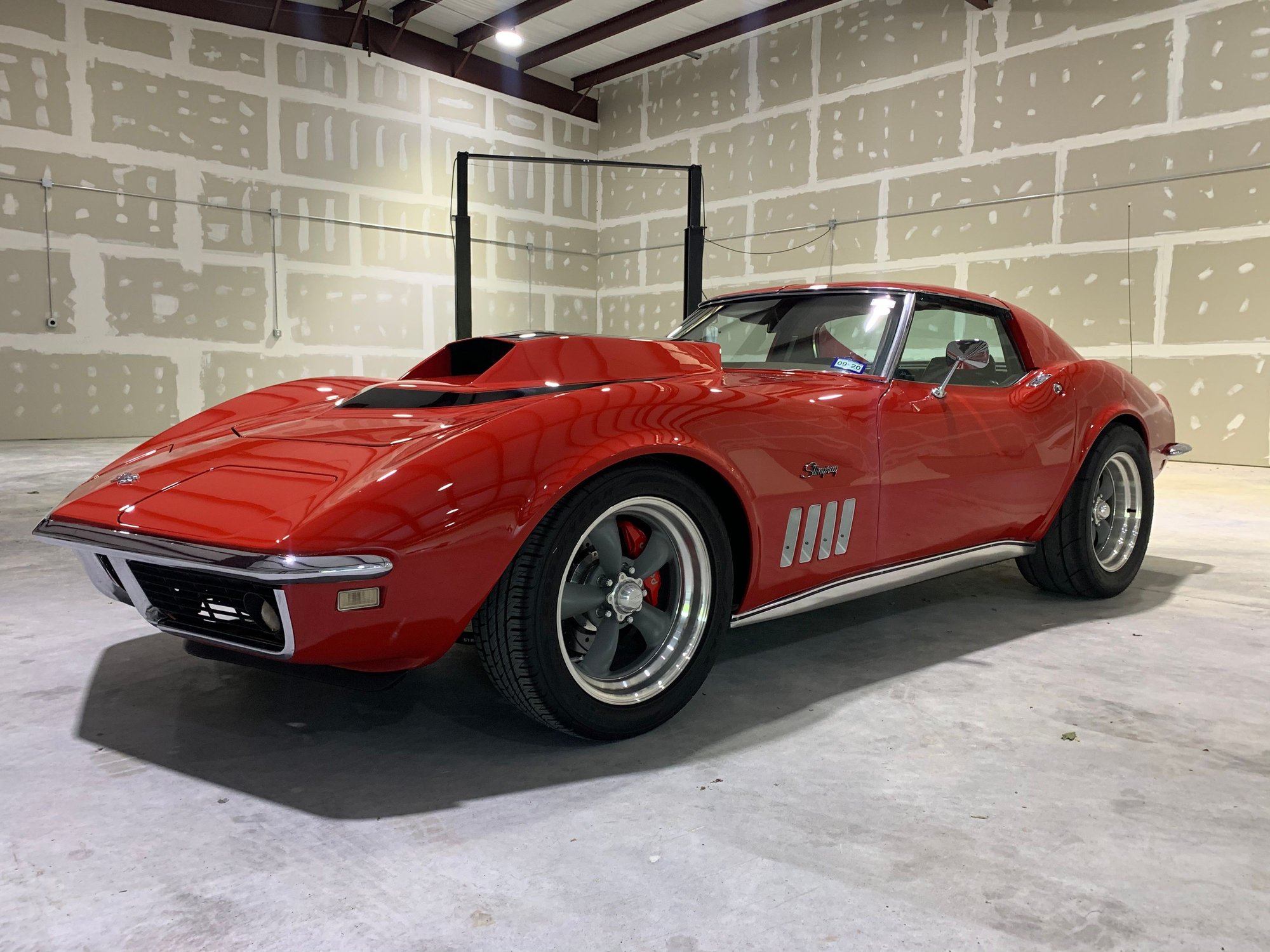

I went 27.5" all around......VB&P adjustable.....F&R. I think I want to drop the front a smidge.....
Jebby
Jebby
Looks great. Tire size?
245/45/17
275/40/18
Jebby

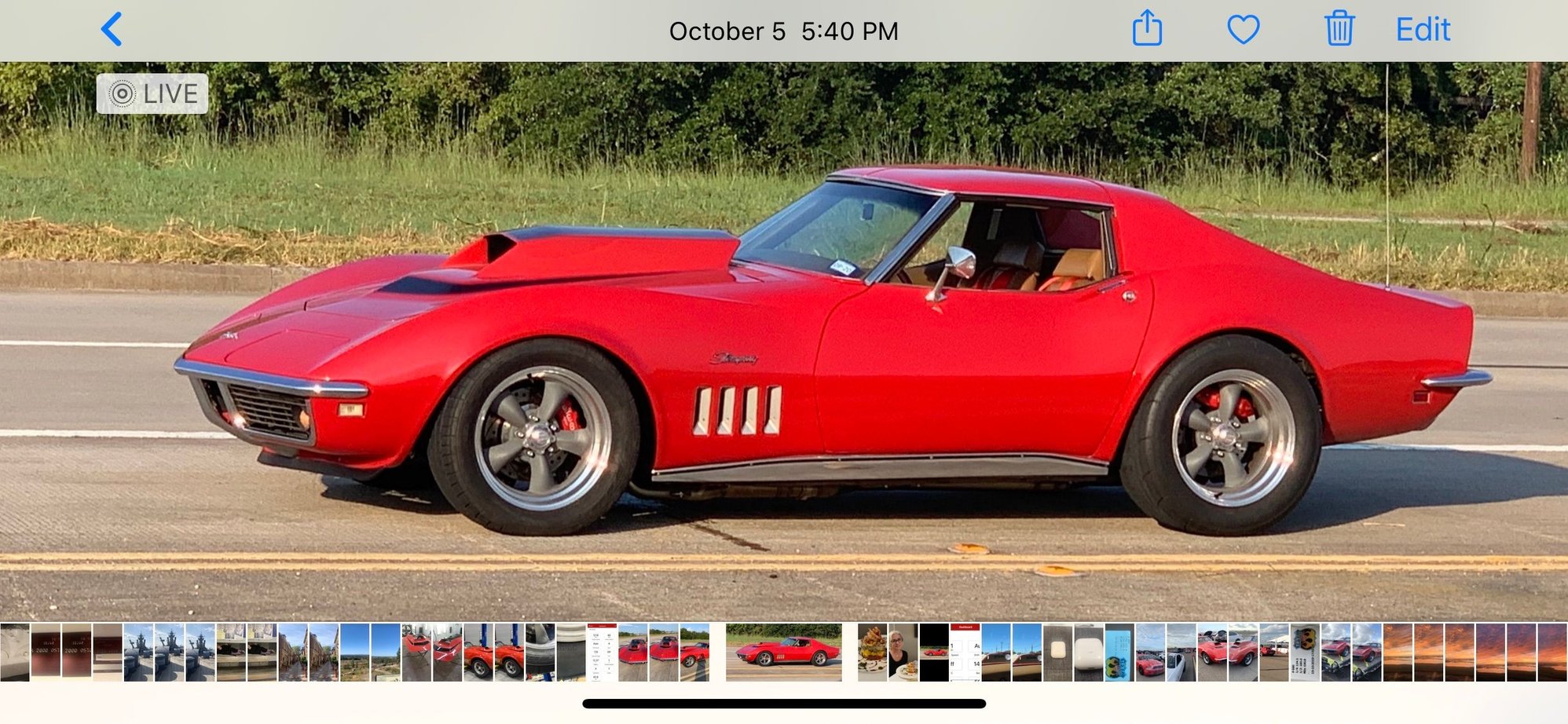

After my last rebuild, we used all Ridetech suspension and coil over shocks for adjustability. Ultimately happy with the outcome.

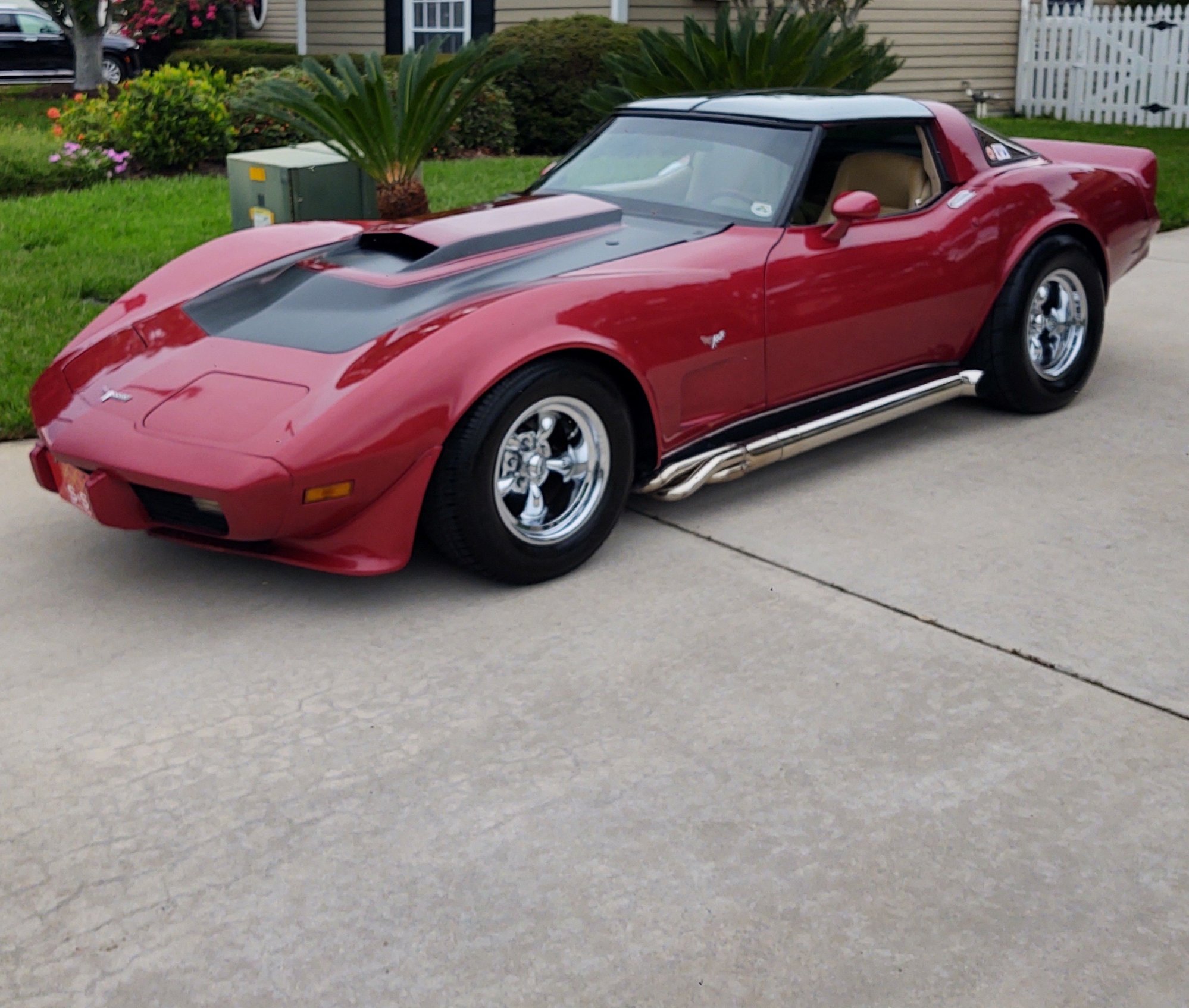

My 73 with Global West Tubular A Arms and Viking Dual Adjustable Coilovers in front and Viking Dual Adjustable Shocks with 9 leaf rear spring modified by Eaton Detroit in rear. Am 26 1/2" in front and 26 3/4" in the rear. Tires are BFG 255/60/15 all the way around.

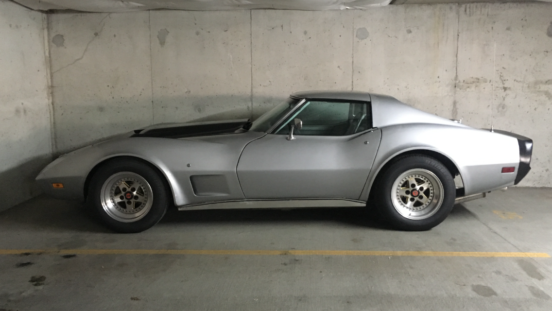

Here is my stock suspension 72 with the same size BFG's on it. I haven't measured the ride height but I can if you like.
Brian

Brian, your 73 sits really nice. Looks like the 72 sits a little higher in the back? Maybe just pictures?

love the red cars. Jebby yours looks real good to me.
This is my 76.It has been shared a few times I guess I need a new background. Maybe Ill take a cruise later and get a light house behind it. It has VB&P adjustable front and rear also. Tires are Michelin Pilot Super Sports 245 40 18 front and 275 40 18 rear.

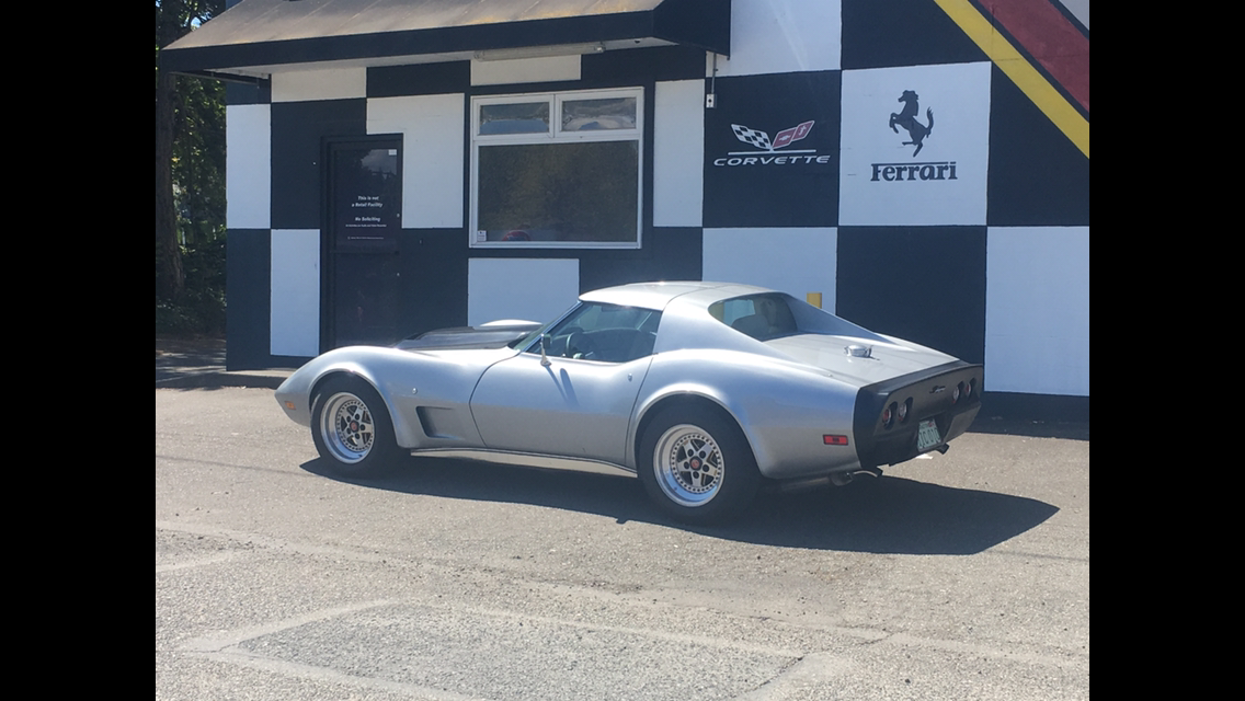

My black 72 above is 27 1/8" front and 28 1/4" rear sitting in the garage.
Brian
