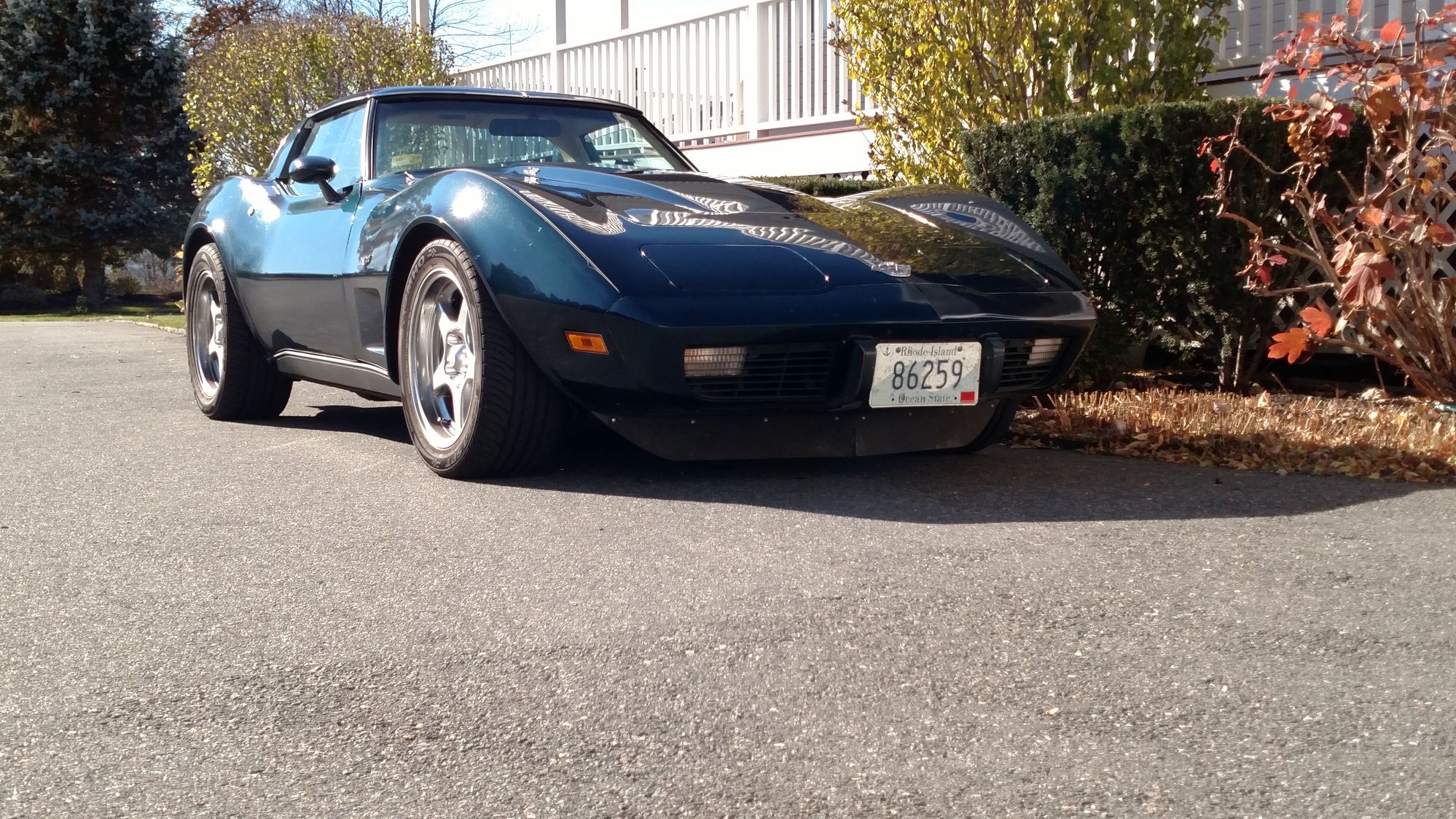

See, this is what I'm up against. Looks like a bloody 4wheel drive. Factory original springs. Pretty sure there not shot. Lightening up the engine made a huge difference. Those are 255-60 /15's . Should fill in that fender better than that!

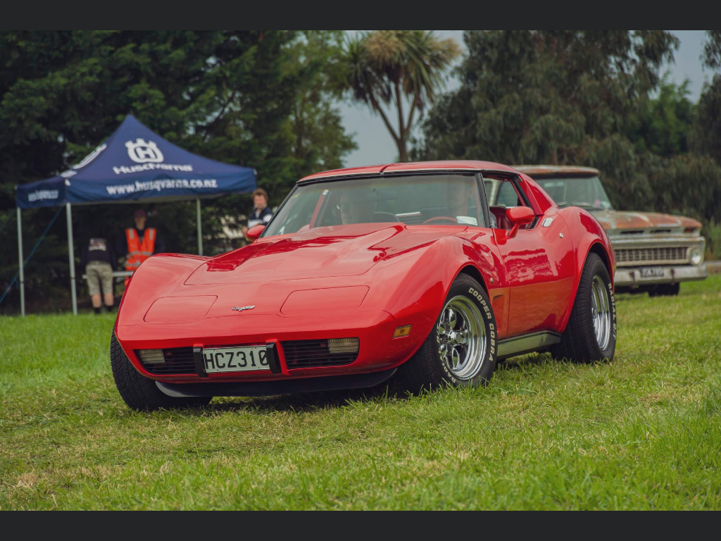

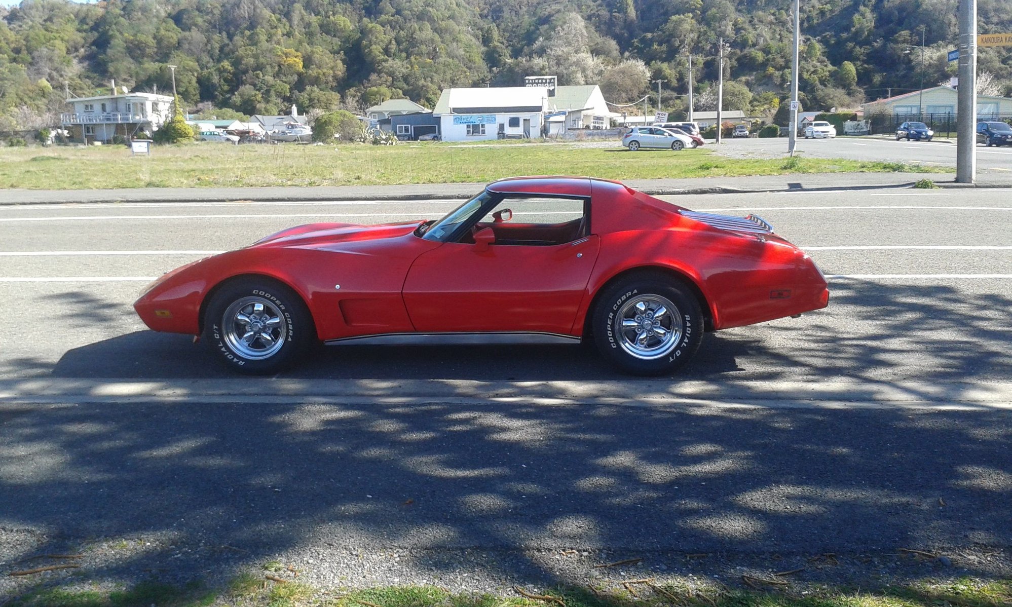

Hi 4-Vettes,From across the Tassie ..I cut a whole coil (not gymkhana)and the front end dropped 40mm which gave me better wheel clearance (was rubbing) and the coil sits in the pockets correctly...Drives and handles away better
In the rear end I got C4 bolts 10" and cut them down to 8 1/2" drilled them and used castle nuts(dropped 45mm)...they look stock and I didn't trust the nylon ones!!

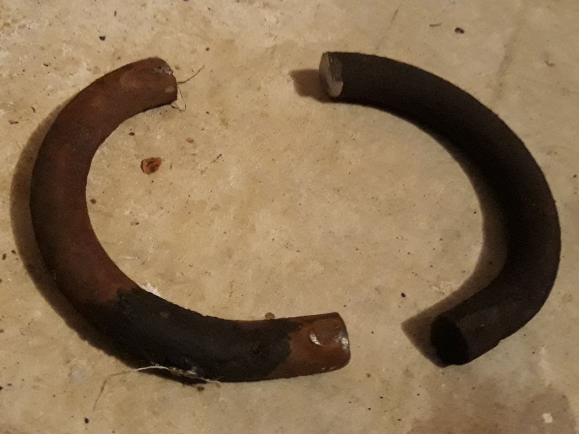

Well, I got this far today.
1/2 coil cut off the bottom of each spring.
Crawling around on the floor isn't much fun for an old fart like me. So another day I'll get it back together and see how she sits.
