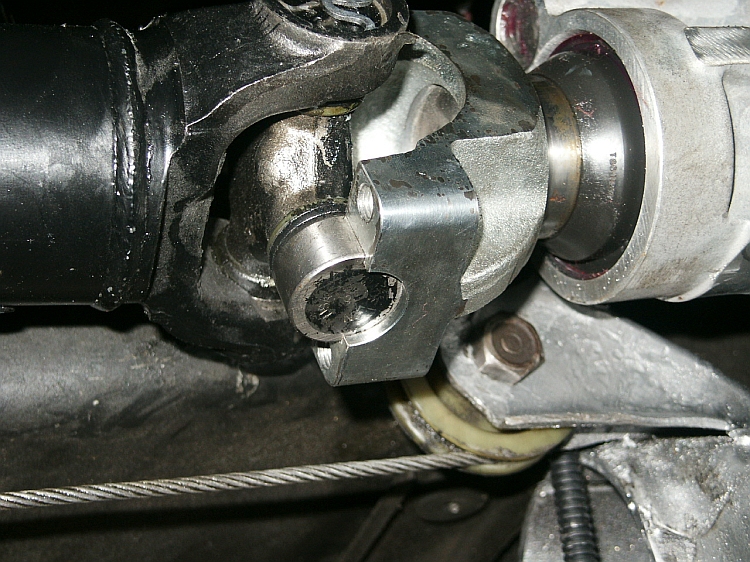

ordered 6ea 1350 series for half shafts and drive shaft.. Drive shaft is from a TKO 500 from the differential to the transmission. Not 1350, measures 3.625 X 1.64 and can find no corresponding size on JEGS. What series is this?

Roger that, re measured and missed a digit 1.065" end cap measurement
Couple pics for your enjoyment...

My TKO600 came with a 1330 output chromemoly DS and billet caps with 12 point bolts from Keisler

Thats a nice setup on the end caps, my car is set up for road racing so dont need hole shot torque. Going with Spicer solids and more secure fasteners similar to yours anyway. Just because I can. Last name is DunCan heheheheh
