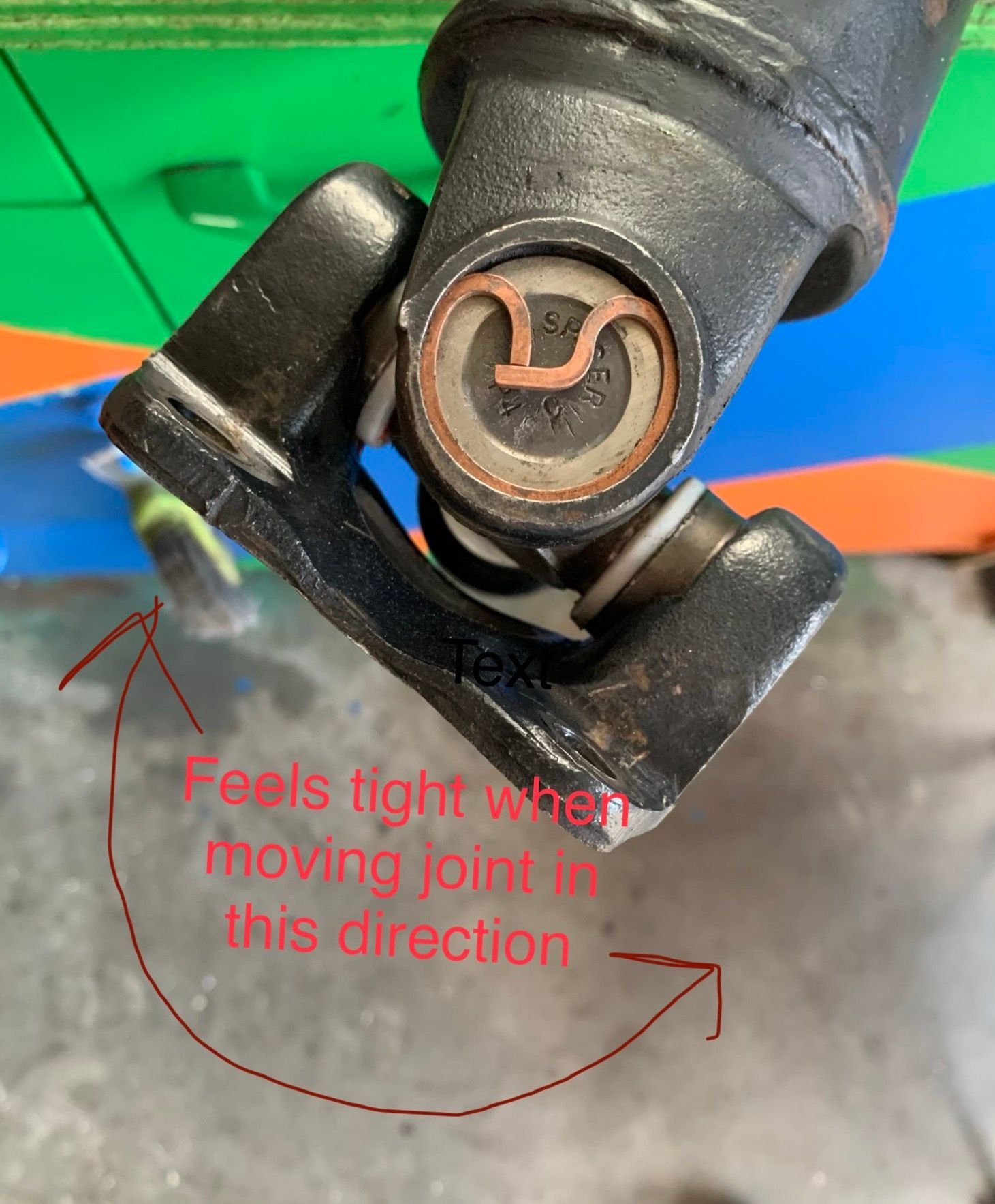

I am re-doing the entire rear on my 78. Recently had rear differential re-built, all new bushings in trailing arms and strut arms, new spindle/hub bearings and new moog greaseless u-joints on the half shafts. I took the diff and the rear bearings to Dub and those are good to go. I also have new rear tires. I assembled everything and took it for its first test drive and didn’t go faster than 8 mph. An obvious click sound and feeling as the tires rotated. Jacked it up, put car in neutral and both rear wheels stuck every revolution while I rotated them by hand. Took half shafts off and they seem tight where they attach to diff yokes. I think the tight u joints is my problem, but don’t know how to resolve this? I’ve read threads on here, but aren’t savvy enough to understand ‘Tap the caps between the clips with a hammer’. The wheels rolled good until I took the jack stands out and put tires on the ground. Any input from this awesome group of vette owners on how I get this inherited Vette rolling again will be a huge blessing! Trying to finish it for my dad. Thanks!

I’ll keep you posted, but tapping on the weld of the half shaft fixed the tightness. I’ll put it together and may need your expert advice again. (Hopefully not)

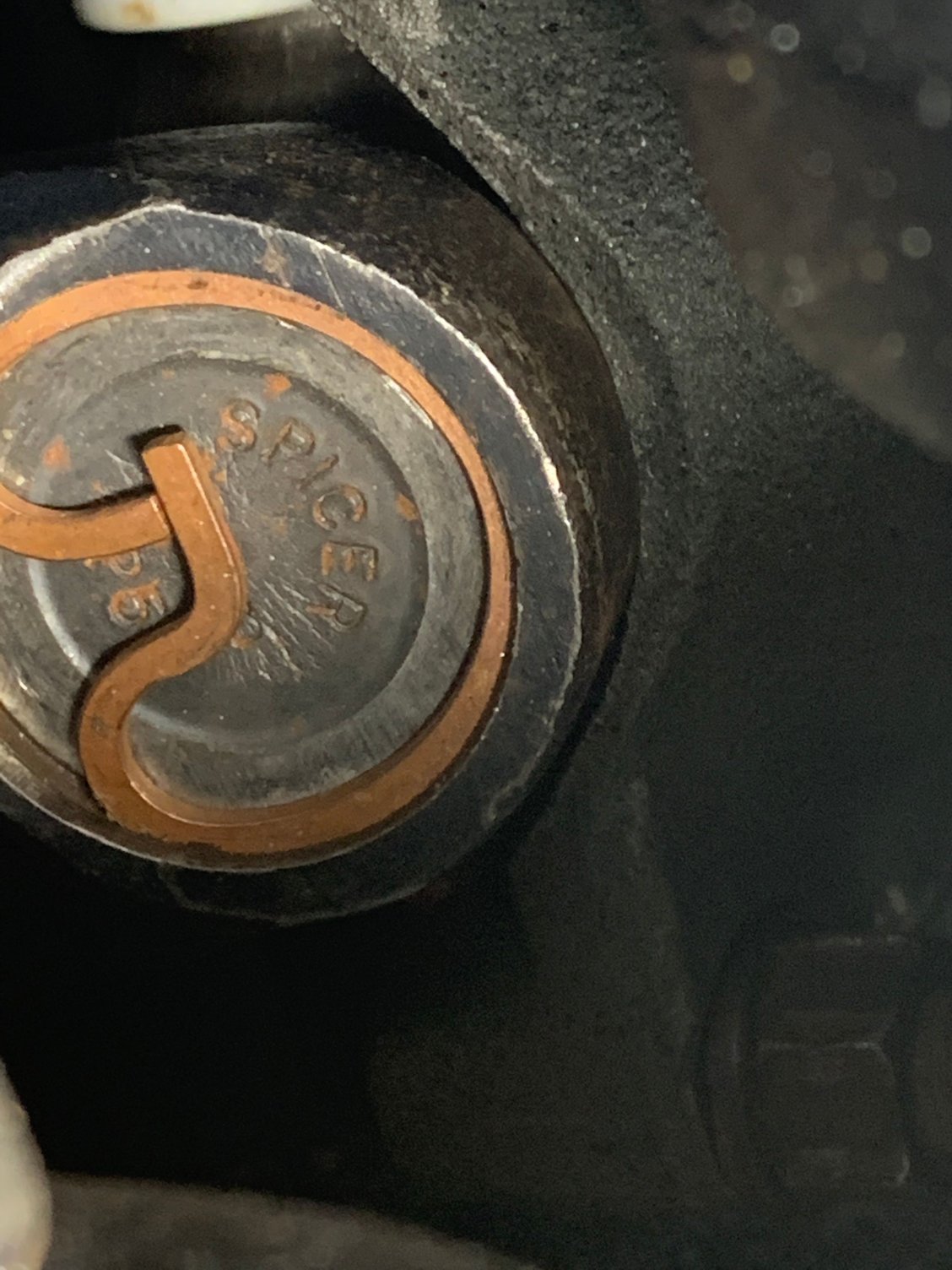

ended up fixing the tight u-joints with a what from a hammer. Put it back together and still sticks every 1/2 revolution of the wheel. Took the wheel and rotor off to be sure and still does it. After taking a closer look, the half shaft binds at the brand new diff yokes. I honestly do not know how to remedy this... this literally stops the wheels from turning when it’s on jack stands. (I do have a jack under the spindle to simulate that the car is on its wheels).
any ideas?

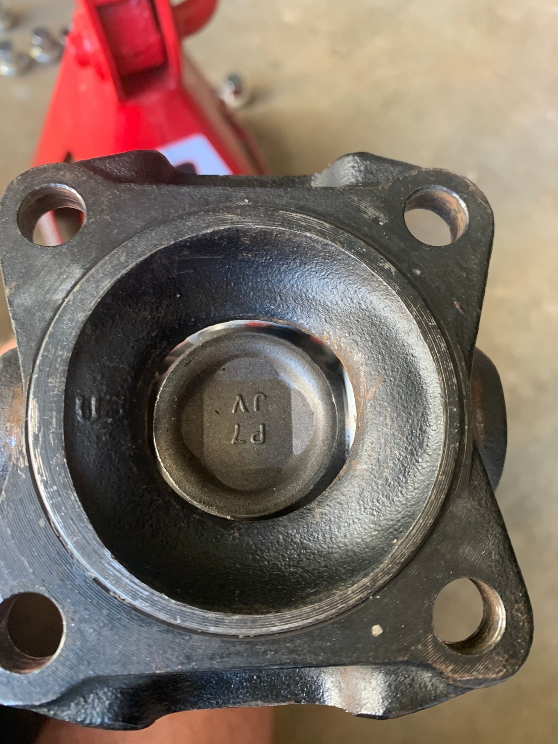

We need to make sure rookies like me are aware that that the u joint flange at the hub and the hub flange is shaped in a way to only enable the u joint flange to be installed in only 1 way. The flange has a lip that is shaped in a way that is thick on one side and thinner on the other and it has to align with the opposite on the hub connection. Fixing this rookie install mistake fixed my rear vibration and awkward feeling when it rolled at low speeds.
