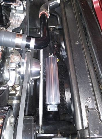

Update: Heat shield around steering box dropped temps and steering seems better after a trial run. I'm installing a inline PS cooler this week (Thanks bfit for the idea) and hopefully that will help as well. I'll post back with results.
Old Jul 16, 2020 | 08:38 PM
Bloodzone's Avatar
Bloodzone
Joined: May 2014
Posts: 884
Likes: 128
From: Rhine Georgia
Update 2: Installed PS Cooler, flushed system and switched to a quality synthetic fluid. Its much better. Play seems to be gone. I can't say for sure till I take a longer trip in the heat of the day. I've got a trans cooler in front of the radiator so I installed the new PS cooler on the front cross member behind the radiator.
