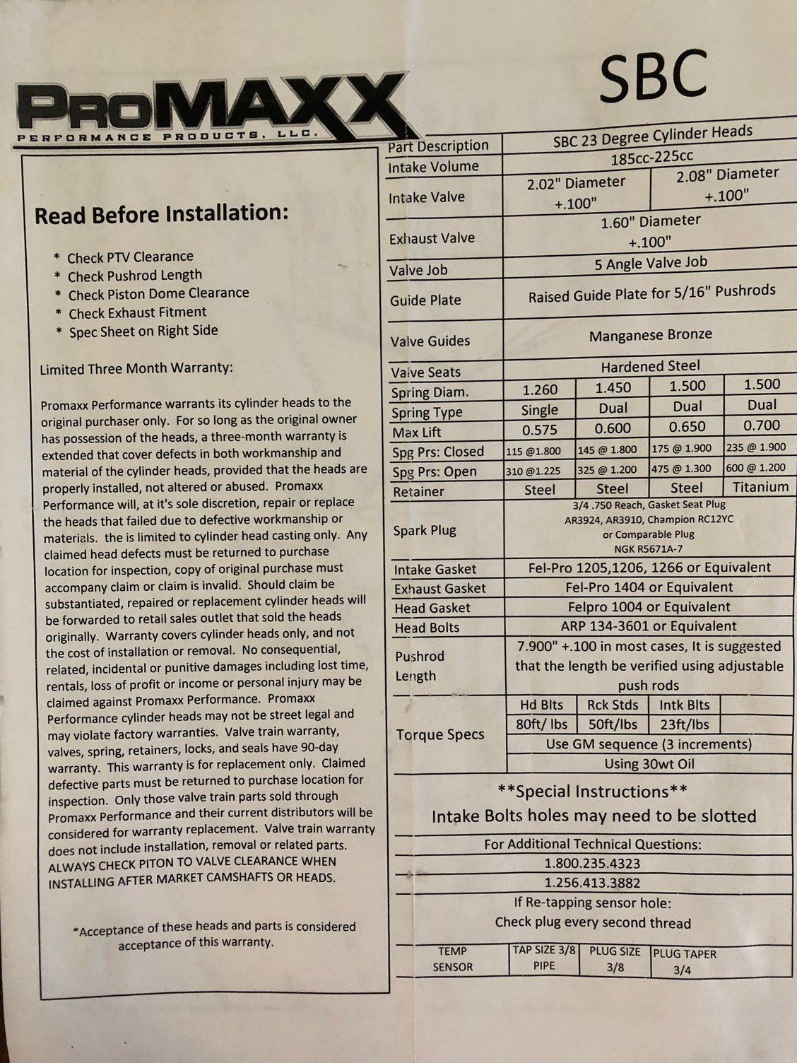

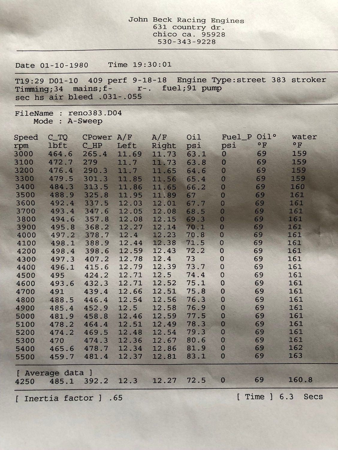

383 These heads and this cam.
these are the 185cc
these are the 185cc
ANYONE that dyno's a cold engine is a POS. And to abuse a customer's car in such a way? Despicable.
It was at temp on 100 degree days it runs 170. It was far from cold

I see 159 to 163....wish my car stayed that cold, mines right around 180 at temp....I see that there’s no fuel pressure So it’s a magic engine......maybe this snowflake is confused or it’s the 69 degree oil that he saw, which is obviously not connected either....
guess he’s just getting excited about nothing so he can feel good about himself...very confusing
