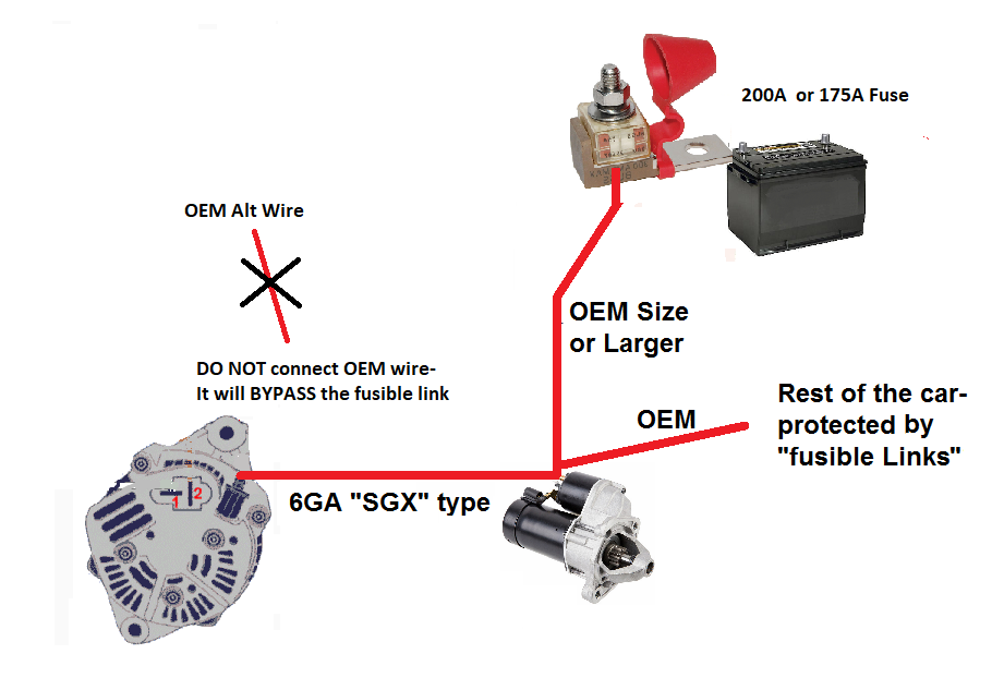

Originally Posted by Big2Bird
Do you have a drawing for "twin alternators" from O Rielly's?
Will this suffice?

FWIW, my stock alternator couldn't even keep up with high-beams. Knowing I was going to add more electric components, I went with a 3-wire 150A 12SI Powermaster alternator. It does fine with the dual electric fan setup I added later. My wiring is very similar to what @Richard454 shows in post 7.
