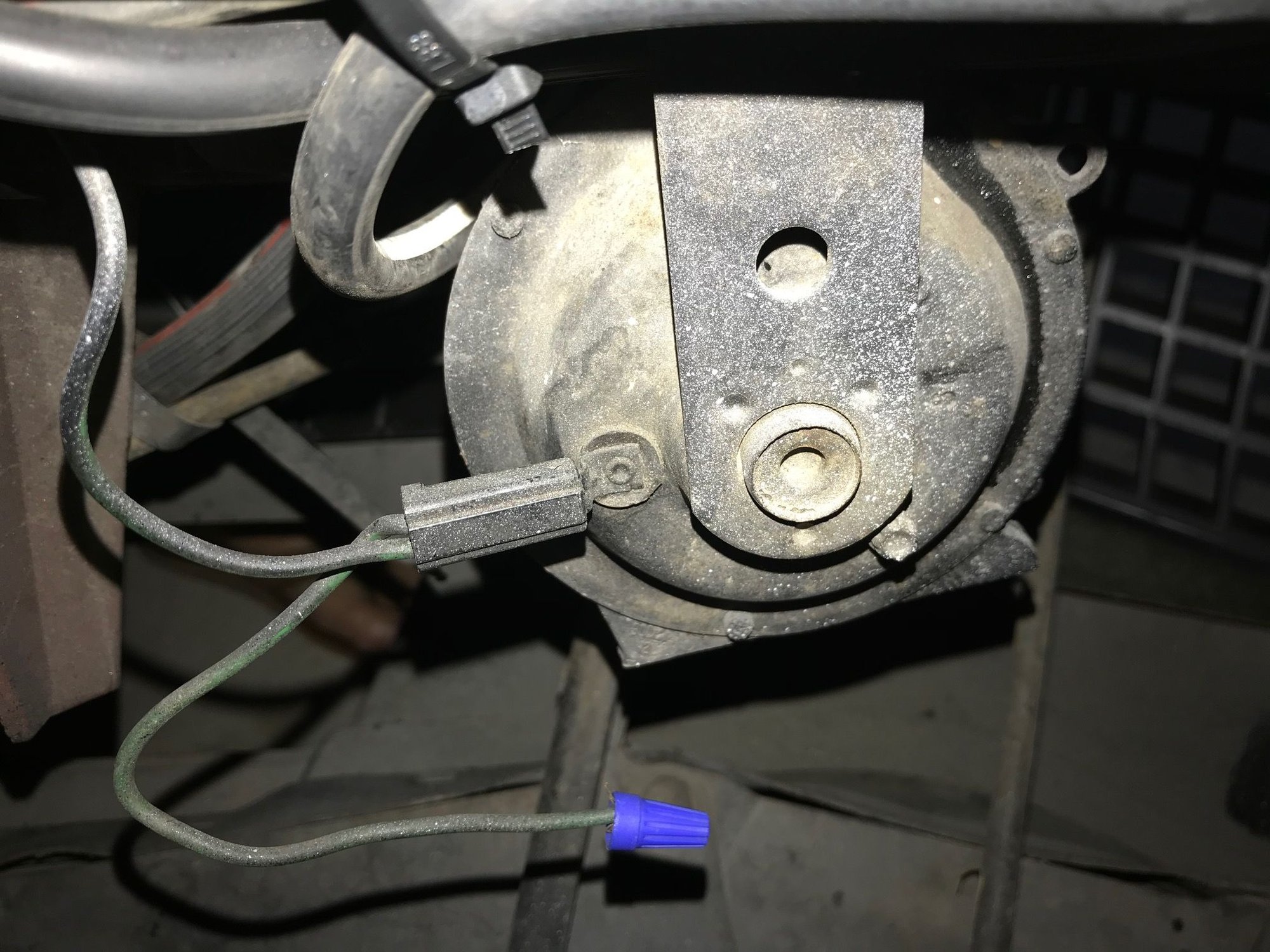

A pic of the horn. I looked at the wiring schematic - is the the second green wire supposed to be connected somewhere as well?

I believe you should have two horns.

2 horns plus you need to shim the horn contact in the steering column

Thank you - does anyone have a pic showing how both horns are mounted so I can install the second horn?

In 1970 models all Corvettes came with two horns. 71’s came with only one. A second horn was an option.
