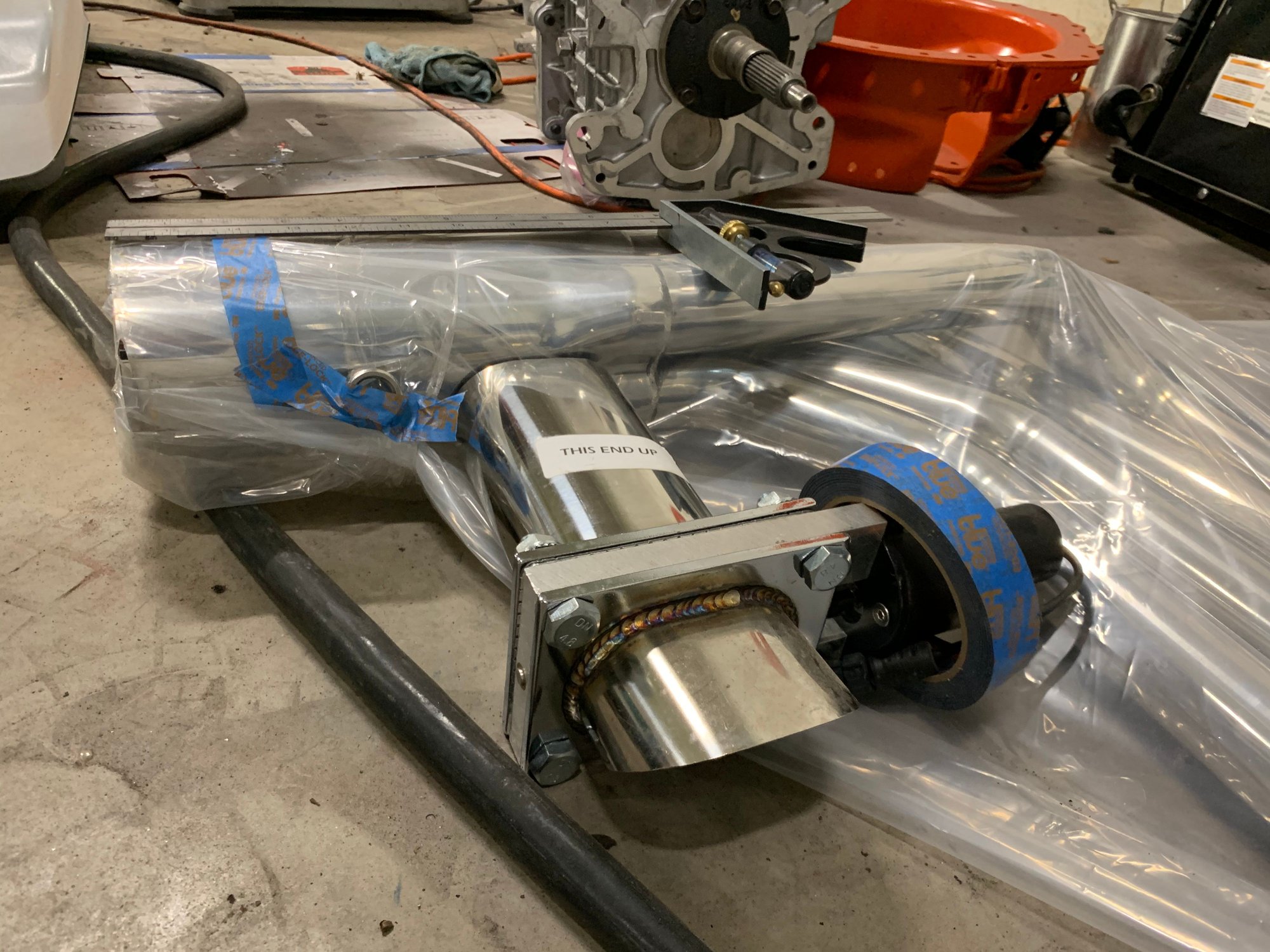

I bought these 3” QTP electric cutouts about 3 years ago to put on my 68 Hemi Cuda to make it more “streetable”. I also bought the biggest Spintech oval exhaust sections and “street” mufflers to keep the flow less restrictive. This to replace the existing Spintech exhaust which is ceramicoated. Since the new exhaust wasn’t ceramicoated and since I decided that this was too much of a drag car for the street the exhaust has been sitting. I just can’t handle the constant whirring of the high stall converter.
exhaust is presently Spiral baffles and they will be capped.
im worried about turbulence giving a bad o2 reading. Thoughts?
I also have the heat shield straps to contend with.
I would turn the motors to the back and possibly angle cut the cutouts to angle back more too.

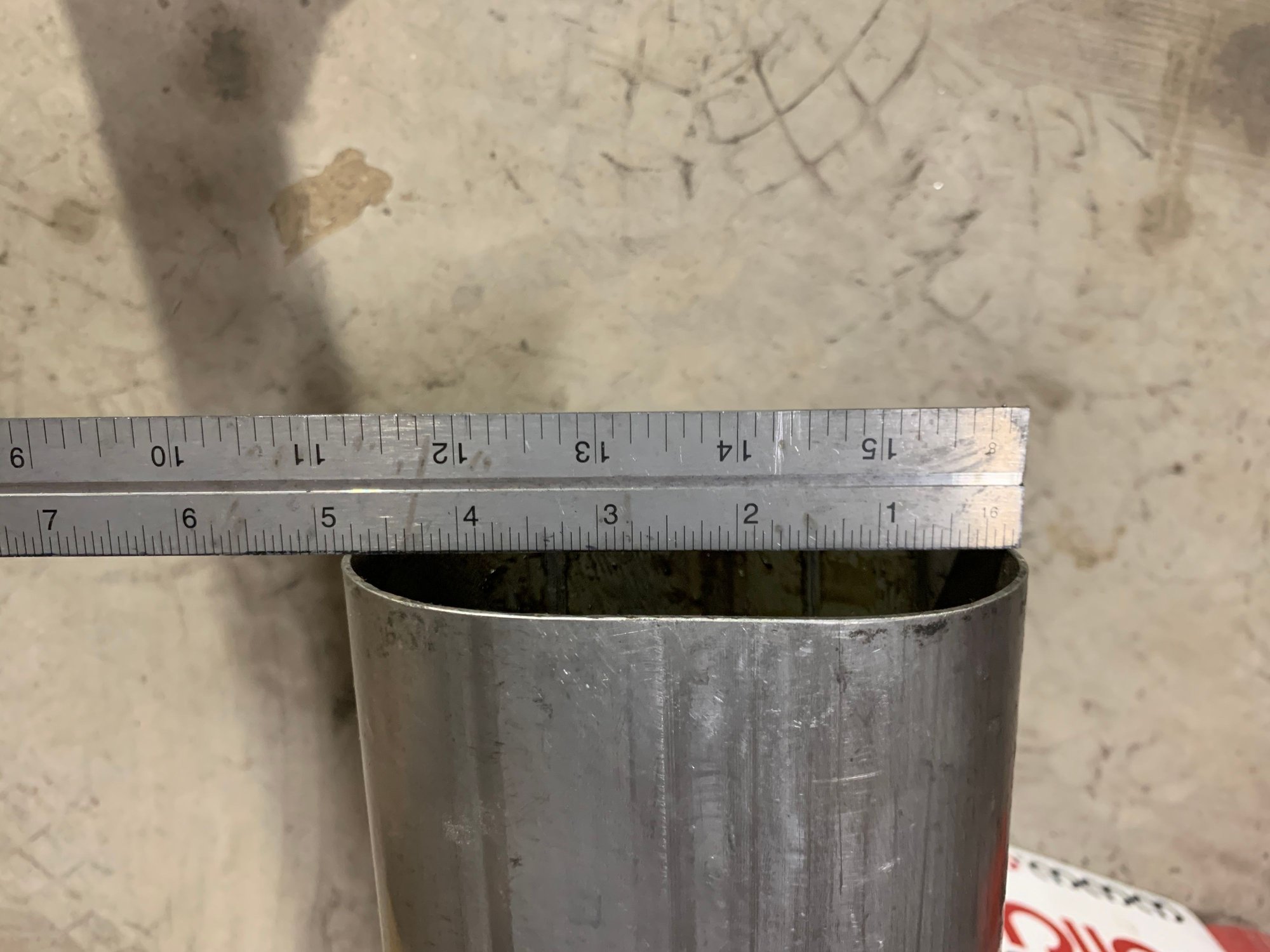

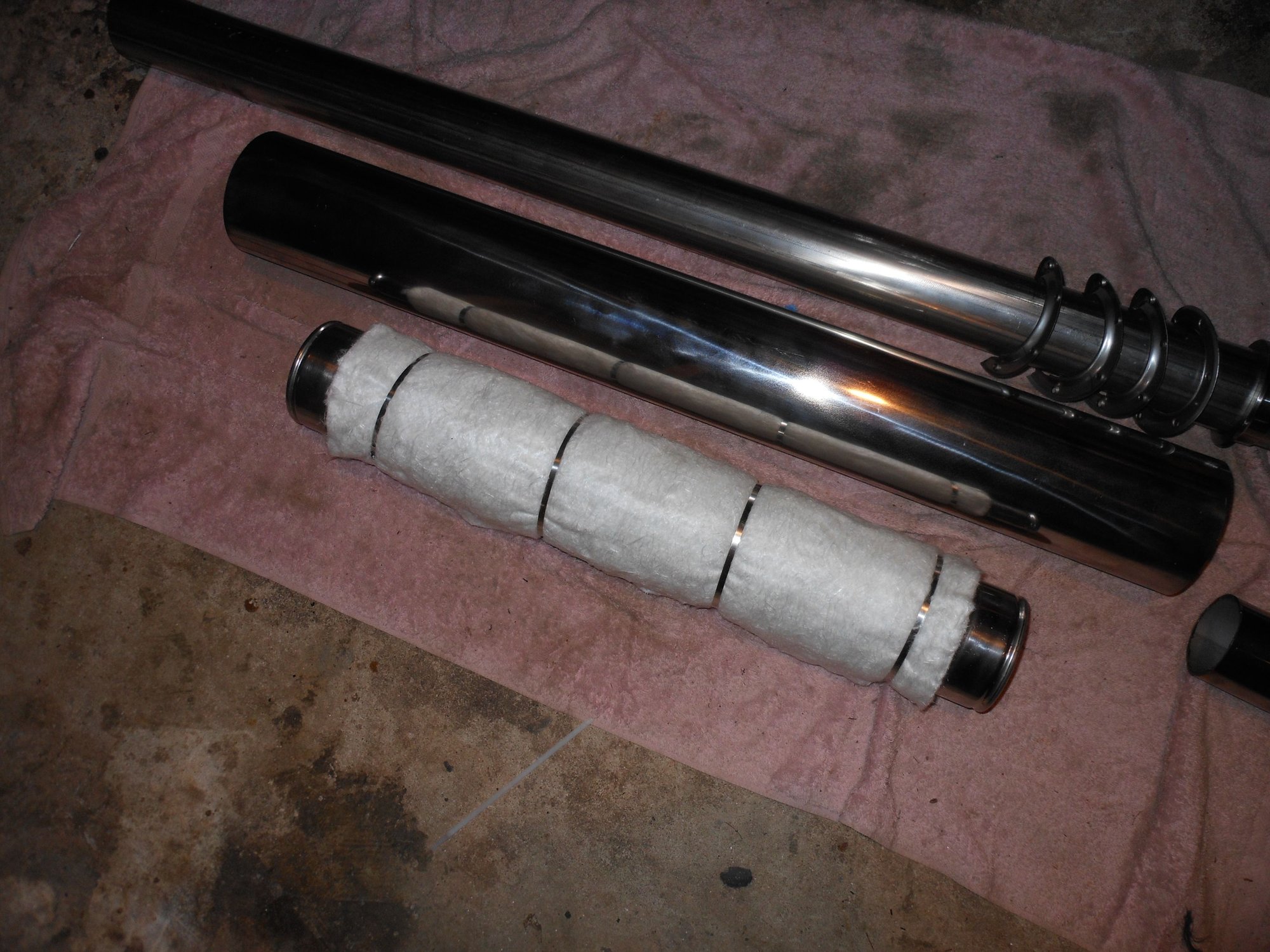

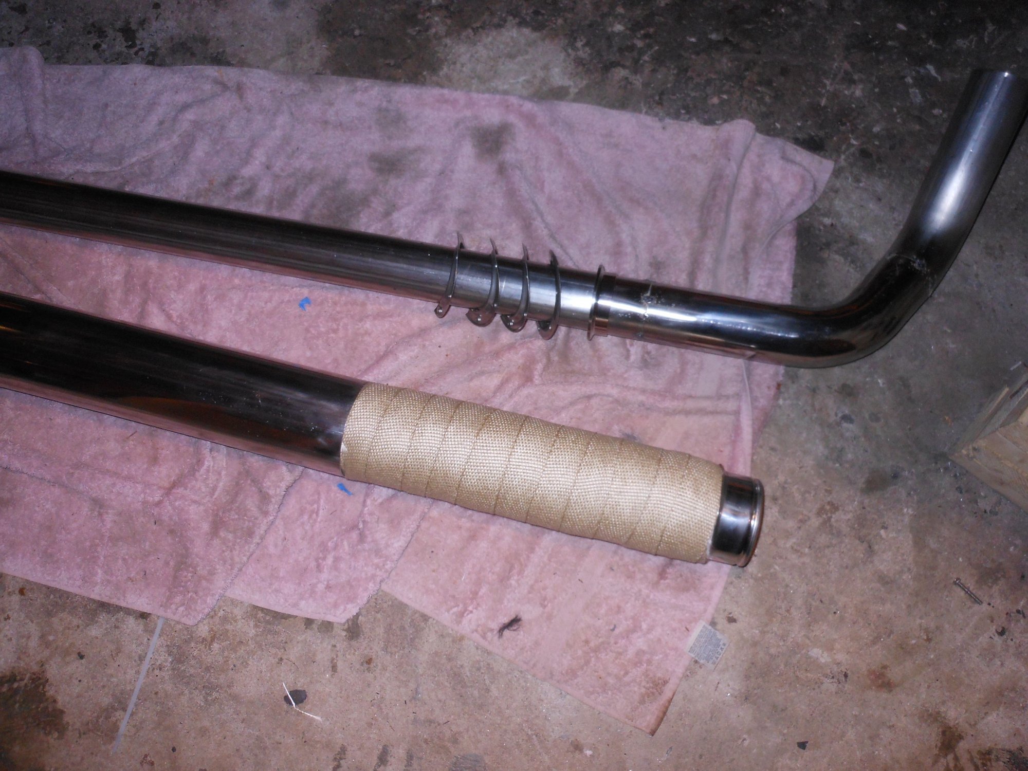

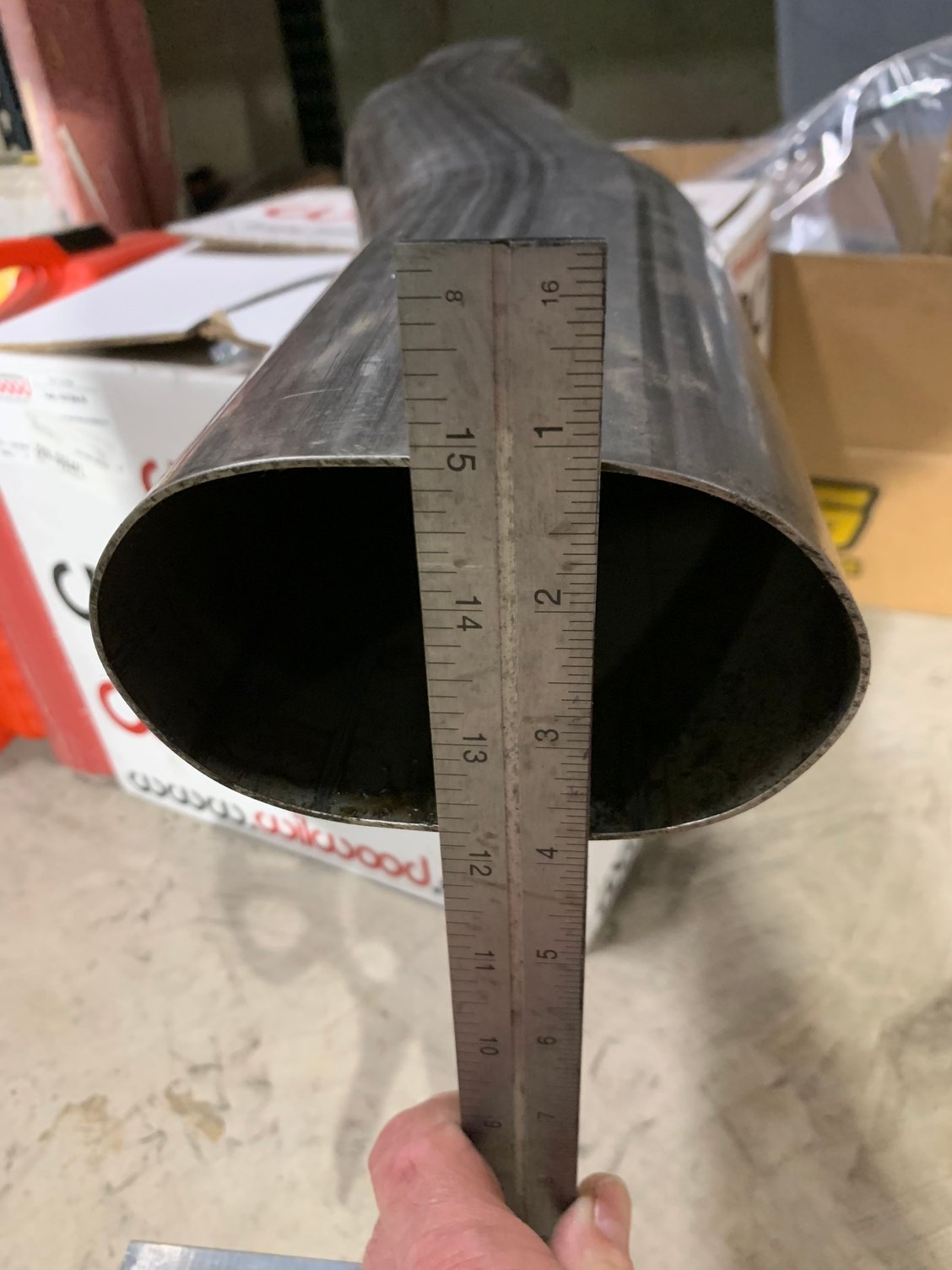

Pics of the exhaust I won’t be using. It’s for sale by the way, lol.

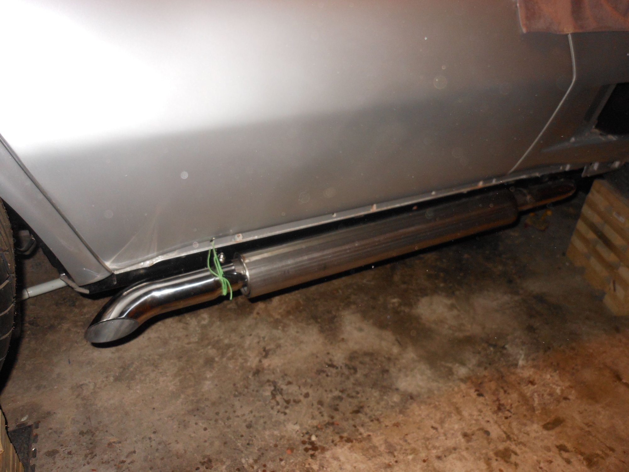

Here's how I handled -cutouts/O2 sensor/ with sidepipes-
Have 2½" straight pipe- and when I close (variable) the straight pipe the exhaust will flow through the outer muffler. So I have the best of both world at the flick of a switch.
Plus the O2 sensor is not affected by the opening/closing of the cut-outs

No...I whipped them up in a weekend...OK maybe only a dozen weekends!!! Have you every drilled a bunch of holes in 304 SS tubing!!!
Right now- I have them under some fiberglass OEM Factory replica pieces that have been chromed.
I do have a set of Factory covers that I'm going to use when I finish restoring them.
test fit
