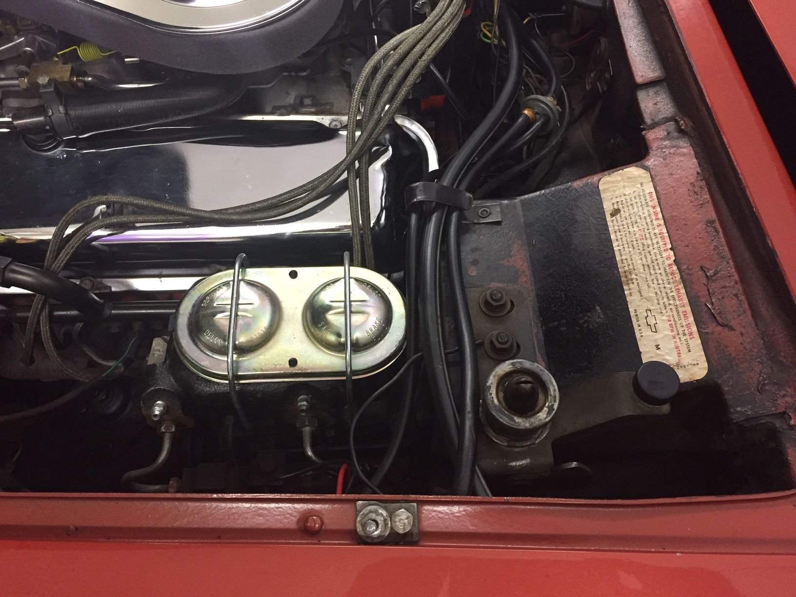

The '68s don't have a hood switch, but I do as I have an aftermarket alarm on the car. A bit of an explanation. I bought this car in '83 from the original owner. He added an alarm after he got it and I disconnected it. I sold the car to my brother-in-law in the late '80s and then bought it back from my sister a couple of years ago. Since it was in great shape with 24K miles, I decided to take care of all the small problems and just clean it up. So for the past few years its been on jack stands with the hood open most of the time.
I was working on some interior projects so closed the door so the buzzer stopped when the ignition was on. That's when I noticed the interior lights didn't go off. After reading your comment on the hood switch, I closed the hood and the lights went out. I had thought the alarm was disconnected but apparently the hood switch is wired to the interior light switch. Feel kind of dumb about this one, but thanks for your help.
