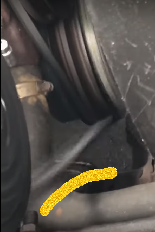

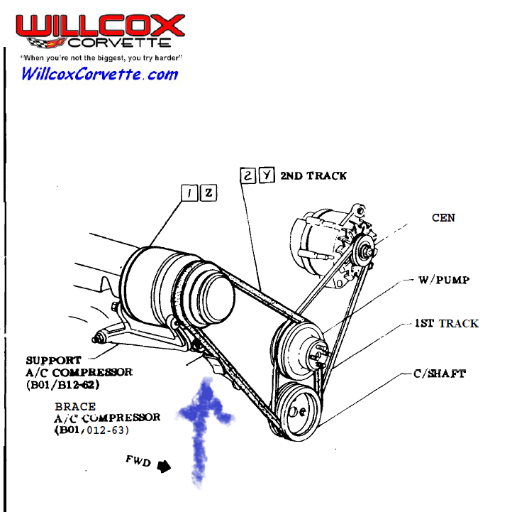

Originally Posted by 71chimera
does it have a shield to prevent leaking oil from being slung up & onto hood? to prevent oil from soaking into fiberglass hood.
i have never seen that.. not sure what year OP is.. but i have deflectors at alternator and AC belt..like in this pic of OP area.. no clue if his had originally..
