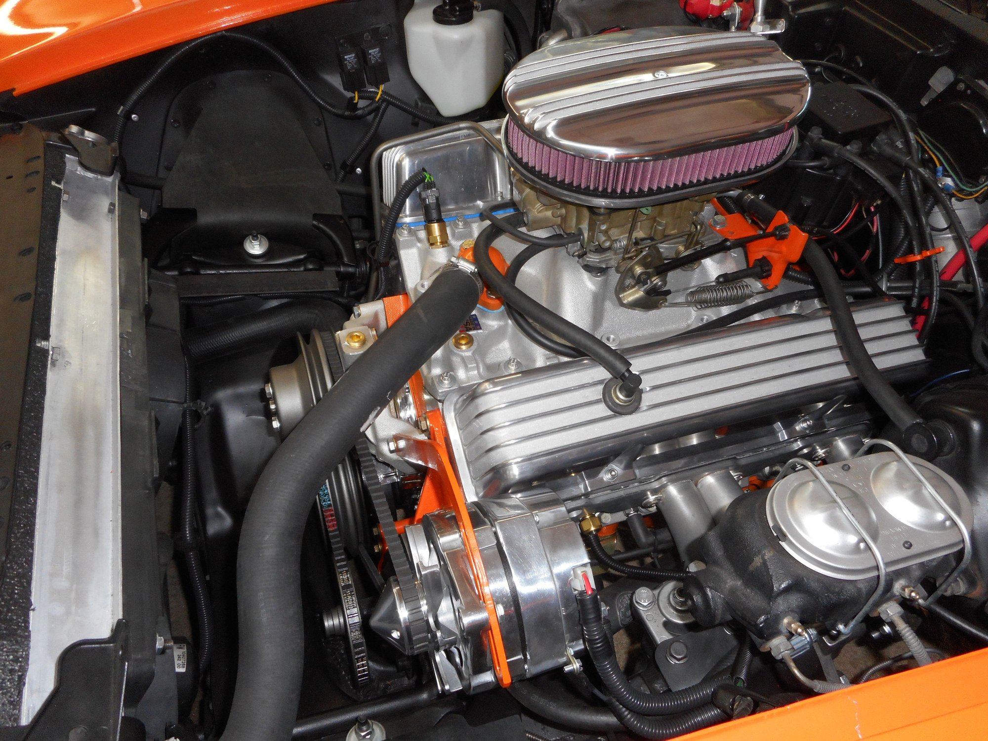

I just put a Crate Blueprint 383 roller engine in my 76. This thing screams ,best bang for my buck .Plug n play.
