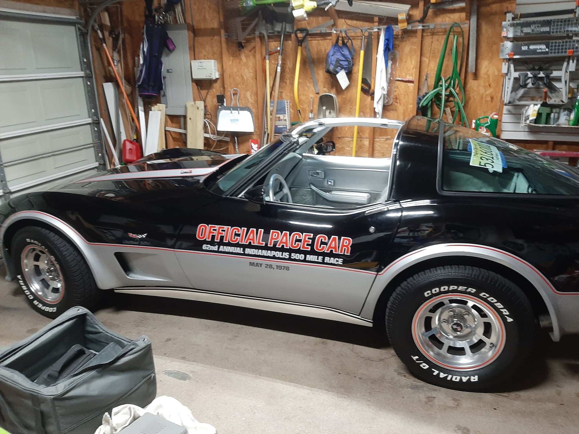

Hi Guys,
i got my first Vette about a month ago..enjoying it. I replaced the rear lenses and now would like to replace the dim headlights. Any recommendations?? Easiest install preferred.
Thanks!
