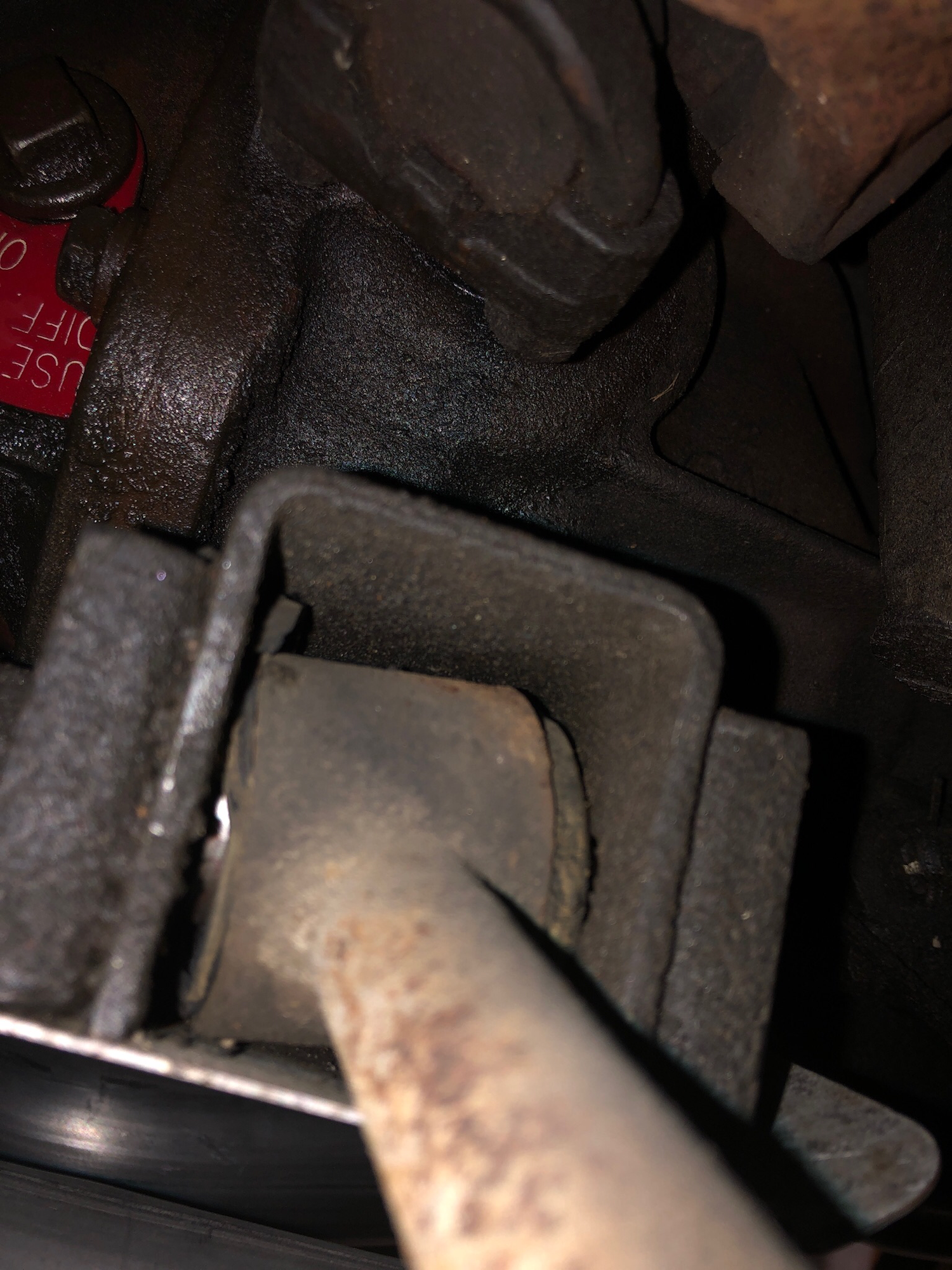

Before i replacedwith poly..ya they look wonky when hanging..even with new bushings..should be fine including spring bushing which pinches funny too..
New bushing will still look wonky til on ground..this is before replacement poly
