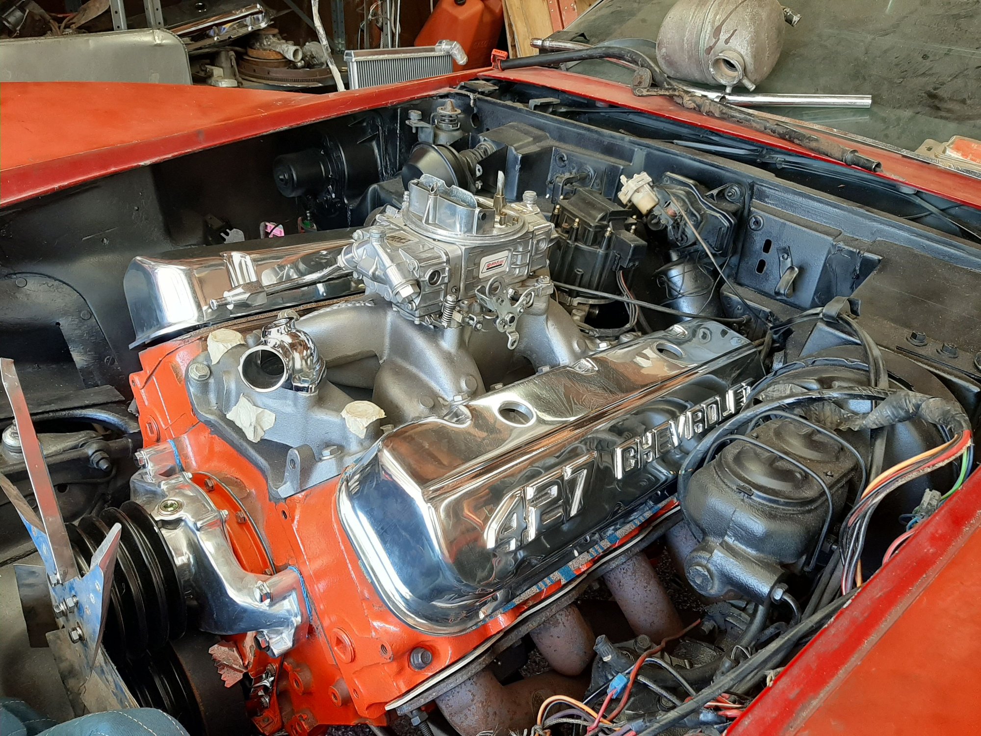

This is my 69 (formerly SB) car. It was a 350 automatic and am staying automatic but went to a 400. Question is, do I need to swap out crossmember to a 400 or aftermarket one or can I just use the 350 one already in it? Secondly, is the driveshaft. I have swapped over to the 400 yoke. Can I use this same shaft lengthwise or is something neccessary to make it work? I was told its fine the way it is. Thought I would ask your thoughts.

Love the BB, but the fan is on backwards!

Trust me I know. I threw it on to see distance into shroud, then noticed it. Good catch lol

I am under the impression all corvettes came with the TH 400 auto. There was no difference in frames except for a manual or auto. The difference was the auto had a removable crossmember.

The only AT for 1969 was the TH400. If your small block had factory AT, you should be good to go with the big block.

Nice upgrade, really miss the thunder of a BB nothing replaces it.

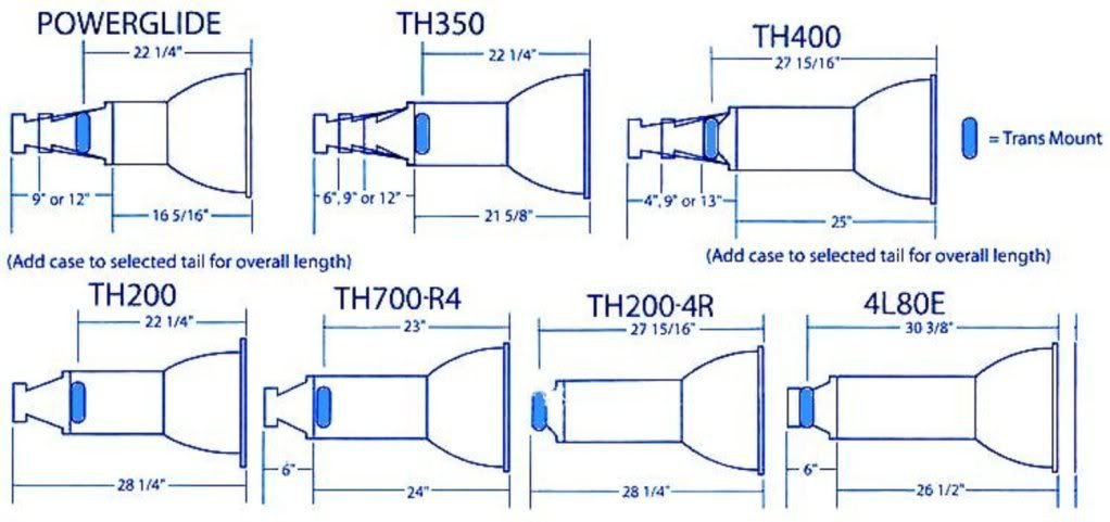

Was there a different tail shaft length for Corvettes and other models?
