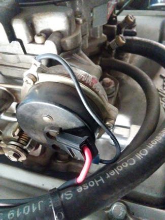

Exact same problem I have with my Edelbrock carb. and choke. Since this is a series circuit, I just made up a resistor link to replace the existing ground connection from the choke to the carb. Starting with a 4.7 ohm 10 watt resistor as this is what I had on hand. Will check the performance as soon as it cools off a bit here in S. CA. Later I will fine tune value, go to a smaller 10 watt resistor size and also sleeve the leads.
Choke Circuit Before Change.
Choke With Resistor Change

Set the choke marker to the center mark but the choke went down to warm idle position within a minute and car was not ready to idle smooth just yet. Moved it almost fully CW and it did seem the fast idle lasted a bit longer and fast idle lever was still engaged. Noticed resistor was getting hot so I will measure voltage across it to see what the power being dissipated is. Next step will be to pull the cap off and see if anything looks out of order or cap is not inserted correctly. Here is the Edelbrock procedure attached for the setup of the choke.
