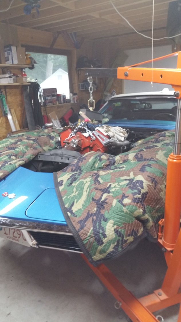

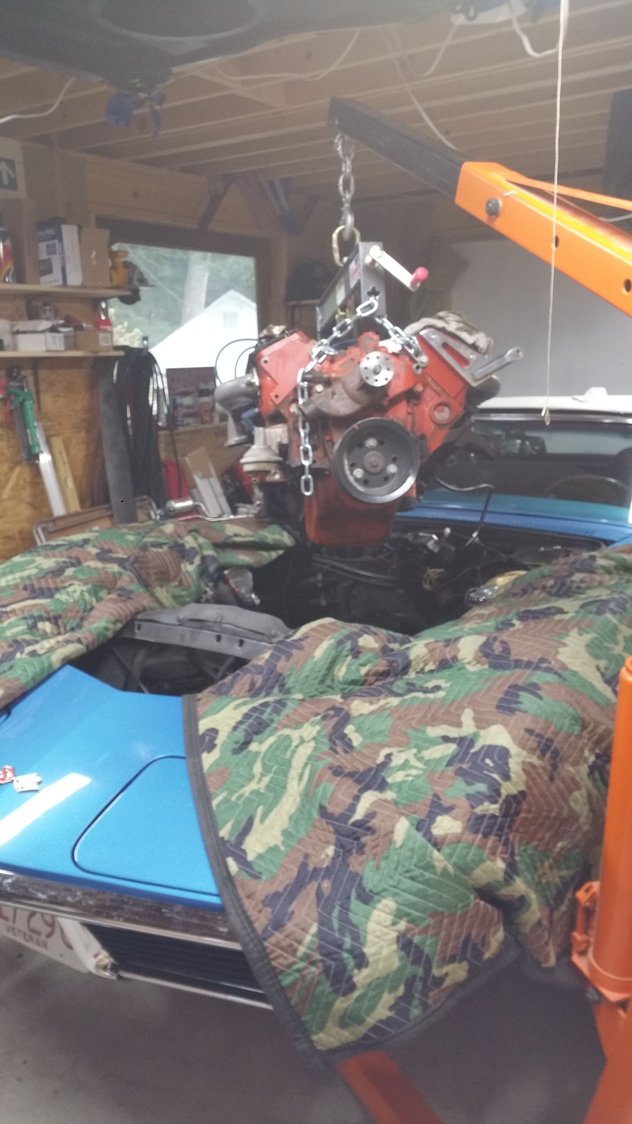

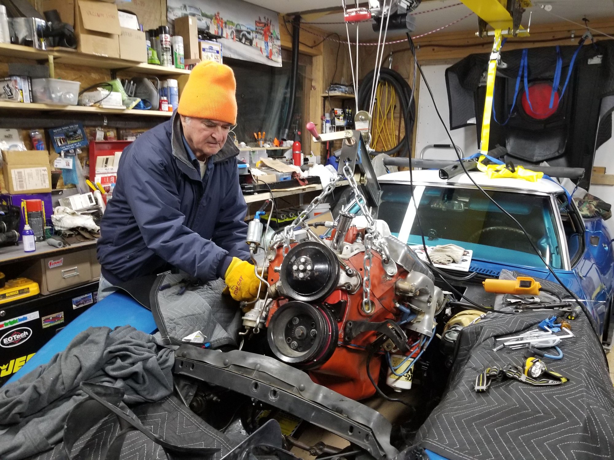

I install them together. I have a my Dad usually help with aligning it and keeping the drivers side and bell housing from crunching, I guide the passenger side and front. I pull the dip stick out because it used to scrape the brake booster. I also use an engine tilter thats attached to both the cylinder heads front and rear. If I had the Hurst shifter I didnt have it installed during the install. I have the hood off and radiator out so I can tilt the front down far enough to get the tail housing over the cross member easy. If your crossmember is removable is so much easier its ridiculous. when I had to use an engine crane I had the drivers side on jacks, the front tire off and extra support in case I knocked a jack stand with the crane. I wrapped the crap out of the fender and the crane because I had the car and crane shift once and dinged the fender right where the previous oener had crunched it. I always wondered hoe it happened, now i know...
Now I have a gantry crane and it 100 times easier and less nerve racking than the engine cranes.
coming out engine only on crane

going in with gantry
