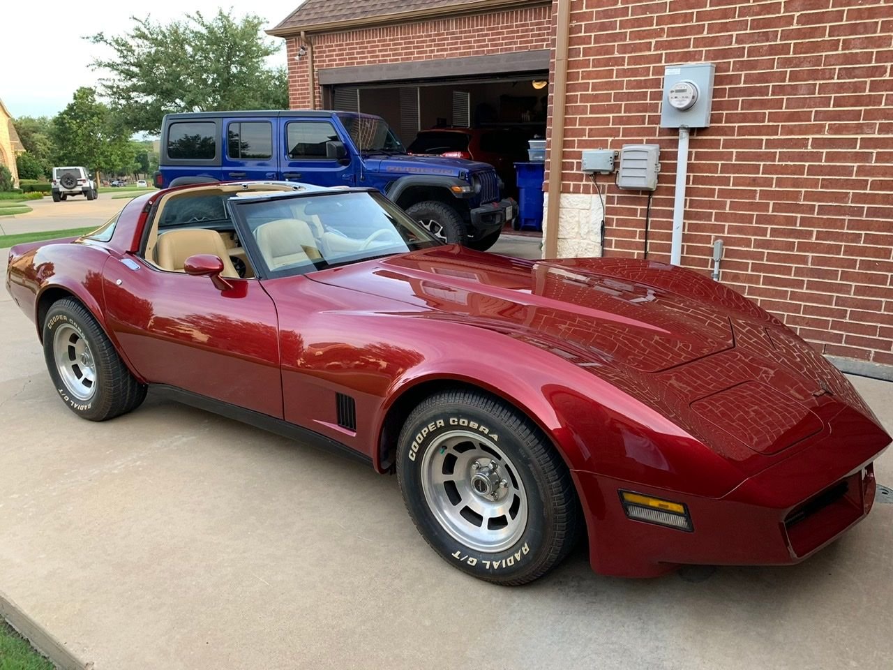

Hey guys and gals, I was looking for recommendations for upgrading my brake calipers and rotors on my 81. I want to keep my factory wheels but since my calipers need replacing I figured I’d upgrade if I could.

I thought about an 'upgrade' but for a weekend toy, the stock brakes were my choice.
You can't see my rotors or calipers because I have aftermarket wheels, so no one could see powder coated calipers or shiny rotors anyway.

The Wilwoods fit the stock wheel fine.
