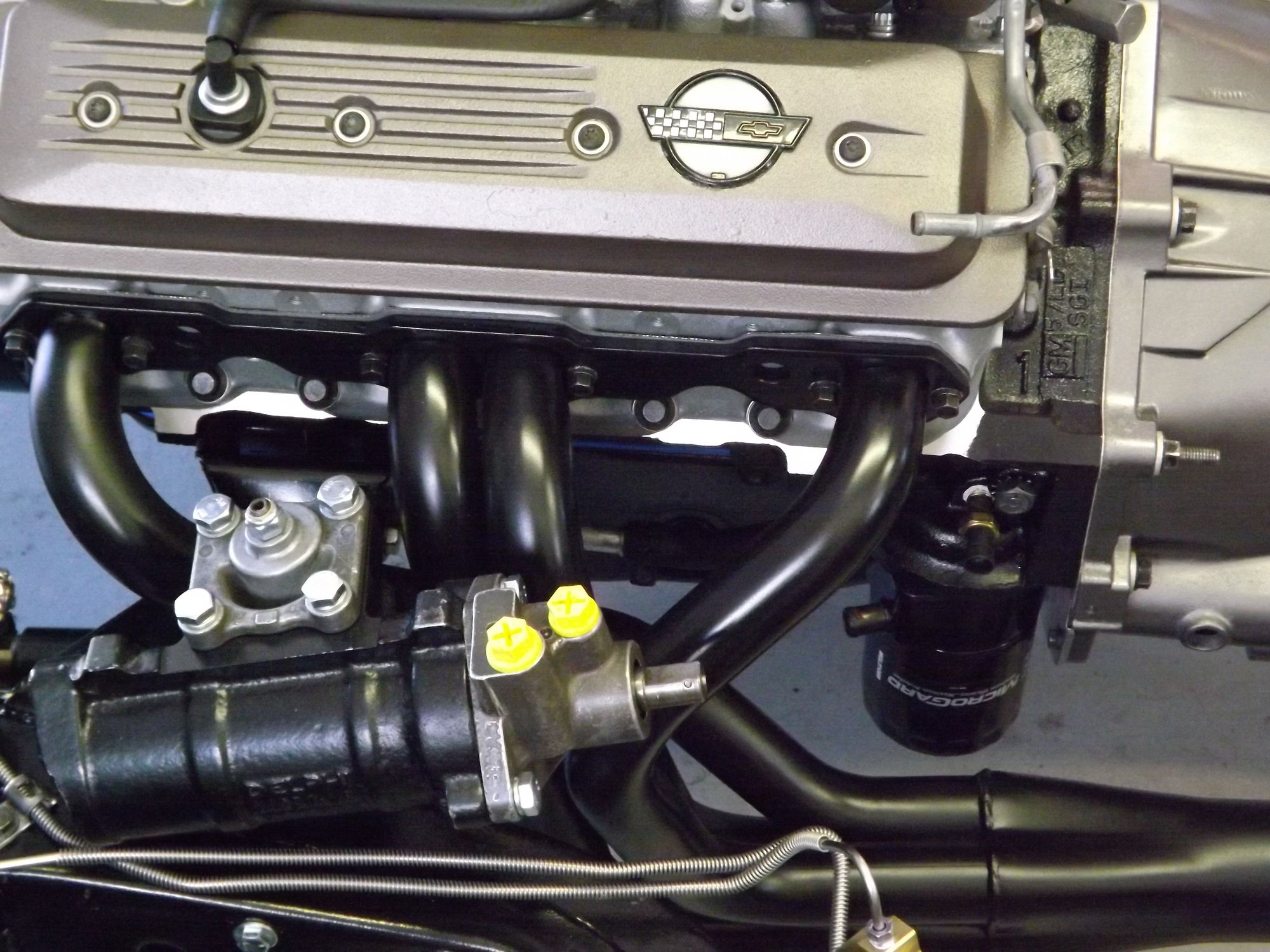

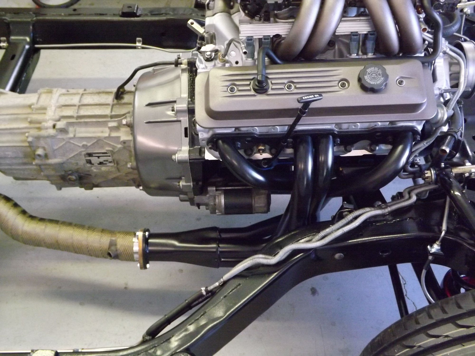

I guess it just depends on which headers you choose. These are Hooker Super Comps and have plenty of room.
